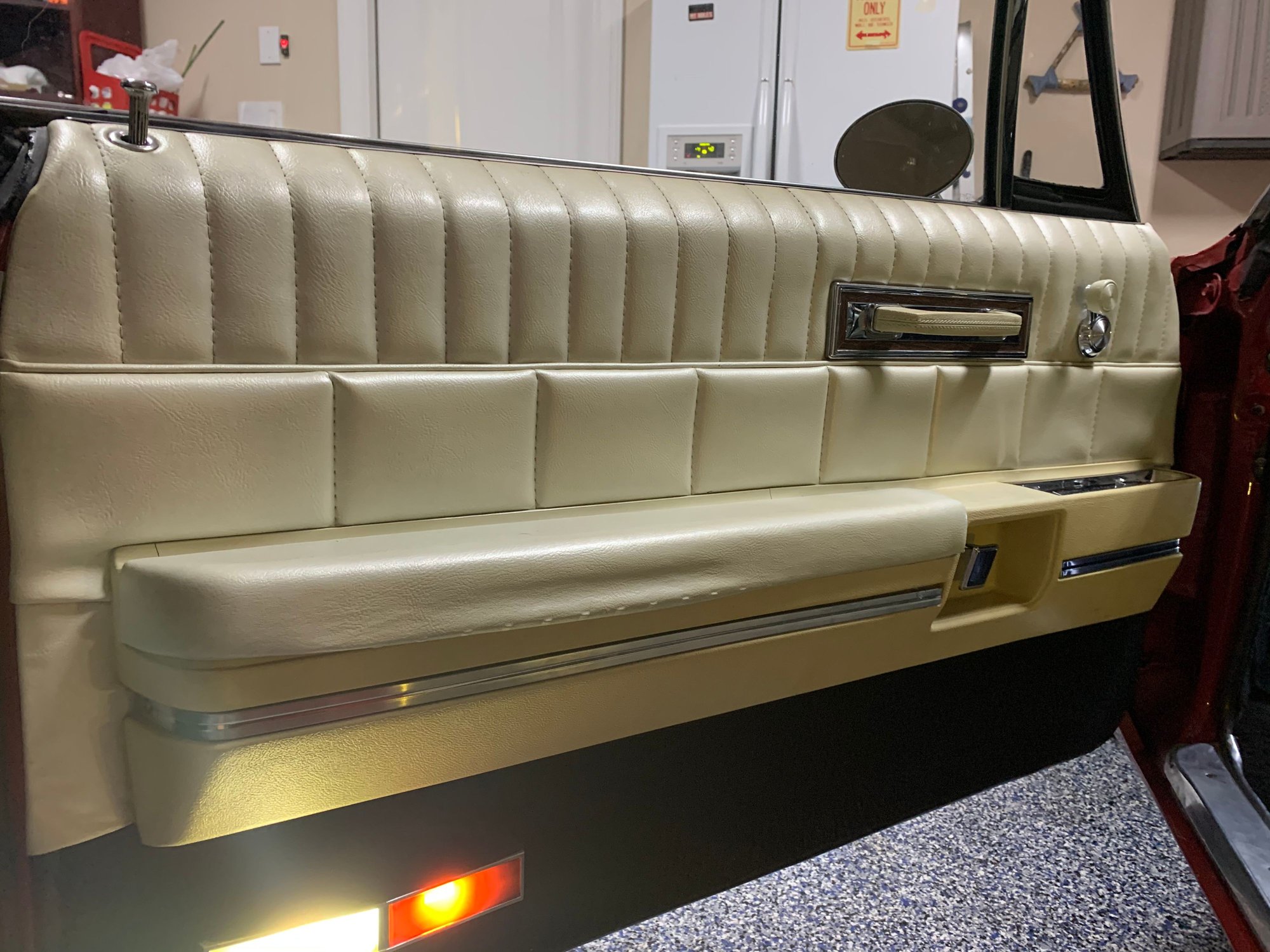

Pictures of the front door (inside view)

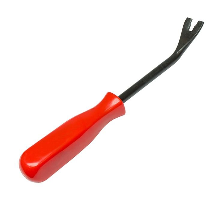

Ah, you still have a vent window crank. You'll need this tool to release that crank from the shaft.

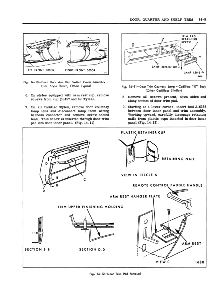

After that, you need to find all the phillips head screws holding the door panel on. There are 4-5 hidden in the carpet at the bottom, along with a number of them sprinkled around the arm rest and the pull handle. The Fisher Body Manual will guide you. This is an example page from the 1967 FBM.

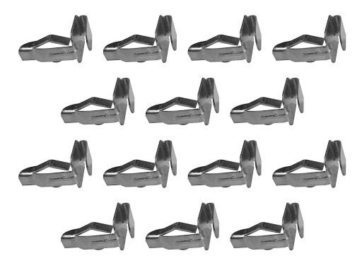

I'm not sure if your 68 used the nail style retainers or the formed clips like this:
I've never had a problem with this style, but I have had some of the nail style retainers come apart. In either case, replacements are available. Your biggest problem is that you need to very carefully pull the door panel away from the shell to separate those retainers. It's easy to tear the cardboard where the retainer clips in. Use one of the trim separator tools if possible.

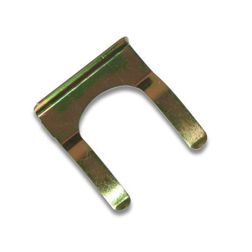

The door lock is held to the door skin with a flat U-shaped retainer that slides in on the backside. I use a channel lock pliers to pull it out.
