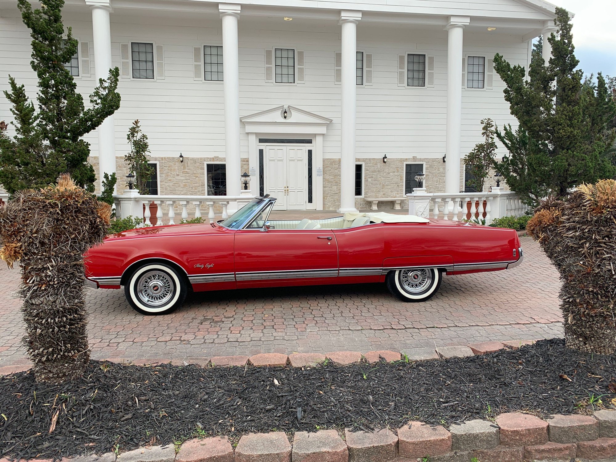

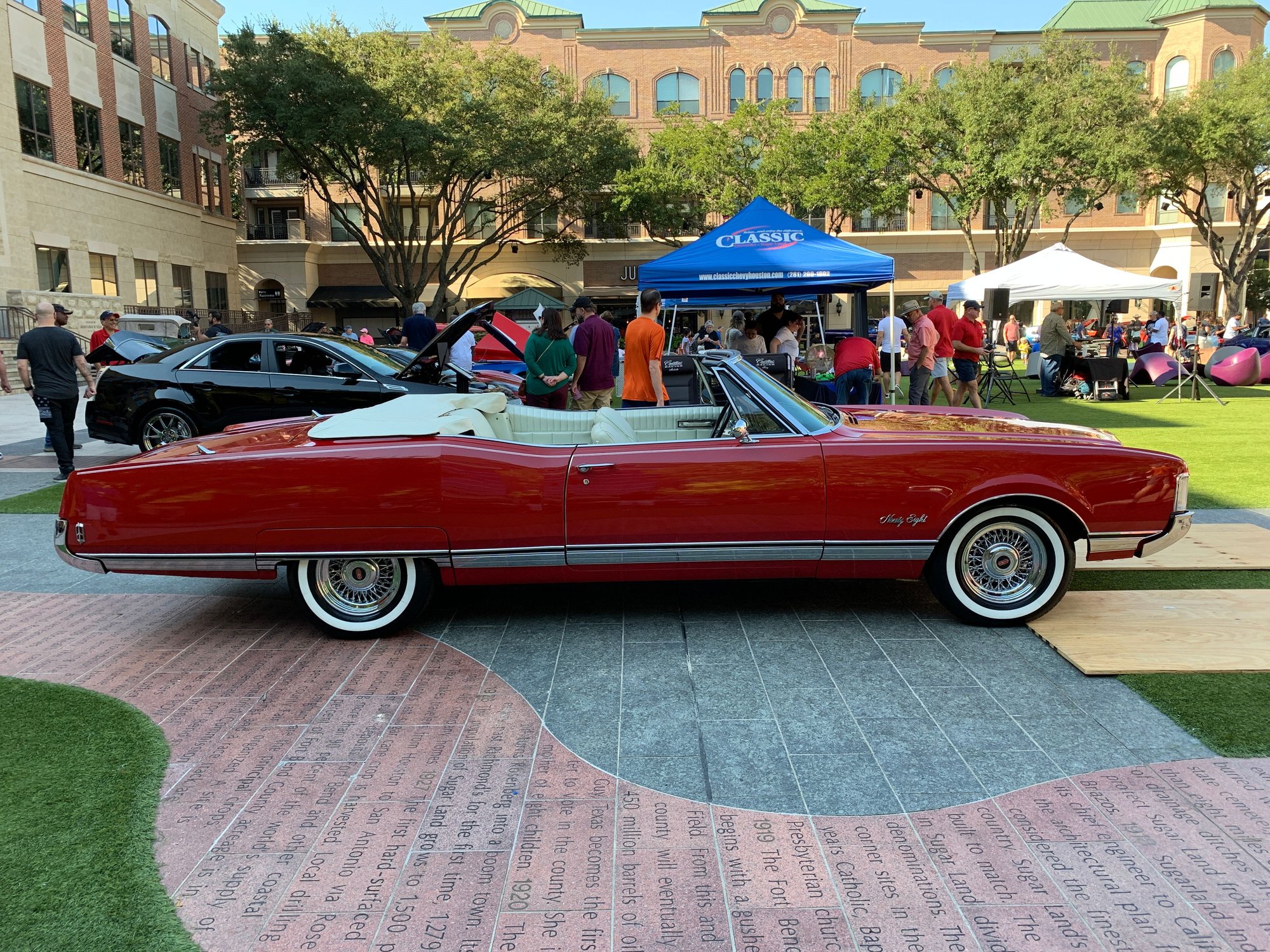

Car pictures
Car displayed at the Houston Autorama last Nov

Very nice ! ! !

Beautiful!

BTW, did you get those wheels from TrueSpoke? They are bad@$$!

Those wheels are from TrueSpoke. I ordered them in Aug 2021 and they shipped it in March 2022.
