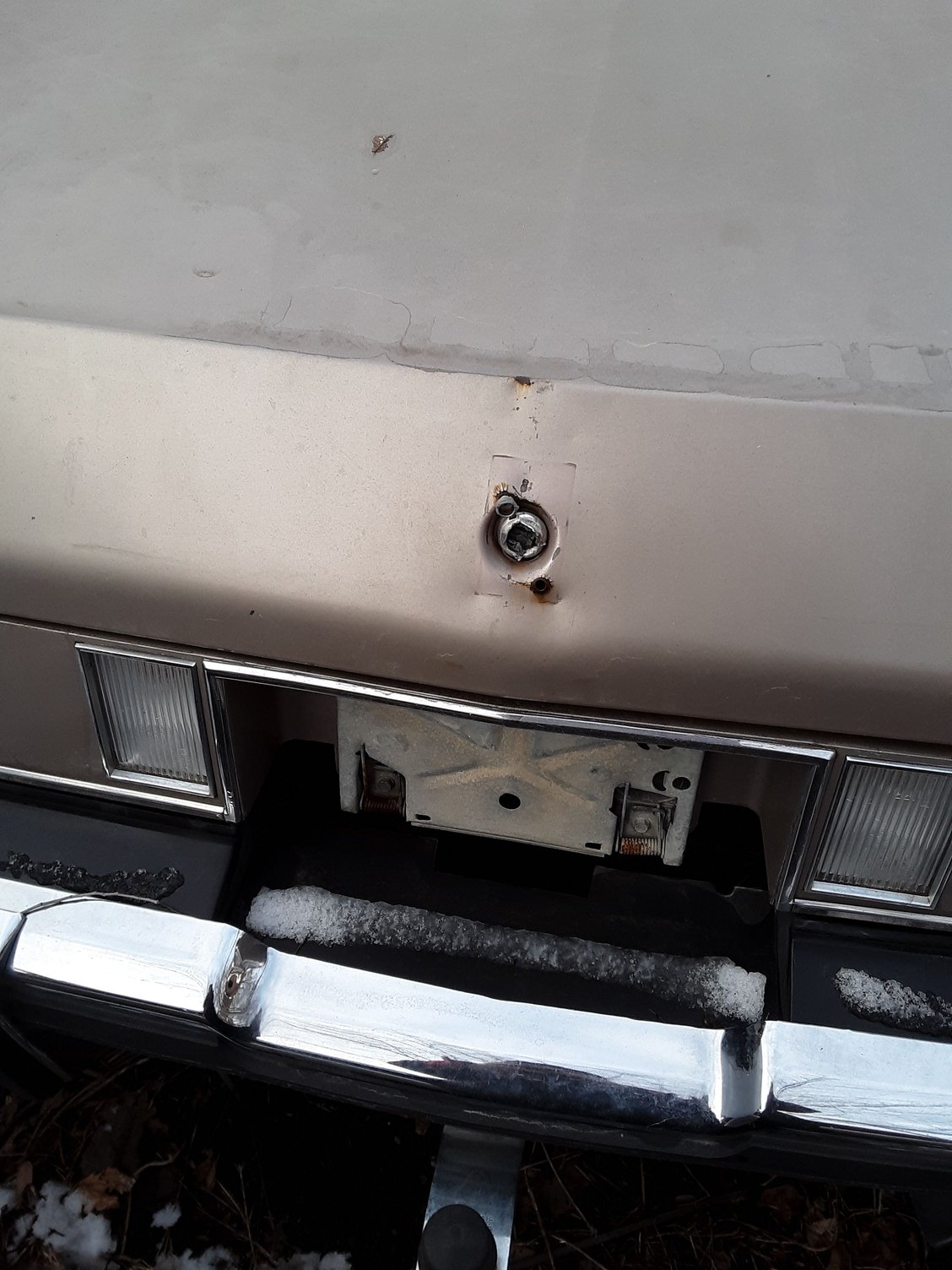

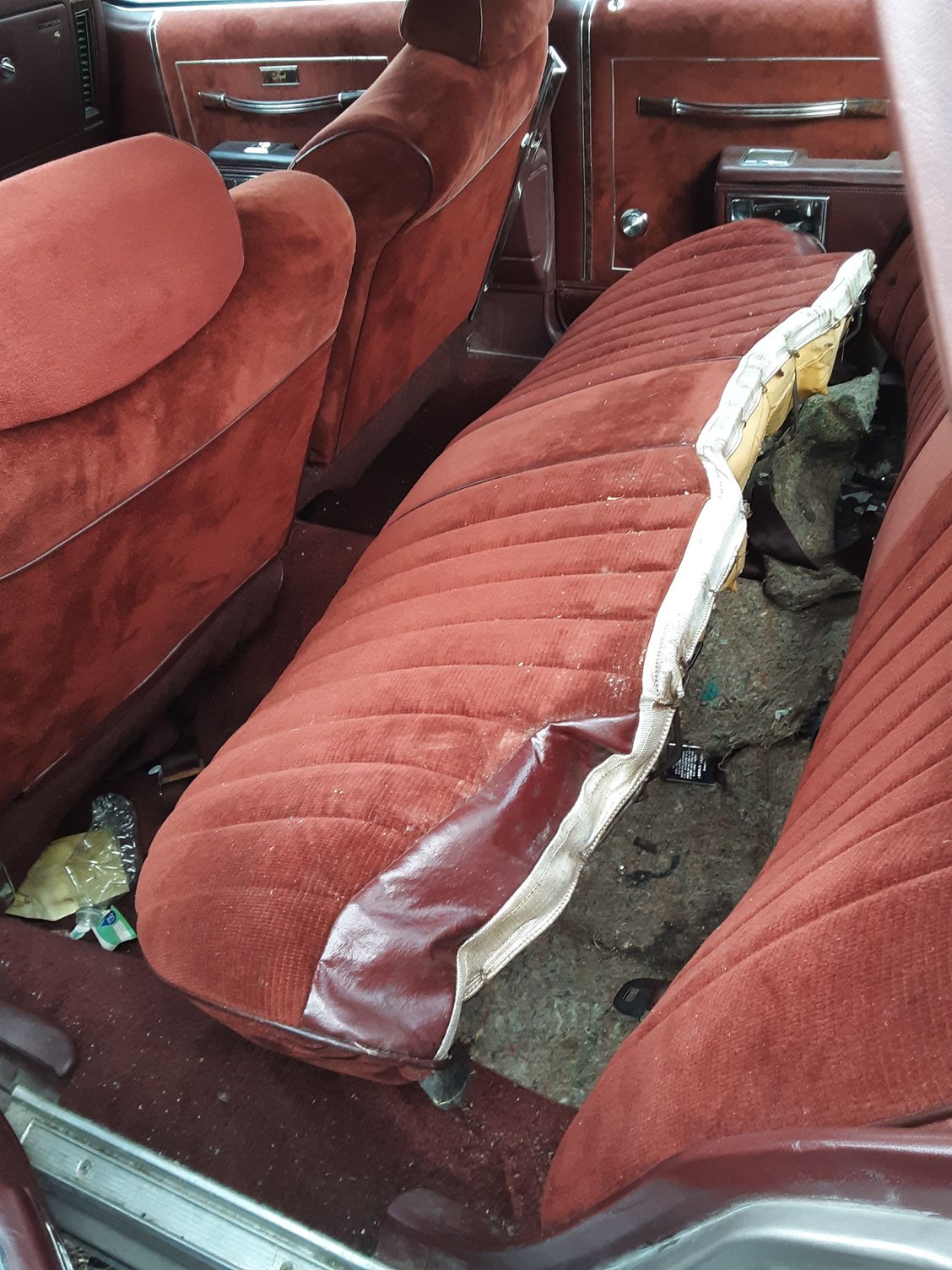

Sorry for the huge images.. But I wondered how difficult/expensive it might be to install the back seat and a new truck lock. Also the hood latch on the inside is a set of locking pliers (but I saw the pull latch on the floor).

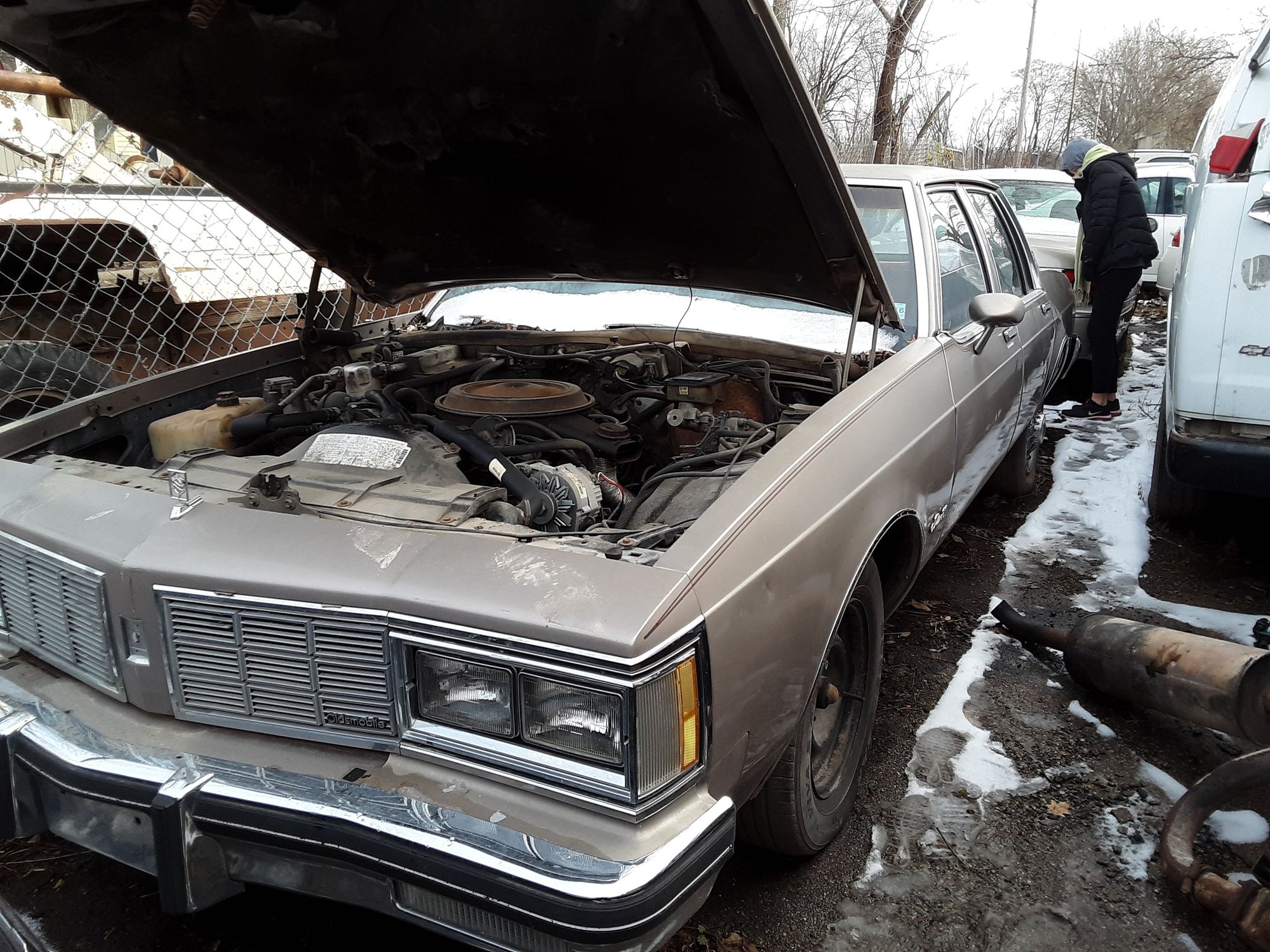

The pics look like it is an early 80s B-body Delta 88. To reinstall the rear seat just pop it back into place. The bottom of the rear seat latches onto the floor pan by pushing it down and back. To repair the trunk lock find a salvage car and take the trunk lock cylinder and keys from it.

Or maybe just take the whole trunk lid and replace it. The existing lid is damaged around the lock cylinder. The replacement lid would likely have to be painted to match, but the existing lid would probably have to be repainted as well once the dents were worked out of it.

I was hoping the seat would be easy, that's great to hear. I was hoping the trunk key would be like a house door **** replace.. guess not. If I pop on this I will definitely look into a salvage lock and key. Thanks!

Keep in mind that you would not be getting a new trunk lid. Those don't exist. You would be getting from a junkyard car a used one that is in better shape than yours. I have no idea, but I would think that such a thing might be had for $50 or something in that ballpark, which isn't going to break the bank. Keep in mind that there's a reason that these cars are not supported in the aftermarket. No one collects them! But that cuts both ways. There's not a lot of availability, but there's not a lot of demand, either. So anyone who's got something to sell for one will be glad to have any buyer at all and would probably sell for reasonable prices.

I get nervous with any car over about 125,000 miles. They get mostly used up beyond that millage. I didn't see much rust but the pictures were lacking where rust would hide. Be advised cost goes up substantially when rust is involved. If mine or about to be mine I would see if it will start, move forward and back and some what stop. Remember there was a reason it was parked in the first place. It would be good to know that if you can before you make the payment thing. It cost nothing to walk away, big bucks if you get to excited and make a mistake.
