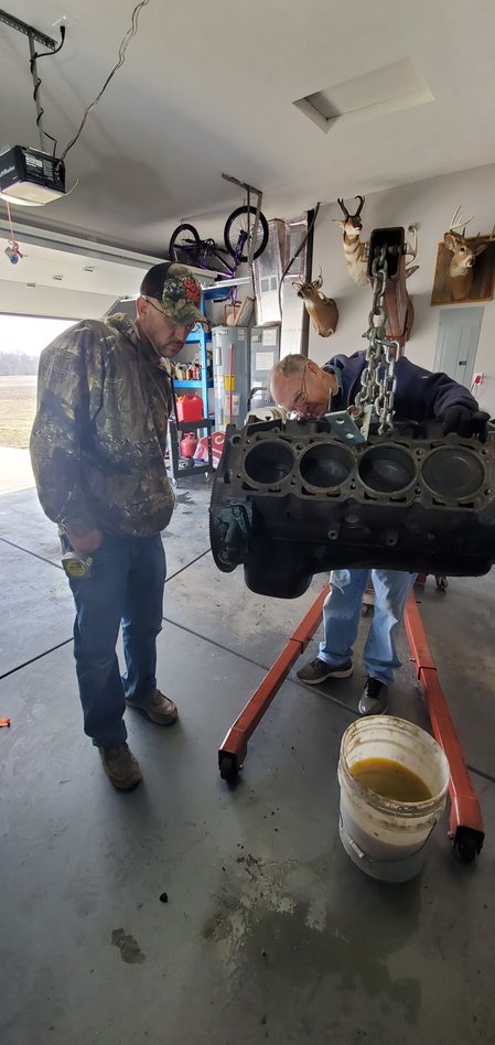

Good evening to all. This is the first time I've ever been on a forum so excuse me if I don't do something correctly. I sold a 66 coupe deville a year ago because I wanted a convertible of some kind. After deciding I didn't want to spend $30k or more on a car that I would hate to drive in fear of getting a scratch I decided to buy my late Uncles 1975 Delta 88 convertible from my Aunt. She was going to sell it to a friend of my cousins but when she found out I was interested she told him "family first". He wasn't to heartbroken. It had its usual issues from.sitting for three years but I go it running good. It has 83000 miles on its original 350. The problem was it leaked oil enough where it was blowing on the front driverside tire and throwing it off balance. So about three months ago I bought some #6 heads and pulled the engine. I dropped it off at a shop to have new bearings, mild cam and flat top pistons put in. Hopefully by next winter it will be ready for the paint shop. Sorry of this post is to long but I'm excited about my new ride.
Baskin in the sun
A little POR
My Dad and little brother acting like they know something about engines.

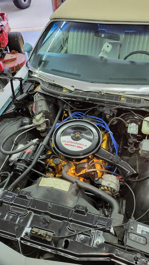

Running g again

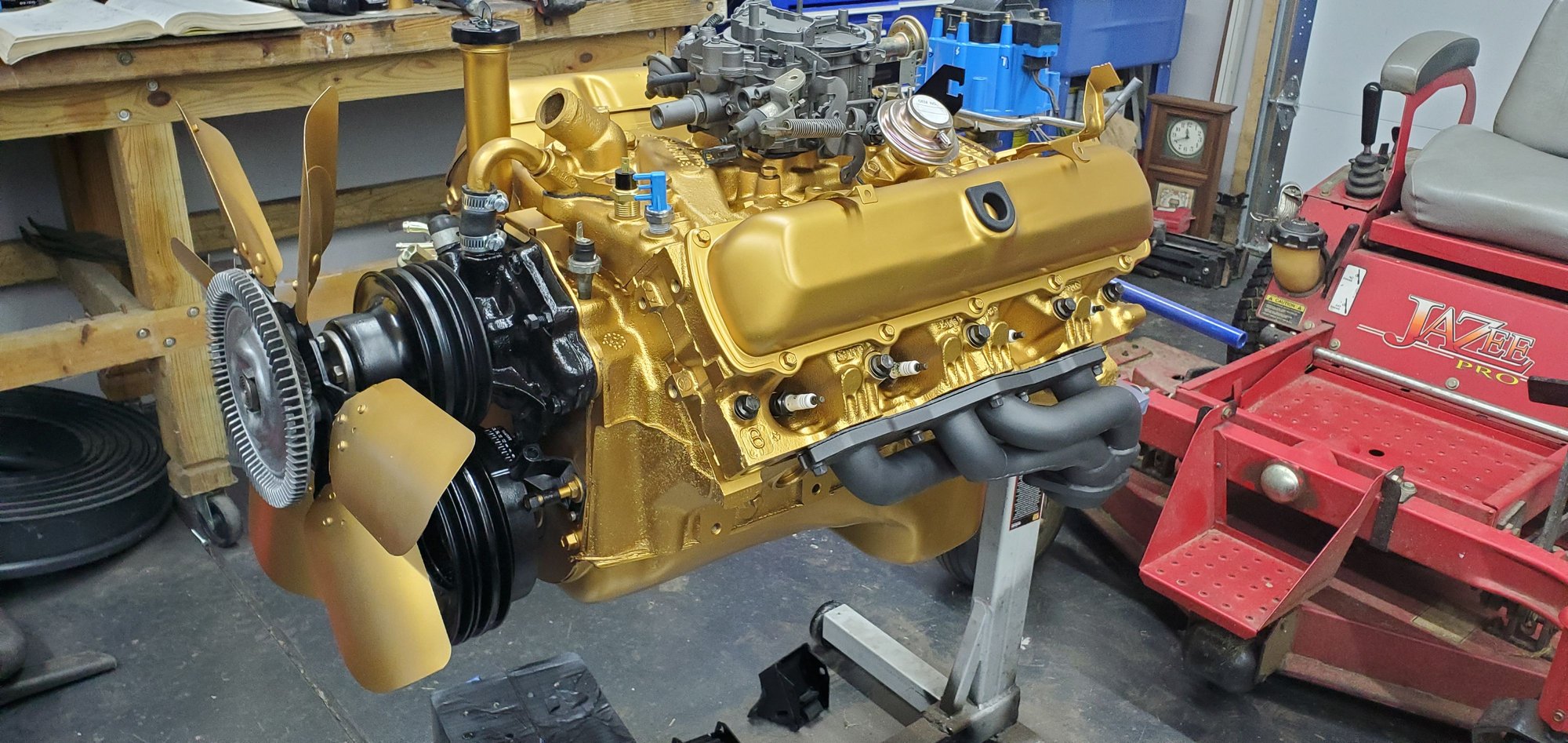

I sent my 350 in back In March to be rebuilt. Bored .30 over, #6 heads redone, a little above stock cam, and shorty headers with duals. Just broke it in today. Sounds good.

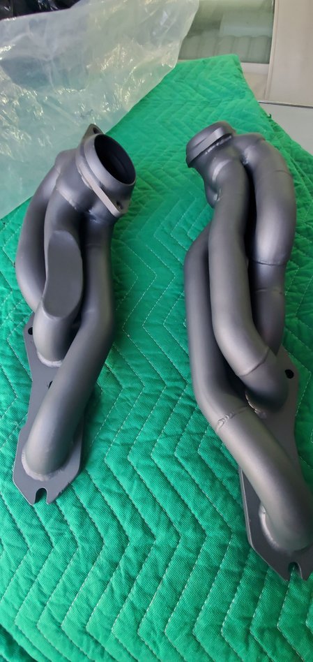

Hi all, also new to the site and have been snooping around trying to find what headers you guys are using for the 350. The search function just overloads with so much info, kinda overwhelming.

The Thornton shorty headers seem to work well in the 70s big cars.

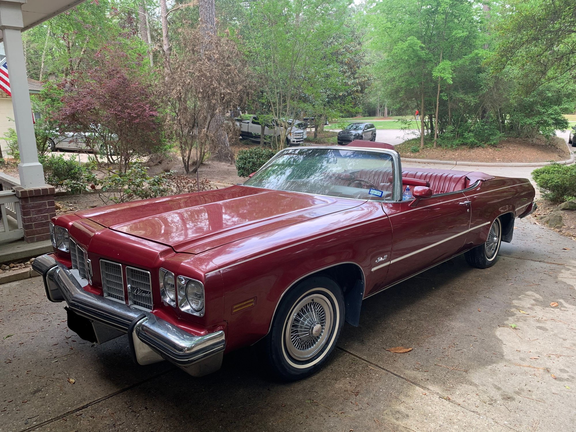

Red 75. Check the build date on the data plate underhood. The last Olds convertible was a red/white 75 with 7C build date.
Or was until the W-body Cutlass Supreme converts appeared in 90s.

I used the Thontons on mine and they fitt perfectly. They ceramic coated them for $150. I had no clearance issues. The dipstick slid between the head and headers with no problem and the header cleared the starter. Total cost with ceramic coat was $650. I think they have gone up a little in price in the last two months.

yea, thats exactly what I'm looking for. Not really looking for an increase in power, just a complete system from block to exhaust and I think these will do nicely. Being made especially for these engines and clearance is def a plus.

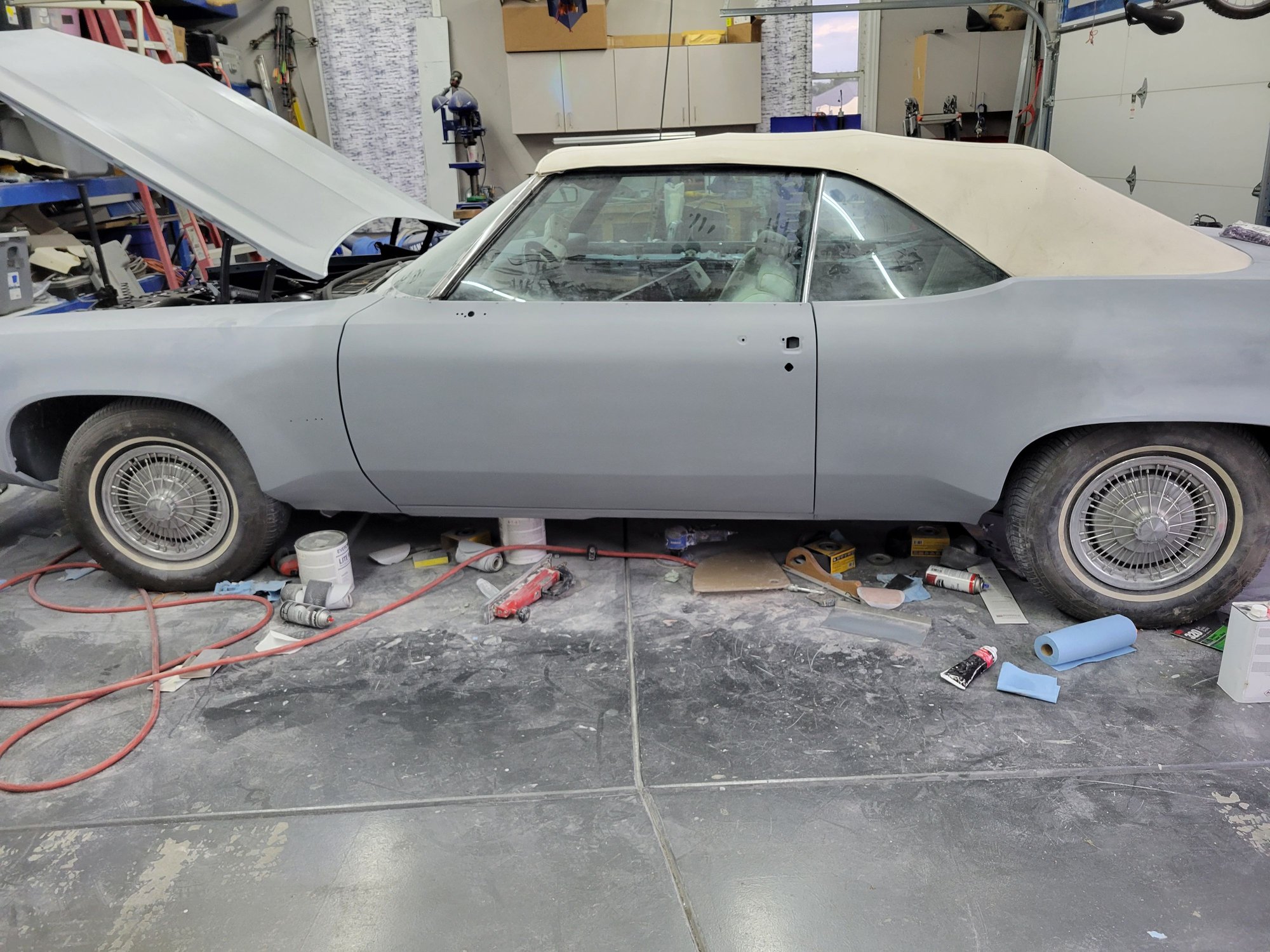

Long road

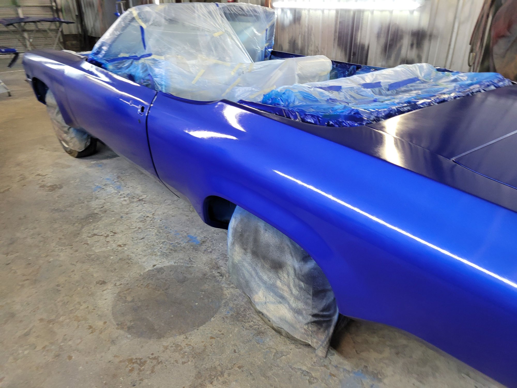

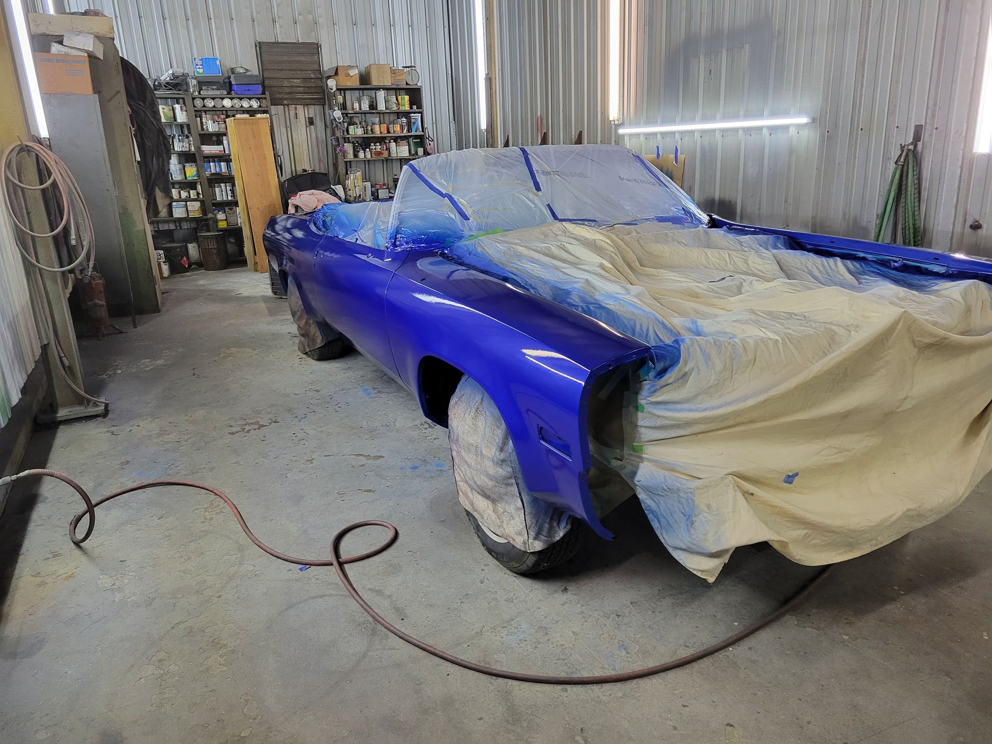

It runs but I need to replace the intake gasket. I have antifreeze seeping between the head and intake on the passenger side. I also have oil puddling up on top of a couple pistons. Also she bucks and hiccups when I punch the accelerator.
As far as the paint I just need to buff it a little. Not bad for a first time painting a car.
