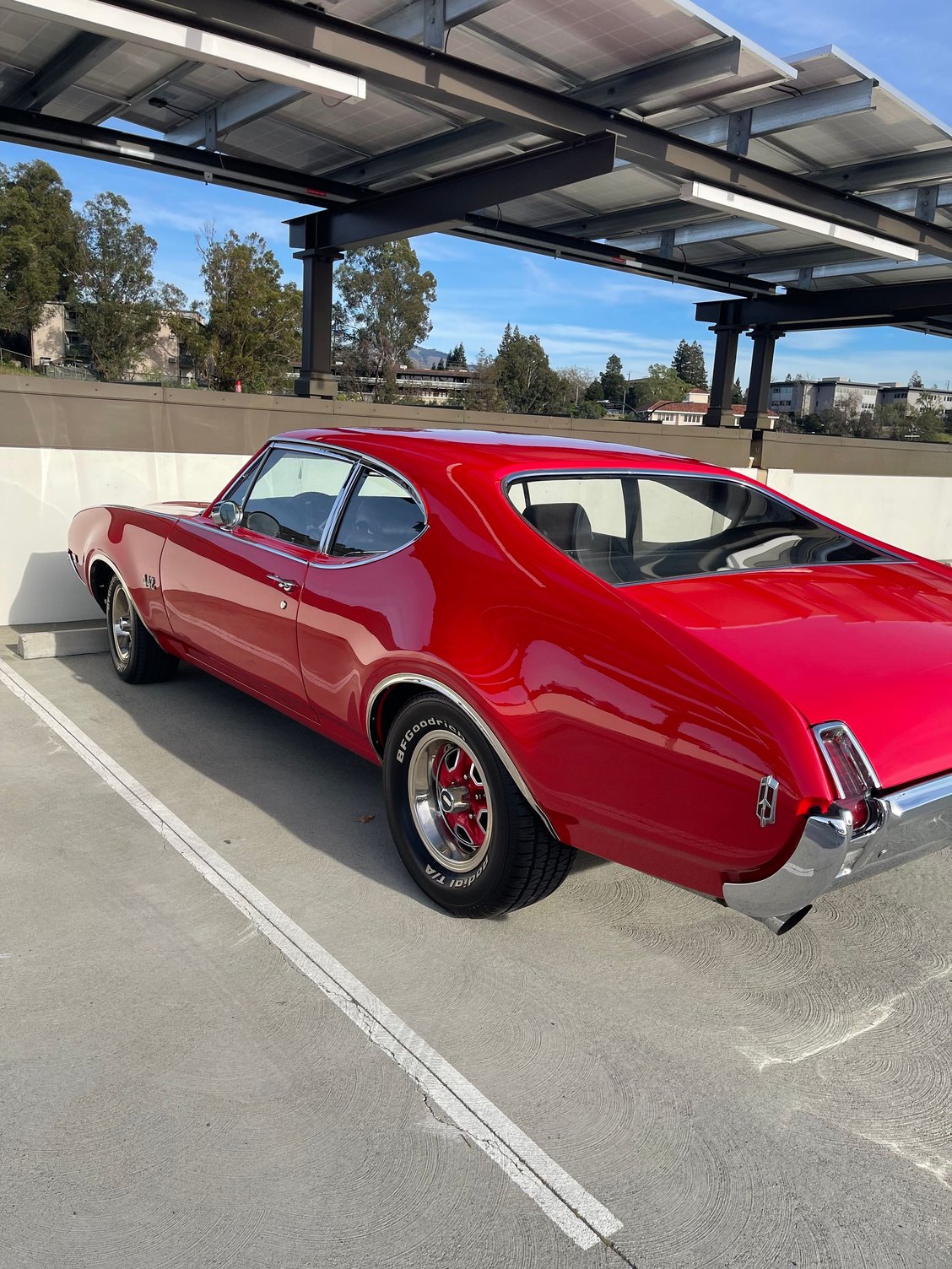

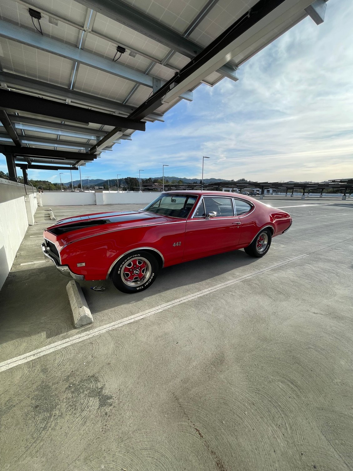

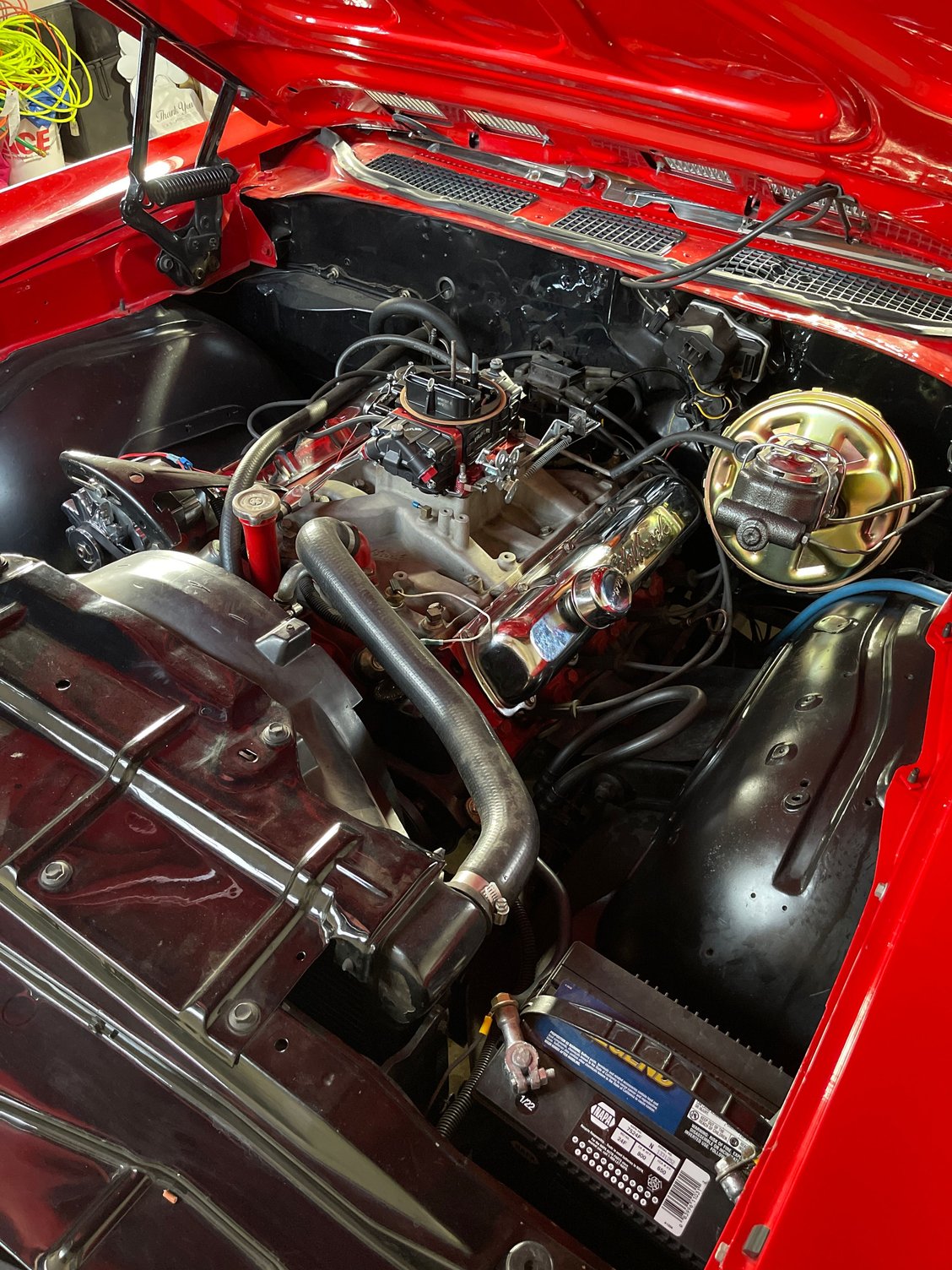

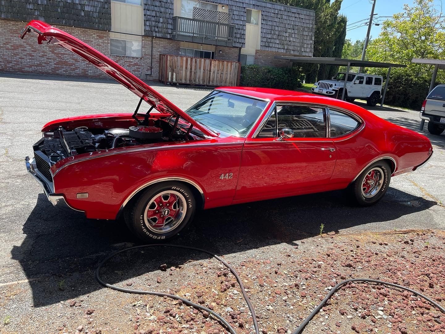

Learning how to wrench with my 69 442
So happy to finally own my own muscle car after wanting once since I was a little girl and watched my dad work on them. i bought her last spring and she’s a beauty but definitely has some issues under the hood I’ve been slowly diagnosing and fixing with the help of books and YouTube lol
She started out with a parasitic draw on the battery that I isolated to the alternator and replaced that. The steering box was leaking so that was a quick rebuild, and then she also needed an engine fan so the radiator wouldn’t over heat. Someone had put a 800CFM double pumper on her and it was not dialed in or the right size, so after tinkering and a rebuild i decided to swap it out for a Holley 680 street brawler and it’s running better. I replaced the drum brakes along with a new booster and maser cylinder since it was leaking, but still want to eventually do a drum to disk conversion.
she has a 455 engine and haven’t checked to see if it’s matching numbers or not but I doubt it since so much has been tinkered with and replaced before I got her.
my current issues is the timing is off and she needs a better distributor. I am also starting to think someone replaced the cam shaft and hope that’s not where the timing issues lie, but we’ll see. This is all new to me and I’m learning as I go, figuring it out based on what’s not working haha

Welcome to Classic Oldsmobile. Your car looks clean. Looks great. People are very good here with helping with sorting out problems. I say keep posting up your questions.
As far as looking for numbers matching. The 69 442 came with a 400 not a 455. Very common swap. If you post a picture of the cylinder head there is a letter on the front left on the driver's side. That may help identify possibly what 455 you have. You could always post a picture of the body/cowl tag also to help identify how your car came new. That is located on the top side of the firewall right in front of the vin on the driver's side. Again welcome. Red on red is a good combo. 👍

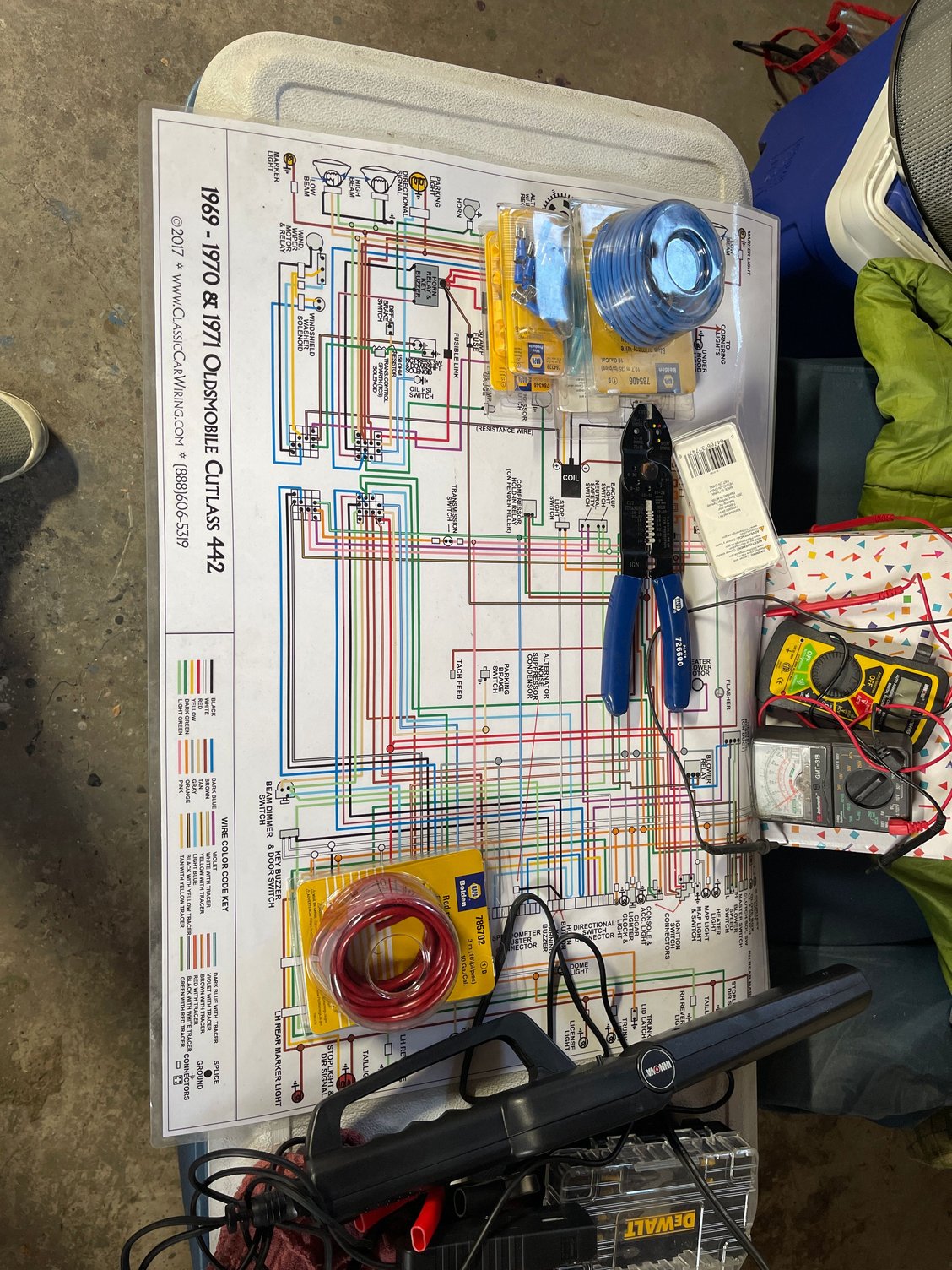

Oh yes I bought up all the service manuals i could get my hands on including a wiring print out in color!

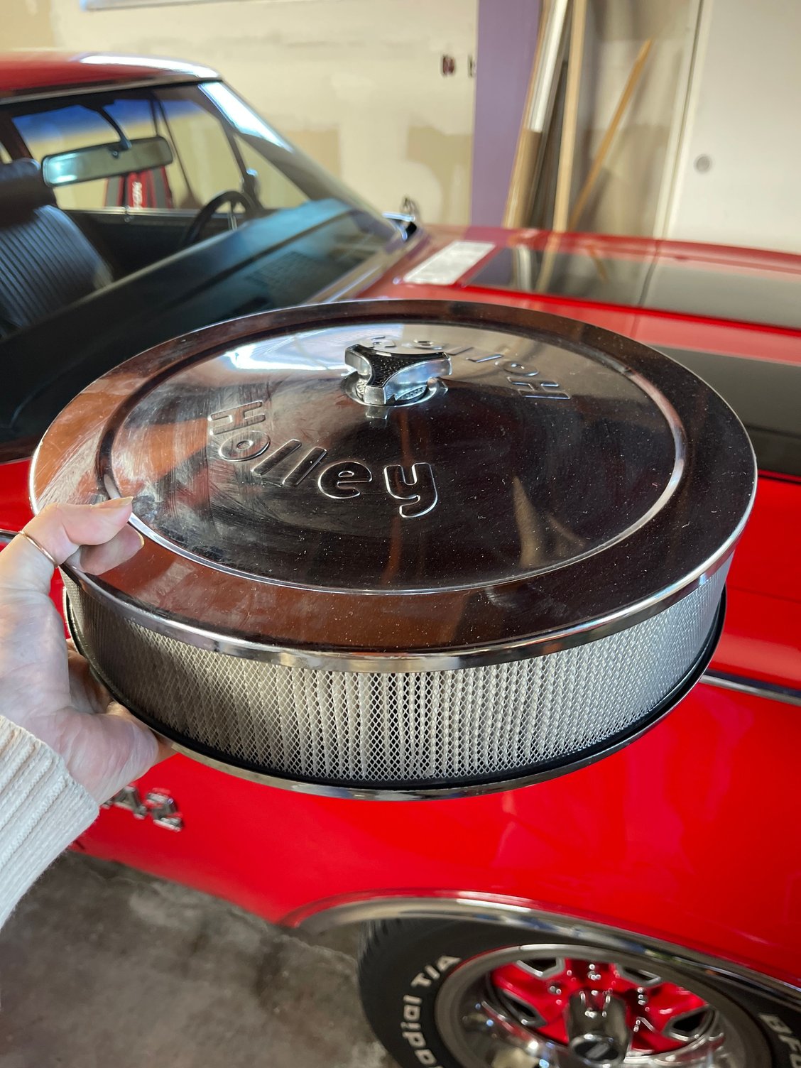

I have a filter for the top of the carb just had it off at the moment since I’m not driving her till I get the timing fixed.

Welcome! Beautiful and the car too. Very clean! Always a good way to start. Red paint looks deep.and chrome is great looking!. I like the black stripes on the hood. Most members on here have a wealth of knowledge. And are willing to help. Drum to disk conversion is great to have especially if you have a little bit of a lead foot Just remember, if you do not already know. The disk need to fit inside those really nice rims.
Do you know how long ago the car was painted and engine were rebuilt?

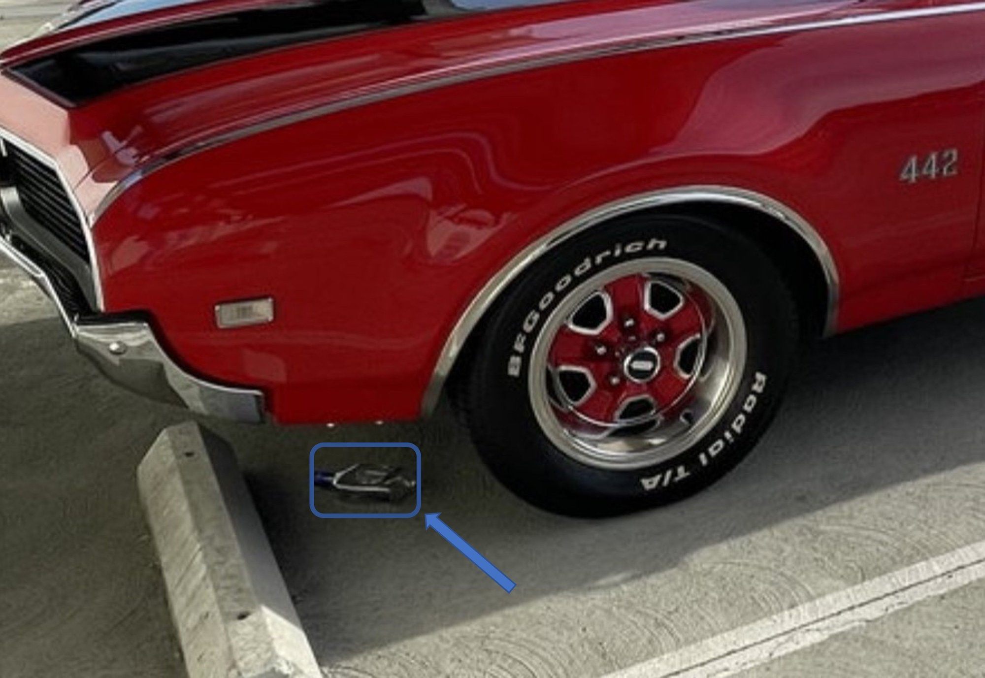

I've been curious since Day 1 (your 1st post) - what is that thing under your car?

Be cautious using that wiring diagram you ordered. I bought one for my '71 convertible from that company, as well as ordered reprints of the factory service manuals. The wiring diagram in the plastic was 99 percent correct but a few things did not match the car. You will find an accurate color diagram in the service manual, I believe, if it's the same as 1971 manuals. I blew up a copy form my book, & use that one now. My factory service manual reprints came in 2 books as opposed to the one original manual. I ordered them before the car was delivered, & it had an original 1 book manual in the trunk. I discovered they are the same thing exactly. Only in 2 books, as yours appear to be. Have fun w/ your car.

Haha it’s a bottle I think? Idk it was a parking lot so who knows! I am over 2 years sober myself so definitely not from me 😂
yeah I noticed in the wiring that it was different from the one in the service manual so will refer to both… plus since others have had hands in it I really can’t trust anything 😅

Might be a semi-smashed 1 quart plastic oil jug... Welcome Randi- very nice car!
