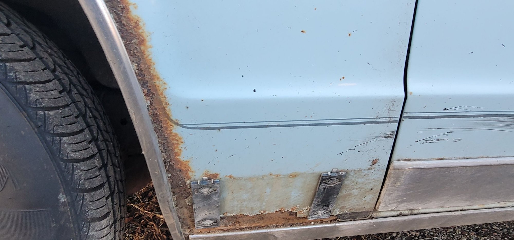

It's got some surface rust. Anyone think this paint job is salvageable, or is a repainting required in the near future? Also, the vinyl top will need to go, so replace it or convert it to a hardtop?
It does have some surface rust elsewhere. I assume I can use CLR for most of that, although the fender might be needing a blowtorch. I do think the body work, particularly the frame, will need a professional touch. Does anyone know any good shops in the Portland area for this? The guys that specialize in classics are booked out for years (and many of them tend to want to take over the project which isn't what's needed). I talked briefly with Sherwood Autobody, are they any good?

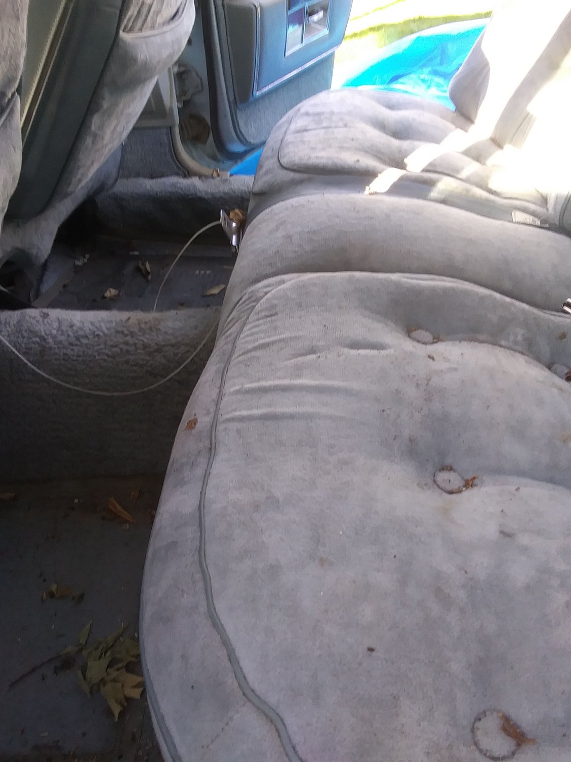

After it's been sitting for several weeks because of traveling and overtime at my day job I finally had a chance to so a little bit with it and get a feel for things.
I'm pretty sure this was a wasp nest of some kind in the door jamb.

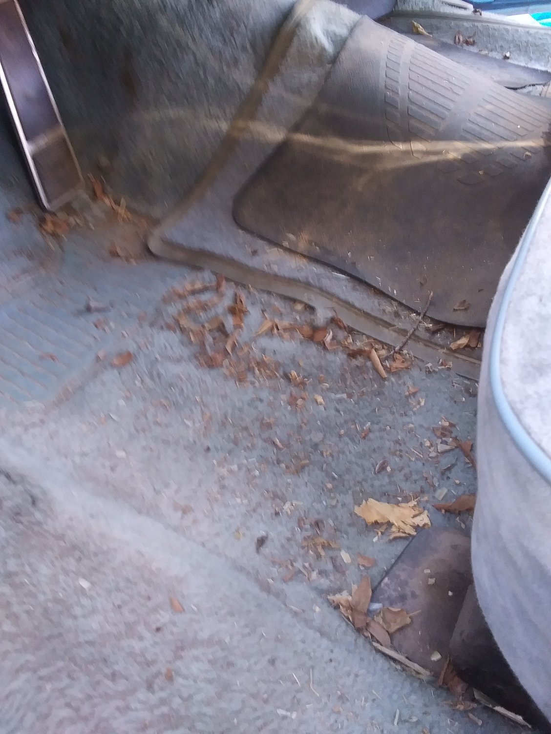

The inside was super dirty, like it has been sitting under a tree with the window open for years. There was so much tree debris in there.
Anyone know what that white plastic wire thing goes to? It attaches to something under the front seats.
The front seats were just as bad. I cleaned it all with carpet cleaner but I'll have to hit it again as the can was running out and there wasn't enough left.

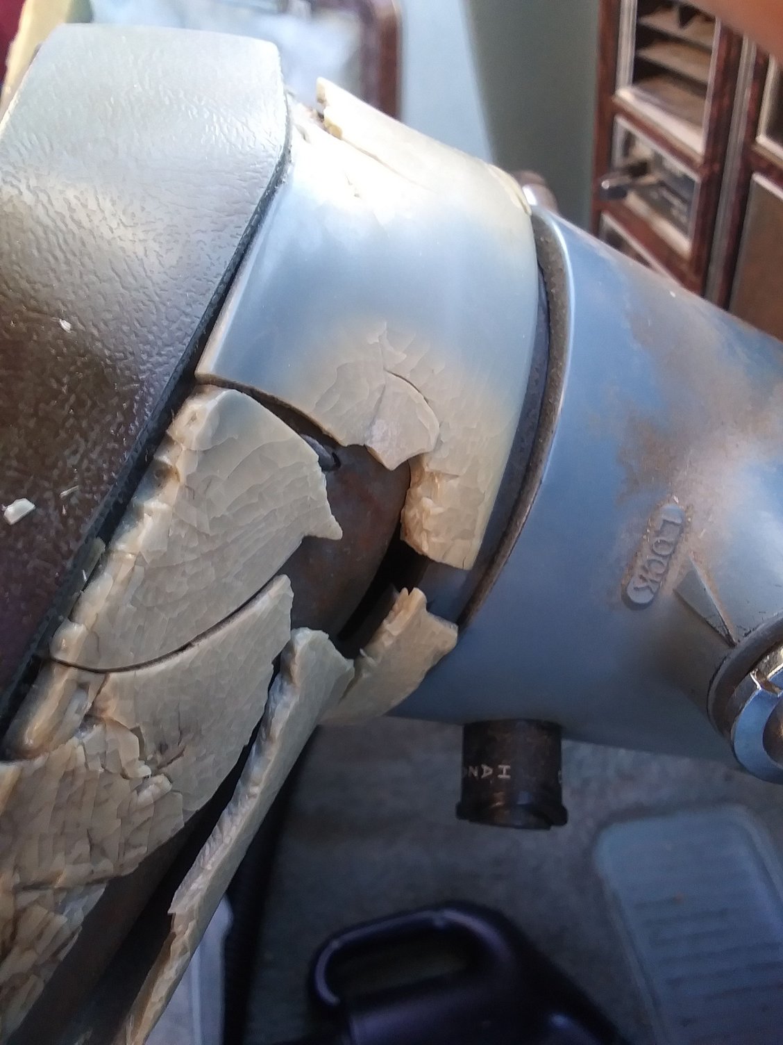

This steering wheel is a total disaster though. It's still usable in its current state at least but I'm thinking it needs a professional touch, though it won't be cheap. It's really unfortunate these aren't made anymore......
There was something very, very off about the driver's side seat. The power switch bezel was totally unscrewed from whatever it was supposed to be connected with and it shifted around a fair amount when I sat in it. Have to take a closer look later when I can.
Sadly this is in rough shape and I'm not sure I can fix it myself unless I can re-leather the armrest. The passenger side is cracking as well but not nearly as bad as this. The rear door panels look pretty good.
To stop the leather parts from getting any worse I used Leather New to clean them up a little and also to revitalize the material. I've used it before and it works great, never had an issue. As you can tell by the rag they were sssssooooooo dirty......

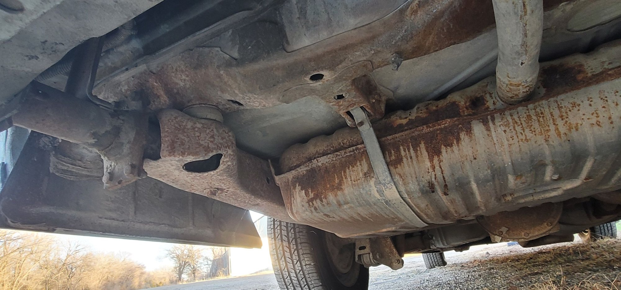

First thing I'd do is set up a budget. With what you're describing along with what the pictures show, your plans could easily have you spending considerably more than that car is worth. Late '70s B-body four-door sedans do not have a lot of intrinsic value.

This car has surface rust plus a lot more. Re-sell or part this one. You can find a many in much better condition. You will save money in the end.

I agree with Tri-Carb. As much as I love the 77-85 B's and 77-84 C's, you just can't save them all.

I think you may find a nightmare around the base of the vinyl top.

Before moving forward OR deciding to not fix the car, do a complete evaluation of the car. Avoid putting a lot of time, money and effort into e.g., an engine rebuild to later find a bad frame, evaluate the entire picture first and go from there.

I think there's a misunderstanding here. I didn't get this car as some kind of financial investment, this is going to be a driving car that I'm going to fix up and try and make it look as nice as I can afford to over time. I got it to use, not to sit. Based on this use case, you can say the same thing about literally any modern commuter car. Every last one of them loses value over time, especially brand new. The difference is, I'll have a car I actually like driving, plus much more importantly I will have learned valuable new skills that can be applied to keeping it on the road and who knows for what else. We live in an era where a leaky tail light can literally disable your car and cost thousands to fix. Good luck keeping one of those things going, yeah no thanks, those aren't made to be fixed they are made to be thrown away. I have the chance to do a project like this now, which wasn't the case before, so I'm taking the opportunity.
Behold the $5600 tail light repair!
And yes I actually did try finding a 4 door 98 from this generation in better shape but with many those going for $10k+ these days that just didn't pan out. Oh well, now I get to learn derustification too.

In the previous post you showed us a pic of the sunbaked steering wheel. You can get kits to restore the steering wheel. Or if you're lazy like me there are covers out there that hide the damage.
https://www.eastwood.com/master-stee...w-instruc.html
https://wheelskins.com/
Here's a link for an "old school" style steering wheel cover.
https://www.rvautoparts.com/products...-16-to-18-inch

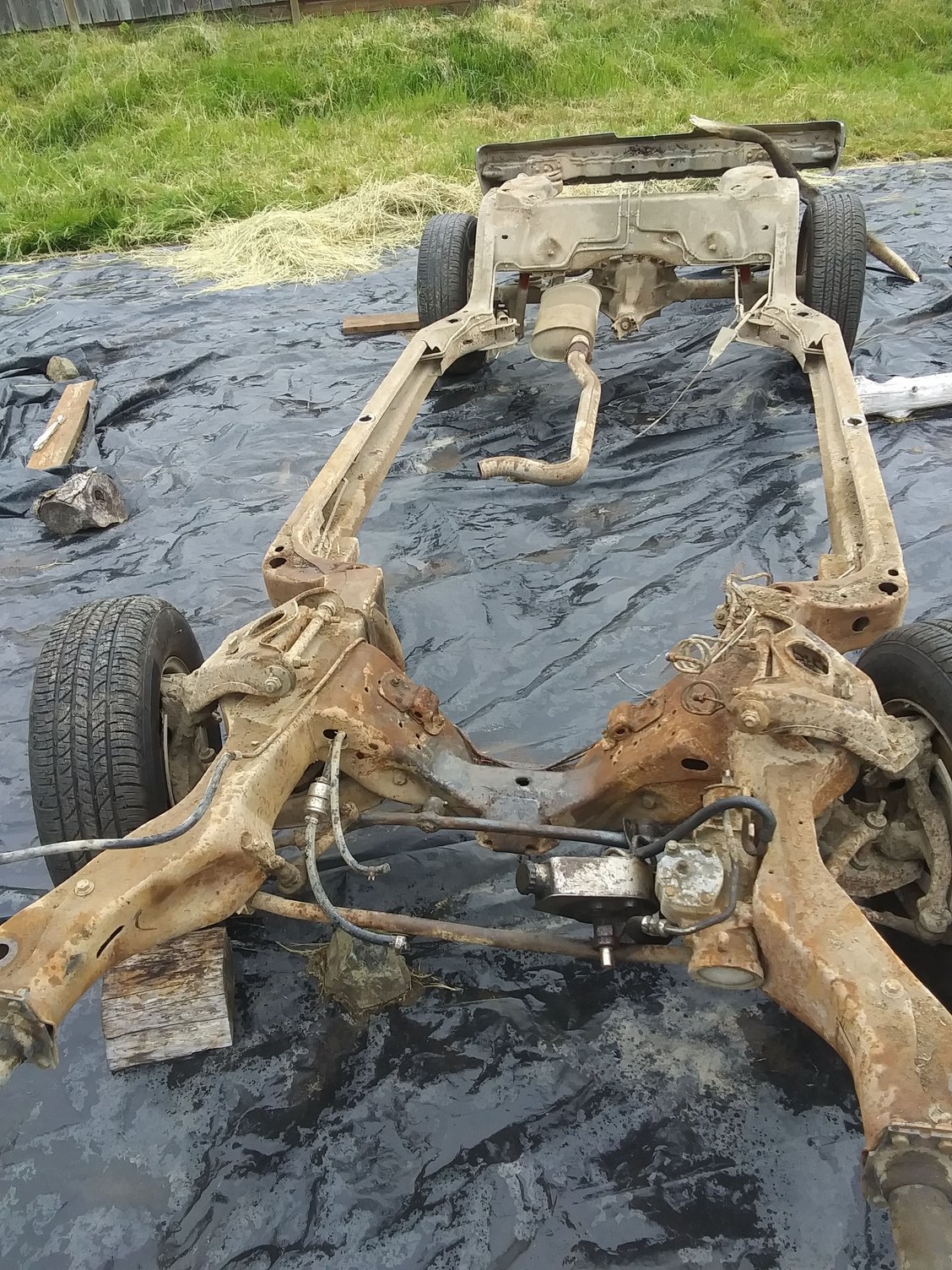

Ok, took a bit longer than I'd hoped because of n00bishness and not realizing that there's certain tools needed that the manual didn't call for to make the job easier (lessons learned for sure), it finally happened.
We have liftoff!
Here's a before picture of how dirty this thing really is.
And another
Since mounting it I've started cleaning it off at least a little. I accidently took off some of the paint but nothing a touch up can't handle. I can get the rest once the valve covers come off to replace the gaskets which are definitely bad.
There's actually texts and symbols under the dirt and oil! So far I feel a lot like those Victorian era archeologists uncovering lost treasures in Egypt. "Sirs we've made a grand discovery!" "Corgh Blimey! Call up the Queen's Governor immediately!"
I also drained the oil before pulling it out, it looked really good. No sludge and no worrying shiny bits so far.

Continuing to prep to remove the frame for sandblasting, don't have pics right now. I was going to have it powdercoated to rust proof the frame, the problem is I started asking how they coat the inside of the frame rails.....turns out they don't really which makes it worthless. Sure it would look nice on the outside, on the inside there wouldn't be anything to protect it making it just as prone to rusting as it is now. Since I'm planning on doing annual lanolin undercoating anyway, I think it's just better to stick with that since I can get it into the rails.
Once that's done I'll be circling back around to finish the engine cleanup as has been suggested here (thanks!) and do the work that's needed on it. I'll take it in a few stages, the first of which is to replace the timing chain gear, motor & transmission mounts, oil seals, valve cover gaskets, exhaust manifolds, and freeze plugs (one of them had been leaking). I'd like to order them this week so they're on hand when I revisit the engine. After the engine goes back into the car and connected up, I'll be tuning it, then one at a time putting in a new fuel pump and new distributor.
