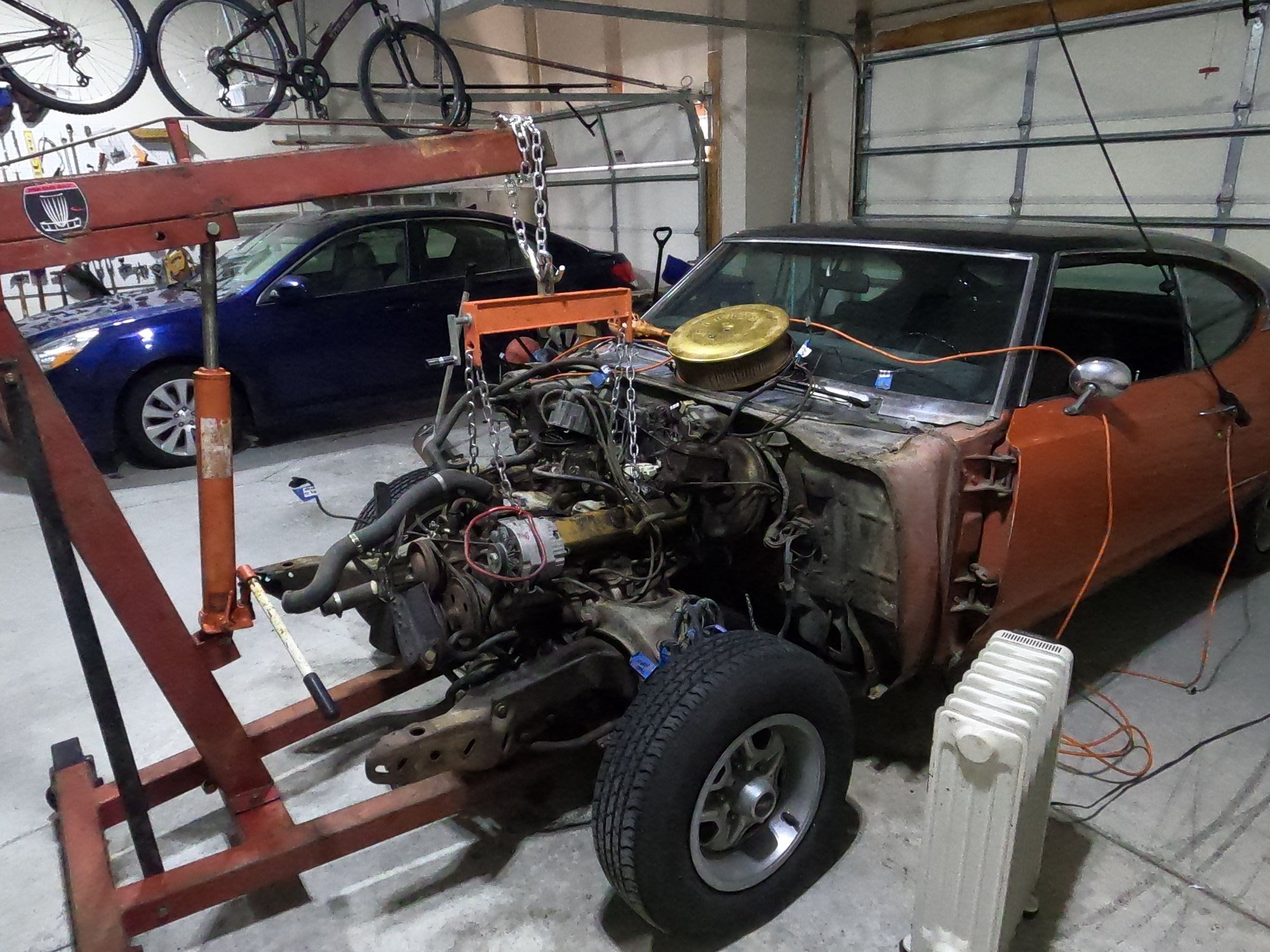

...Where is the best place to bolt onto the motor with the hoist chains? I have seen some literature say the intake manifold or on the heads...
I always bolted the eyelets onto the intake manifold. Since you're going to tear the mowderr down anyhow, risking vacuum leaks will no longer matter. When you get your engine back together, it might be a good idea to get a set of permanent eyelets similar to the one circled in the following image:

[QUOTE=I always bolted the eyelets onto the intake manifold. [/QUOTE]
I like this idea. Much better that those plates that bolt to the carb pad.
You see people do it all the time but I don't like the idea of an engine
hanging from 5/16 bolts.

I would use the factory lift points...

Right. You'd cetainly wouldn't want to stretch one of those studs.
If I recall right, these loops were standard items already bolted onto later GM engines from the factory.
If Olds engines only had threaded holes imbossed into them, lift loops could even get self-manufactured to fit

I went with bolting to the intake manifold. I got the motor pulled yesterday. I got hung up on the oil filter for a moment but other than that, it went smooth. I will work on getting the exterior of the body stripped down this week.

I see that heater. I used one myself this weekend. Good job with the removal.

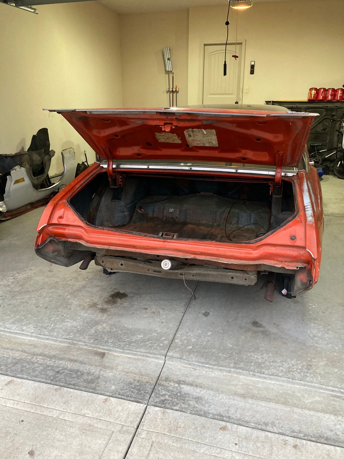

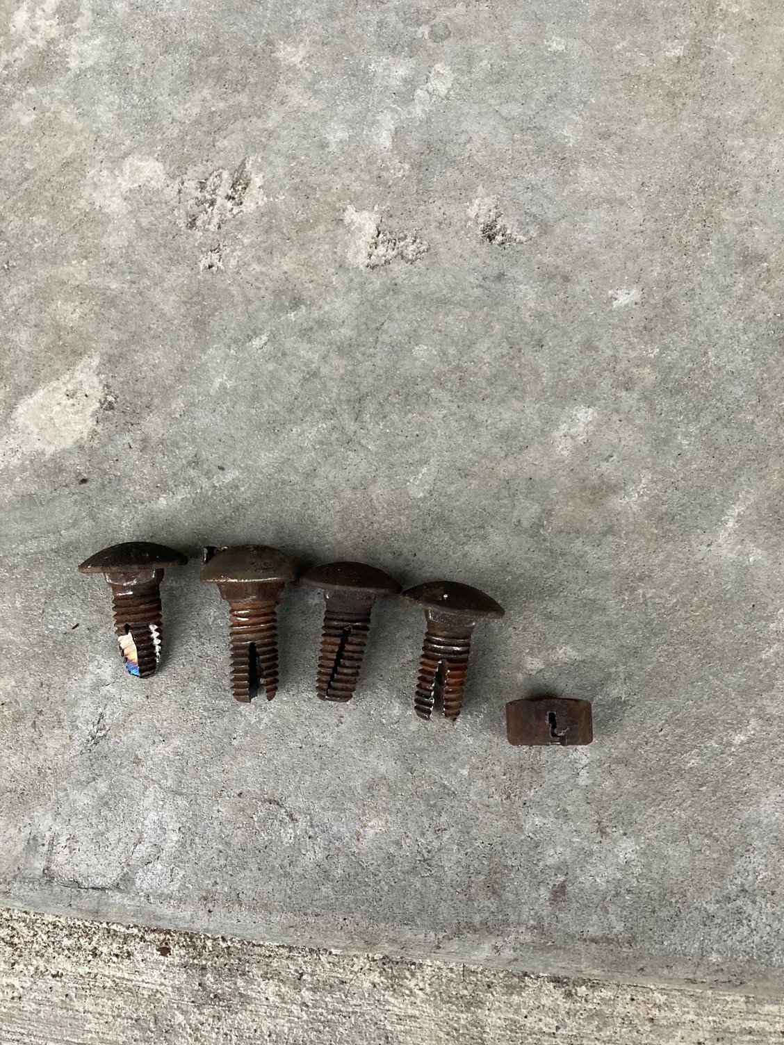

Slow going this week
I didn’t get as much done as I wanted to this week. Work got in the way and a few other things. When I did get to the car I ran into a roadblock getting the back bumper off. The carriage bolts wouldn’t break loose so after a couple tries with penetrating oil and an impact wrench I resorted to splitting the nuts and bolt with a grinder.

Good work on working around the bumper bolts.
what do you have for an impact that wouldnt bump those off?
I had an older plug in type that was good, but really gave the nick name rattle gun to its operation. I recently picked up a battery powered dewalt impact and that gun is 2x better than the plug in one ( and my old air powered one too). To date i have not had a stuck fastener i cant get off, and it doesnt rattle so much as just spin stuff off.

He probably didn't want to risk those shallow carriage bolts spinning while almost out. Thus, rounding off the bumper's square holes.
Using a torch to heat up the nuts could have discolored the bumper's chrome, also.

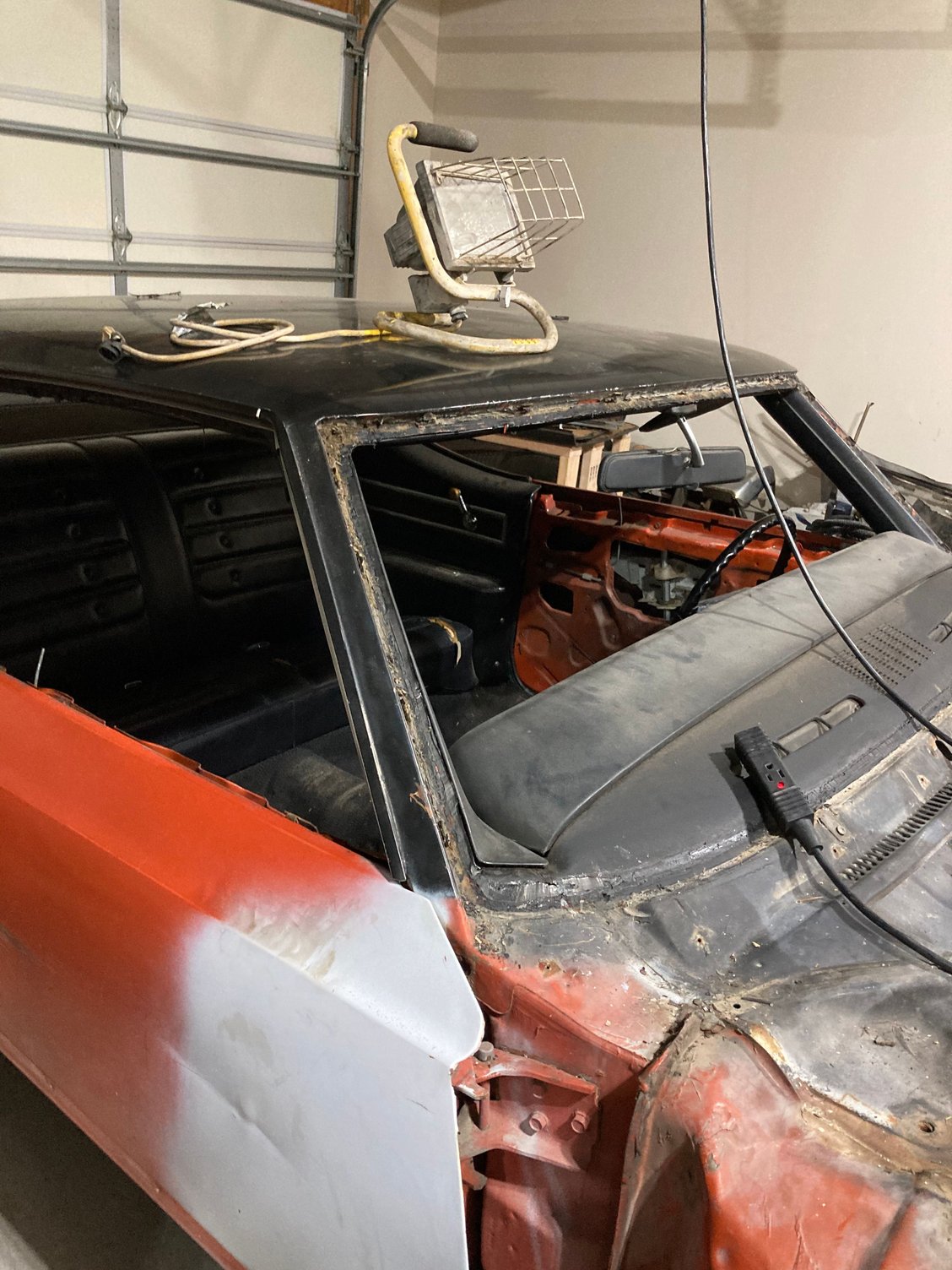

Rear Window Removal

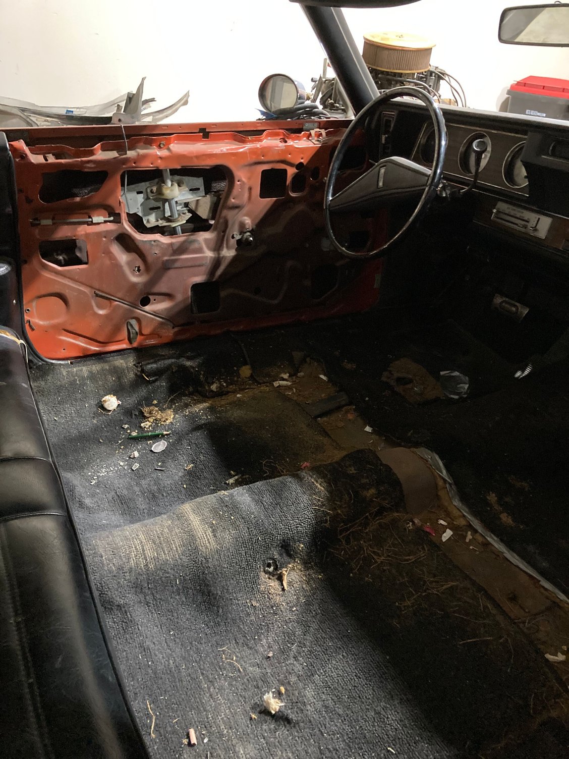

I think I will have the exterior stripped down this weekend. So my next step is to start working on the interior. I was thinking it would be nice to have the front and rear windows out to make it easy to get to the dash and back panels. I think the front window is just a matter of a loosening up the glue and lifting it out. It is already cracked so I am not worried about breaking it but how does the back window come out? The same technique? How do you store that back window for a year or so?

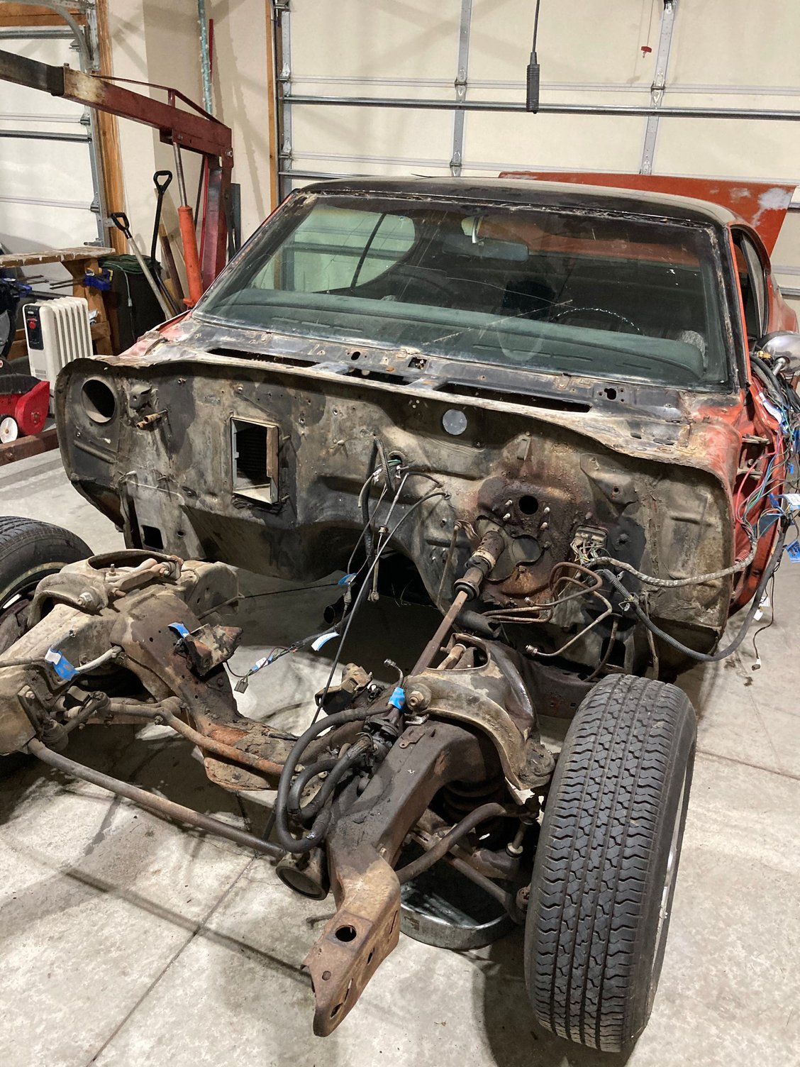

I got everything off of the firewall from the outside. I will pull the wire harness through when I start on the interior this weekend. Tomorrow I have the glass coming to take the windshield and rear window out. I figured it is safer for a pro to do it than me and a neighbor trying to loosen the glue and finagle it out on our own.

Back Window Removal : I just took mine out ('70 Cutlass Supreme) a few weeks ago by myself. I assume you've removed the trim already.
I bought one of those right angle glass removal knives ($20). At first it didn't do too well but I sharpened the "blade" and that improved it a tad. Also, I found that heating the blade with a heat gun helped in inserting it into the butyl/glue and aided in the cutting action. I sharpened and heated several times. Be ultra careful with the edges as any nick could start a crack.
Oh, try to get the knife to ride next to the body and not the glass itself.
Strangely, the rear glass is more expensive than the windshield.
It's a slow nerve wracking procedure for sure. I somehow managed to get my back glass out without breaking it but, it wasn't like I wasn't trying. After it was loose I started to lift it out and it fell into the package tray and if that wasn't enough as I was carrying it to be stored I whacked it into the vise. The windshield,,,, not so lucky. The knife slipped and caught the edge and the ominous crack appeared.
For storage, I cut cardboard and Christmas wrapped it and put it where nothing can get to it.
I'll be following your build with great interest. BOL!

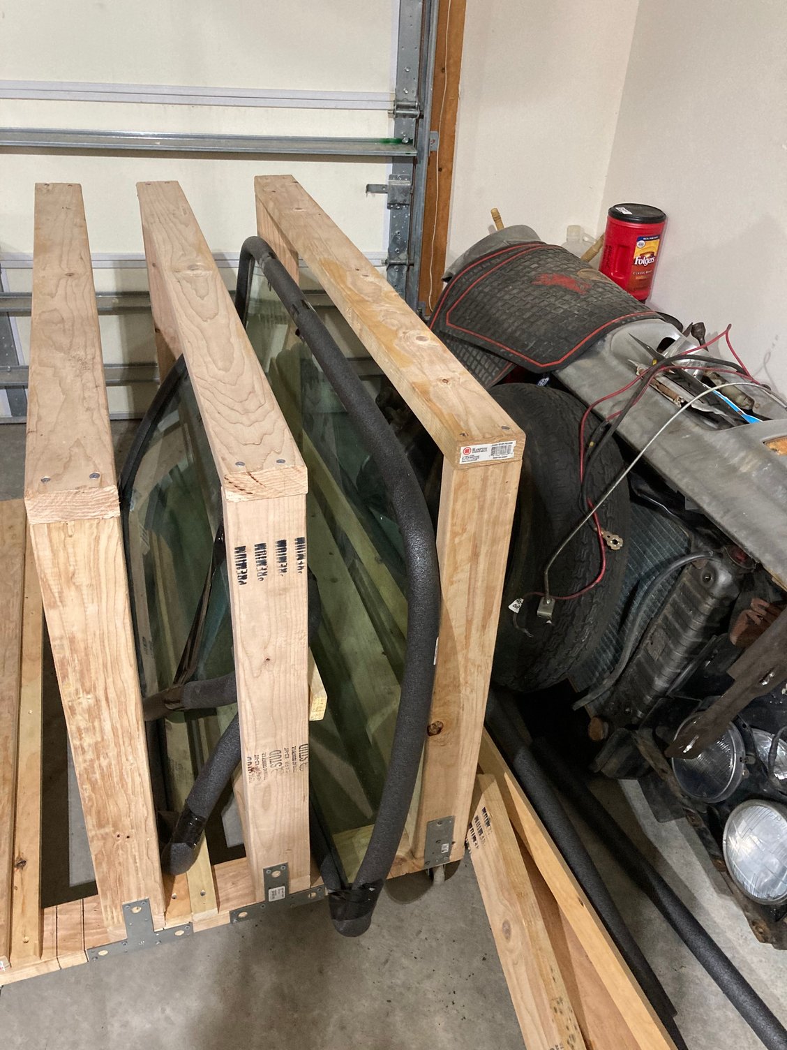

It's Cold out There

Good idea on the glass rack and pipe insulation.

I like that glass rack!! Nice work!

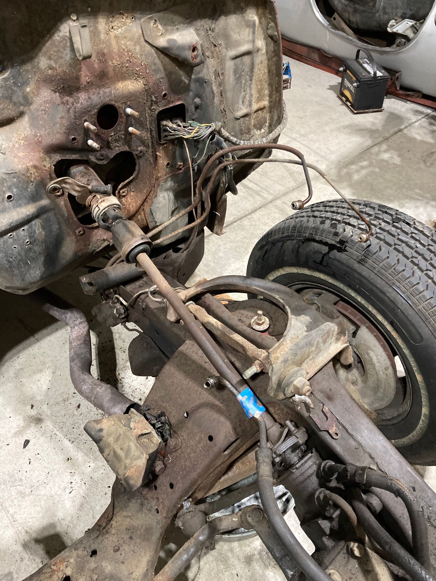

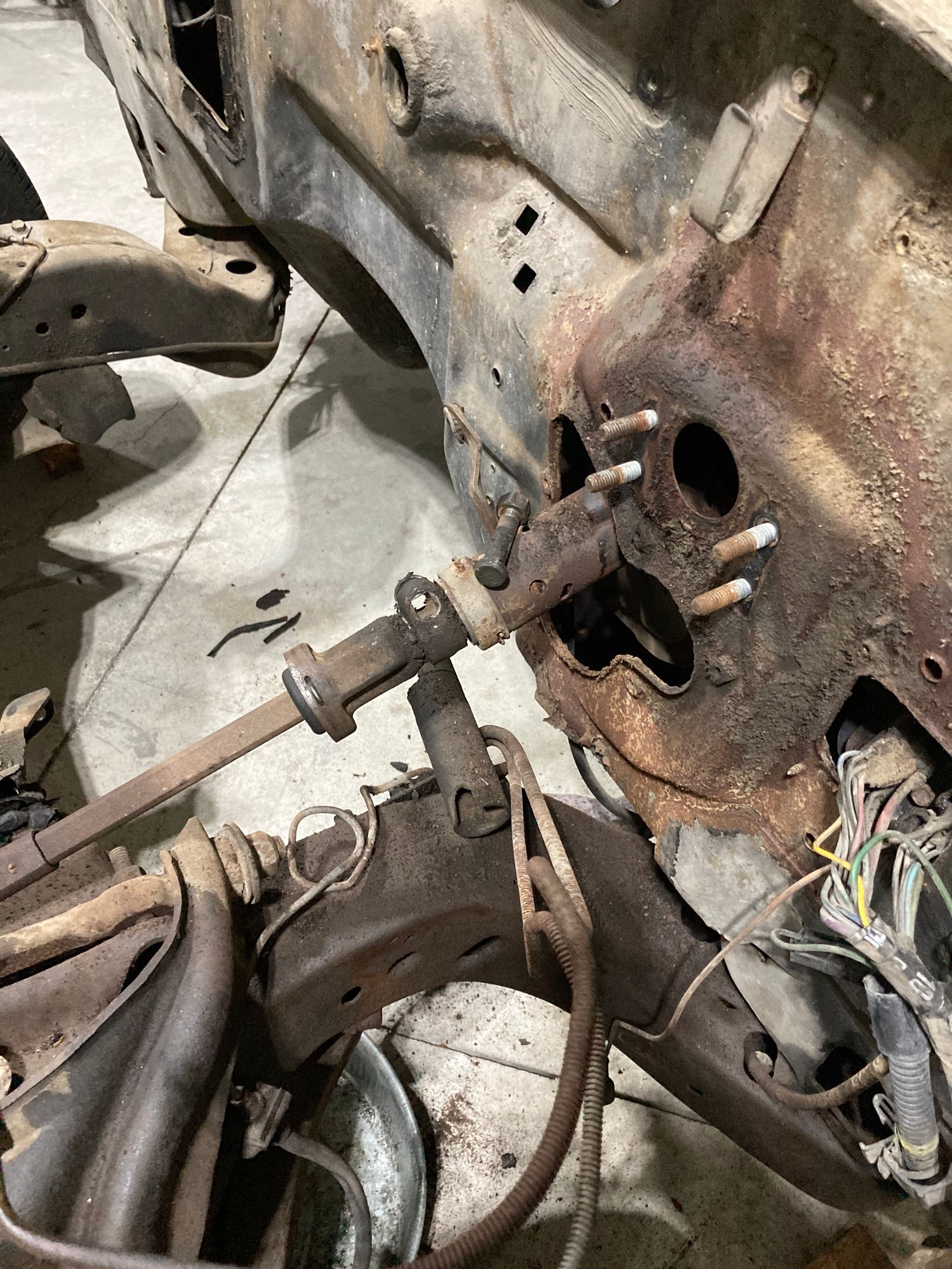

The last two weeks have been excruciating between getting my taxes done and dismantling the interior. I got the back seats, rear panels, package tray and headliner out. Today I spent the day slowly picking apart everything under and around the dash. The heater core and ventilation is out and I started on the steering column and got stuck. I am not sure if I disconnected the correct coupling. I think loosened the intermediate coupling and it should pull out from there but when I look at the service manual it talks about the two bolts at the flexible couple down by the steering box. Does it matter?
I am calling this the intermediate coupling.
Or should I go all the way down to the coupling by the gear box?

Looking at the Product Information Manual, there are clear instructions that the steering column should be connected/disconnected at the rag joint near the gear box. So I will bolt up at the intermediate and disconnect the rag joint.

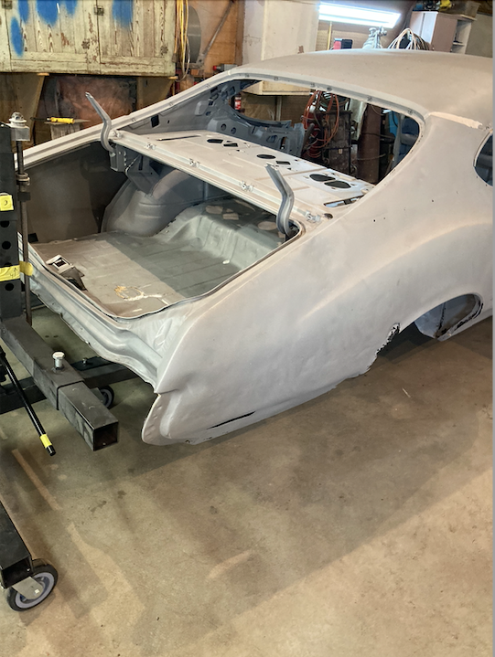

Body Off and ready for blast
I got the body off of the frame a couple weeks ago and onto the rotisserie. It took a little patience to get it balanced but it works great.

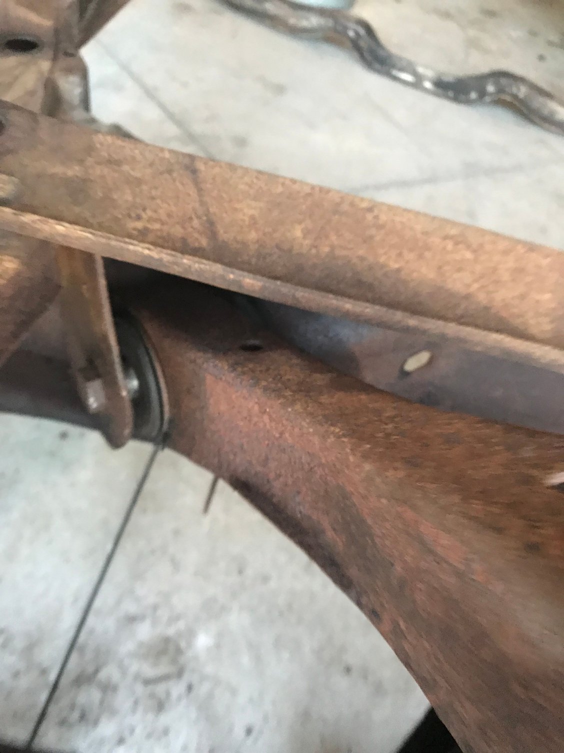

I have been working on getting the frame stripped down for the past month. I plan to get it blasted and powder coated. However, I have been struggling with getting the lower control arms off of the front and back. It seems that the bolts that pass through the bushings have seized onto the bushing and won't push out. I have tried heating them up and then pounding the bolt with a sledge hammer but that hasn't worked. In fact I started to bed the frame on the upper bracket in the rear. So now I am thinking about getting a reciprocating saw and try to cut the bushing between the arm and the frame.
Any suggestions?

I think the idea of a reciprocating saw (sawzall) is a sound method. It looks like you have the room. I personally would try to cut just the bolt if possible, then the control arm should drop out.
I'd be sure to get several quality blades.
Could maybe a screw type ball joint press be adapted? Not sure if the throat is big enough to go over the frame though.

I apologize for the long pause in posting updates. I did get the control arms free by using a reciprocating saw. It took 11 blades and most of the day. I was sore for a few days after wards but got them out.
Bolts seized inside control arm bushings.

Here is how close I cut it to one of the A-arms.
