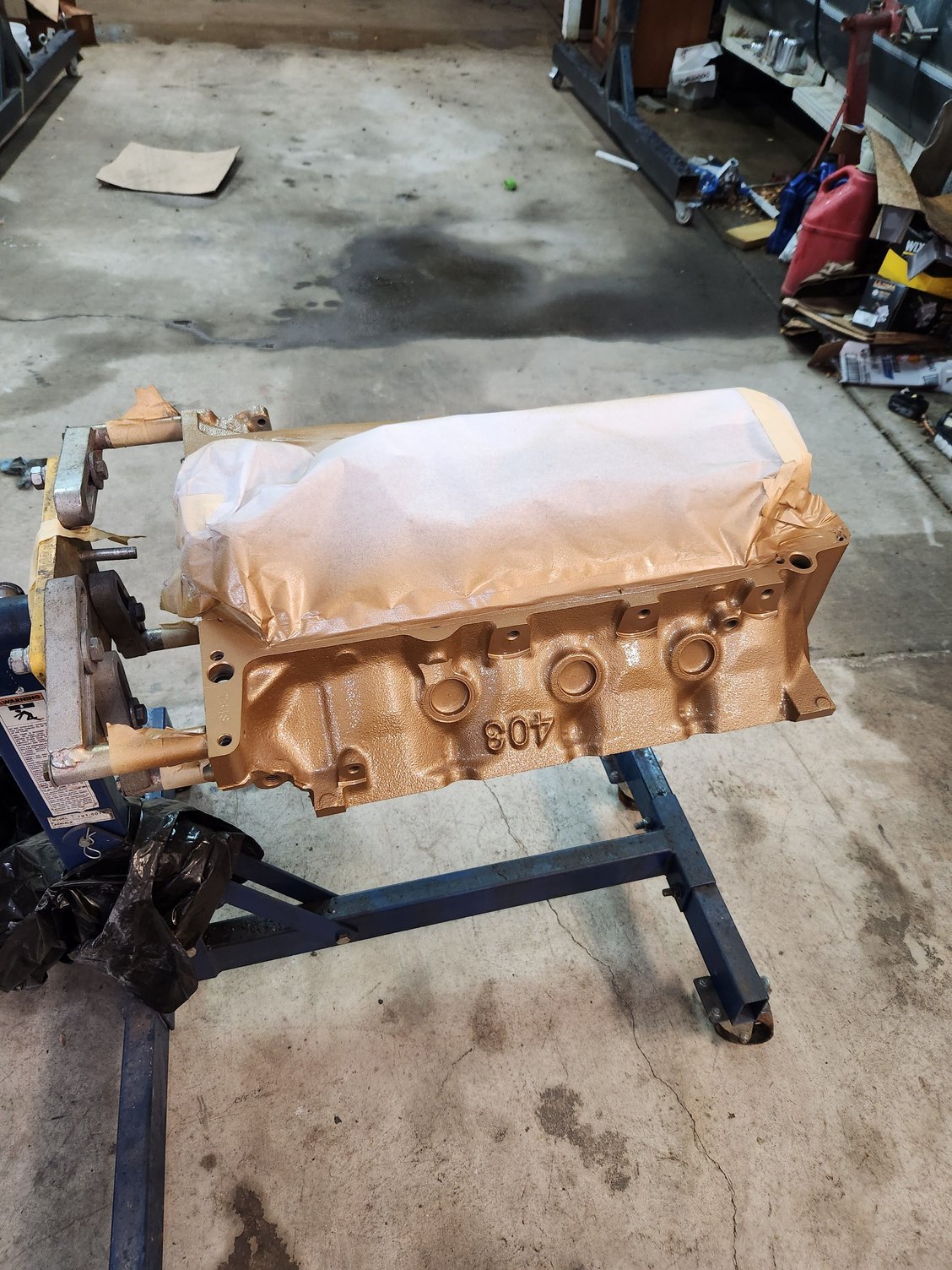

Little progress in the last week
Acquired lots of parts including a set of ported big valve #6 heads.
Tore down the 403. Everything was standard and untouched. Almost no wear on the bores. Dropped the block crank and heads off at the machine shop. Light hone, deck the block and resurface heads was performed.
Pulled the motor out of the Cutlass and started cleaning up the engine compartment while waiting for machine shop.
Yesterday afternoon picked up the machine work and jumped right in to removing the blue off the block and red off the heads. Cleaned and masked then shot with gold. I ordered some new can but did not get hear in time. Used the 15 y.o. cans and sprayed out great.

Stealthy! Love the Gold on the 403! Now, if it wasn't for that pesky cast-in "403..."
Just a stock 330 with a misfire LOL

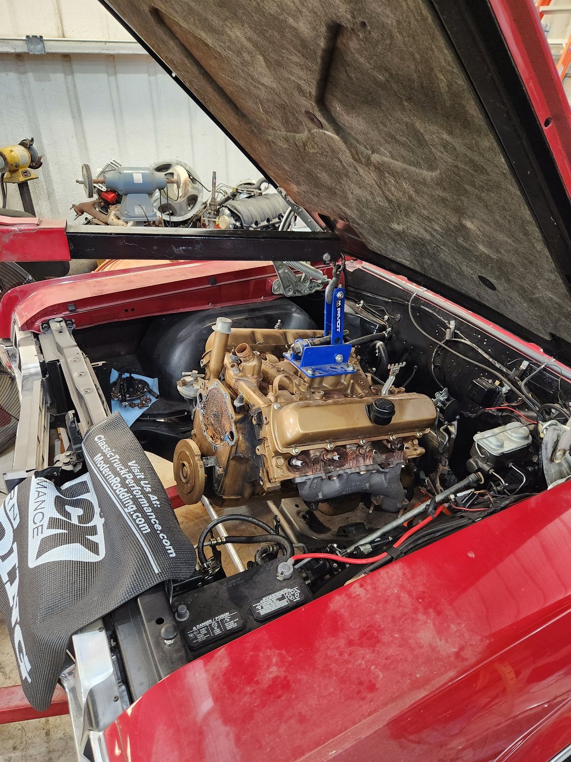

One day to go
Got the bellhousing dialed in and lots of small stuff done today. Markings on the tape is before adjustment. .007 offset dowel on the LH side made my total runout .004
I had a supervisor for part of the day.
Had to rob the pilot bearing from the old motor. Anyone need lunch? The grease was squeezing out so the bread did the trick.
A bird crapped on my fresh painted valve covers I set out in the sun to dry.
Now at a stand still till morning. The beautiful pieces of artwork made by American Racing Headers will not work with the stock starter. Wife will be at Summit at 9 AM when they open. Not looking good but not ready to throw in the towel just yet.
