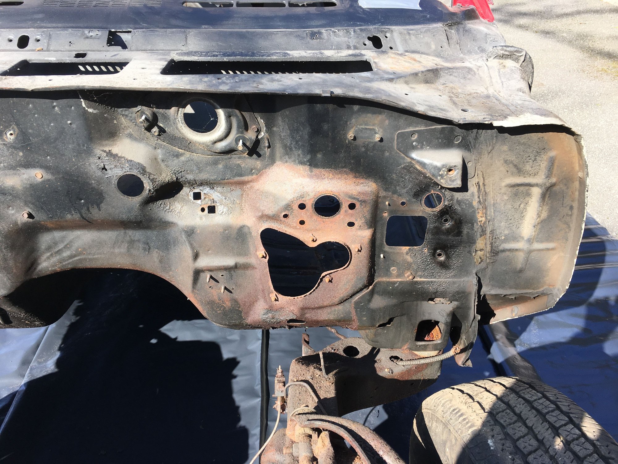

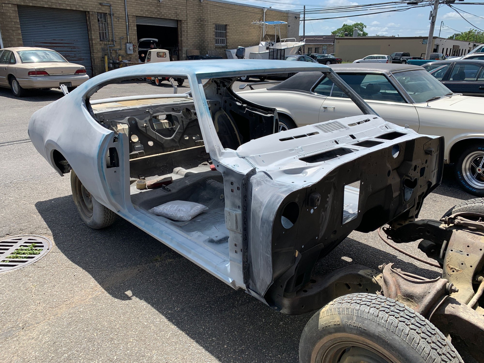

Here are a few before pics and after water blasting. After blasting it needed 1/4s, trunk floor, front floor pans, tail panel and package tray. Also has the usual rust in the dash. The fenders were nos from 1982 and I still have the receipt for the $100 they cost! They just needed some minor repair.

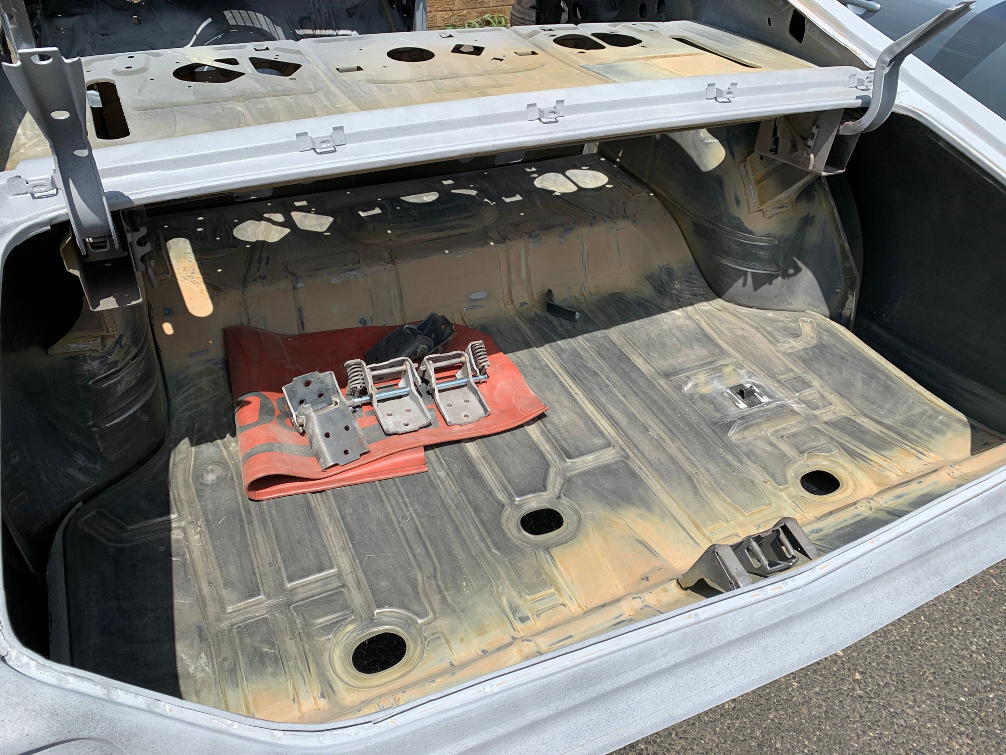

Getting the 1 piece trunk floor fitted.
As you know they don’t make a 1 piece floor for the olds so I used a chevelle floor and seemed at the brace.

Making the seams nice in the trunk. Glad that is over. Hated laying in the trunk!

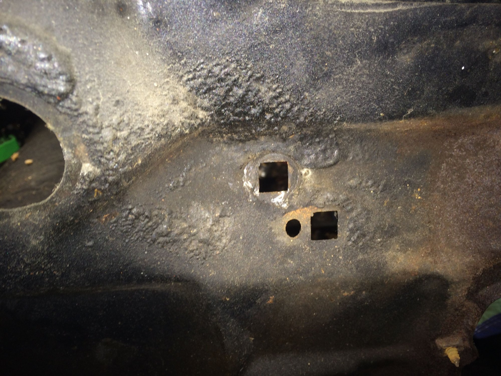

On to the toe pans and front floors.
Fitting the floor.
Welded in.
4 speed hump reinstalled.
From the bottom. Replicated factory cut out in floor.

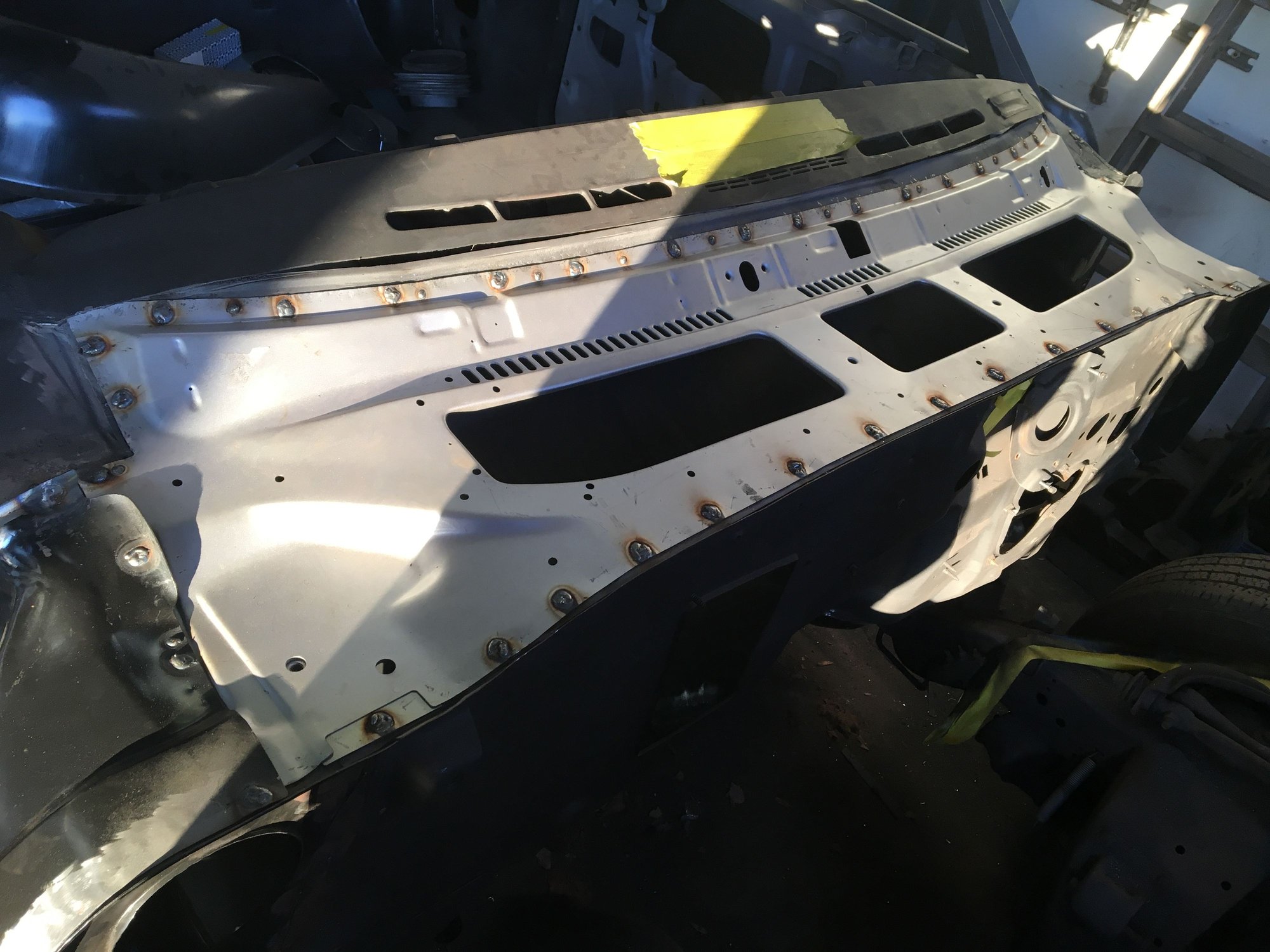

On to the dash repair.
Old Apr 21, 2022 | 03:43 PM
Trophyblue442's Avatar
Joined: Mar 2015
Posts: 461
From: Long Island, NY
Clean up and ready to be treated
Old Apr 21, 2022 | 03:44 PM
Joined: Mar 2015
Posts: 461
Top of cowl reinstalled
Old Apr 21, 2022 | 03:47 PM
Joined: Mar 2015
Posts: 461
Dash repaired and primed.

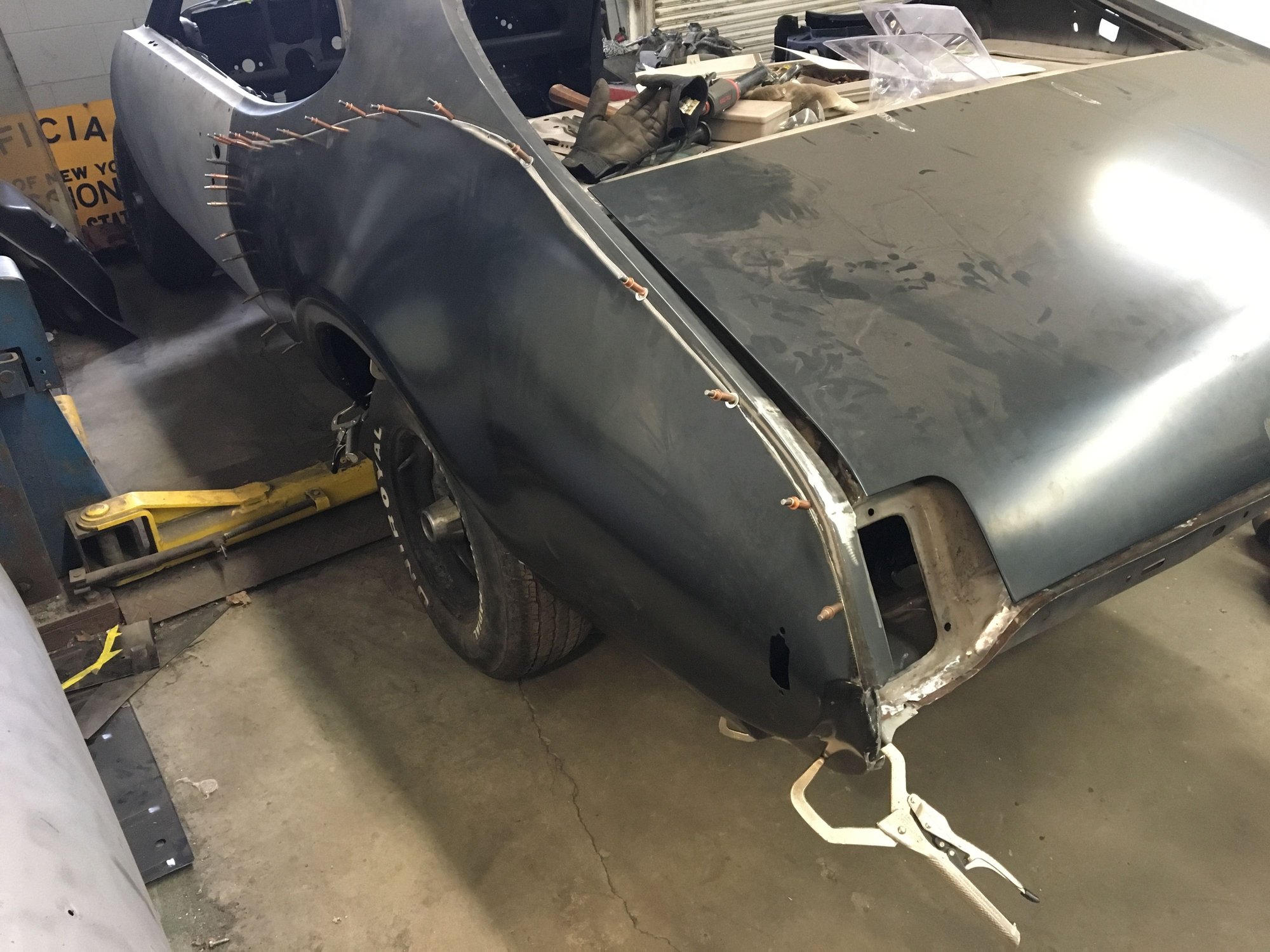

On to the 1/4 panels. NOS right quarter. Repo on left side.
