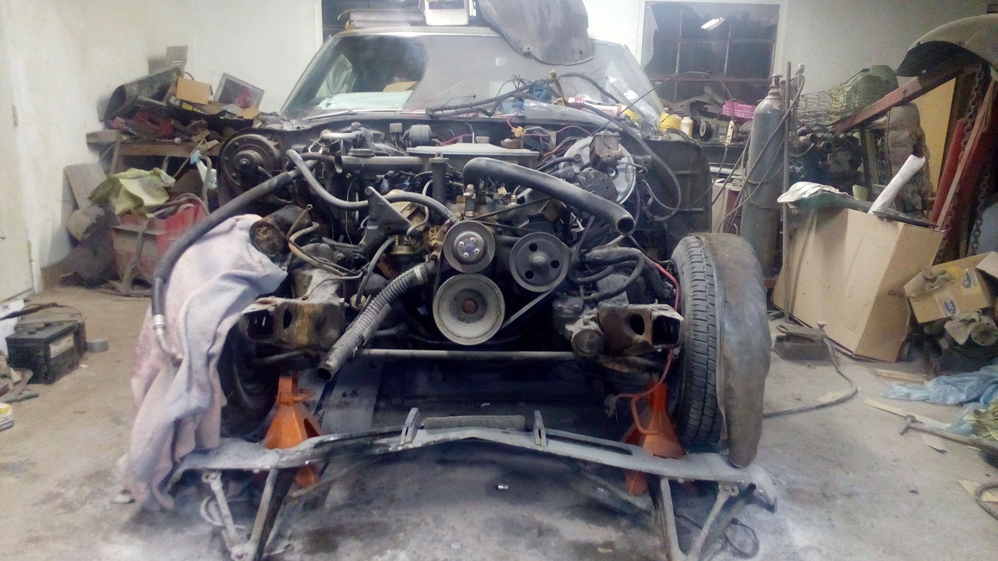

time for the front
Now that the back half is just about done i am going to start moving on to the front. I picked up these front fenders from a couple guys on here awhile back. dropped them of to be glass beaded last week and picked them up today. they look great. I have some dents and one crease, but no rust or rot. first picture is fresh from the blaster. then in primer for protection.

Front End
Front fenders are ready for a final block sanding before paint. I removed them tonight . The radiator and ac condenser removed from the core support. Then the core support from the frame. I took everything off of the core support and separated the center support. I will take it to have it glass beaded Monday. Its in surprisingly good shape. no rot at all! The engine is next to come out. lots to do!
