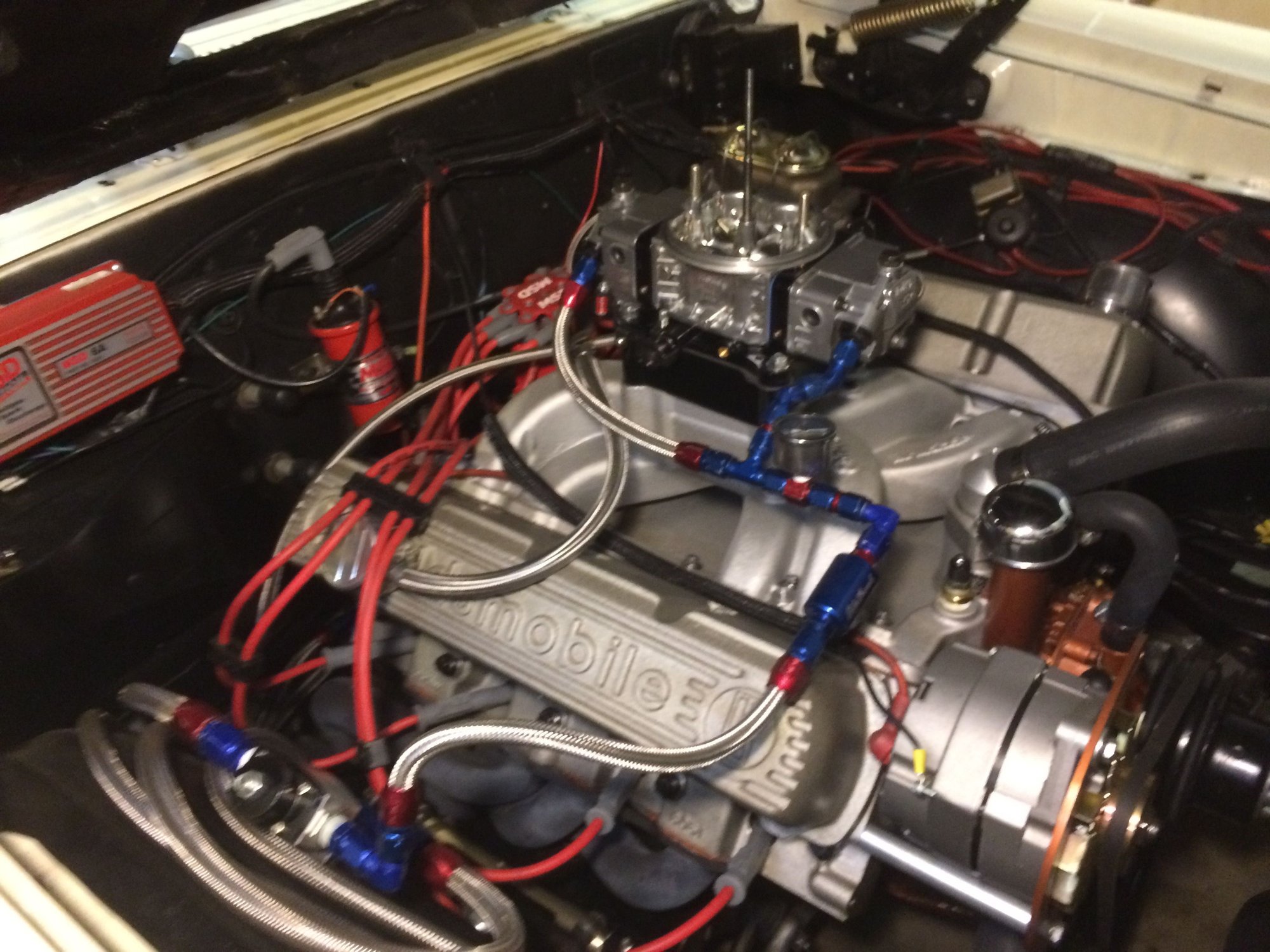

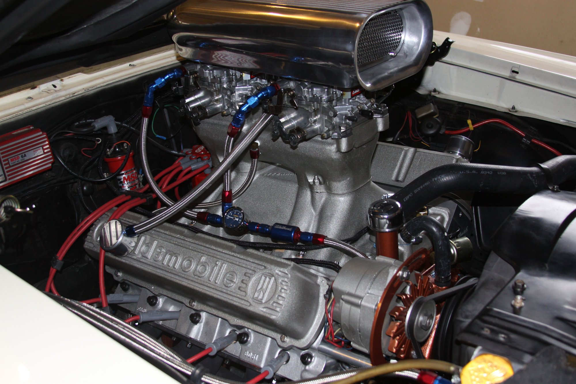

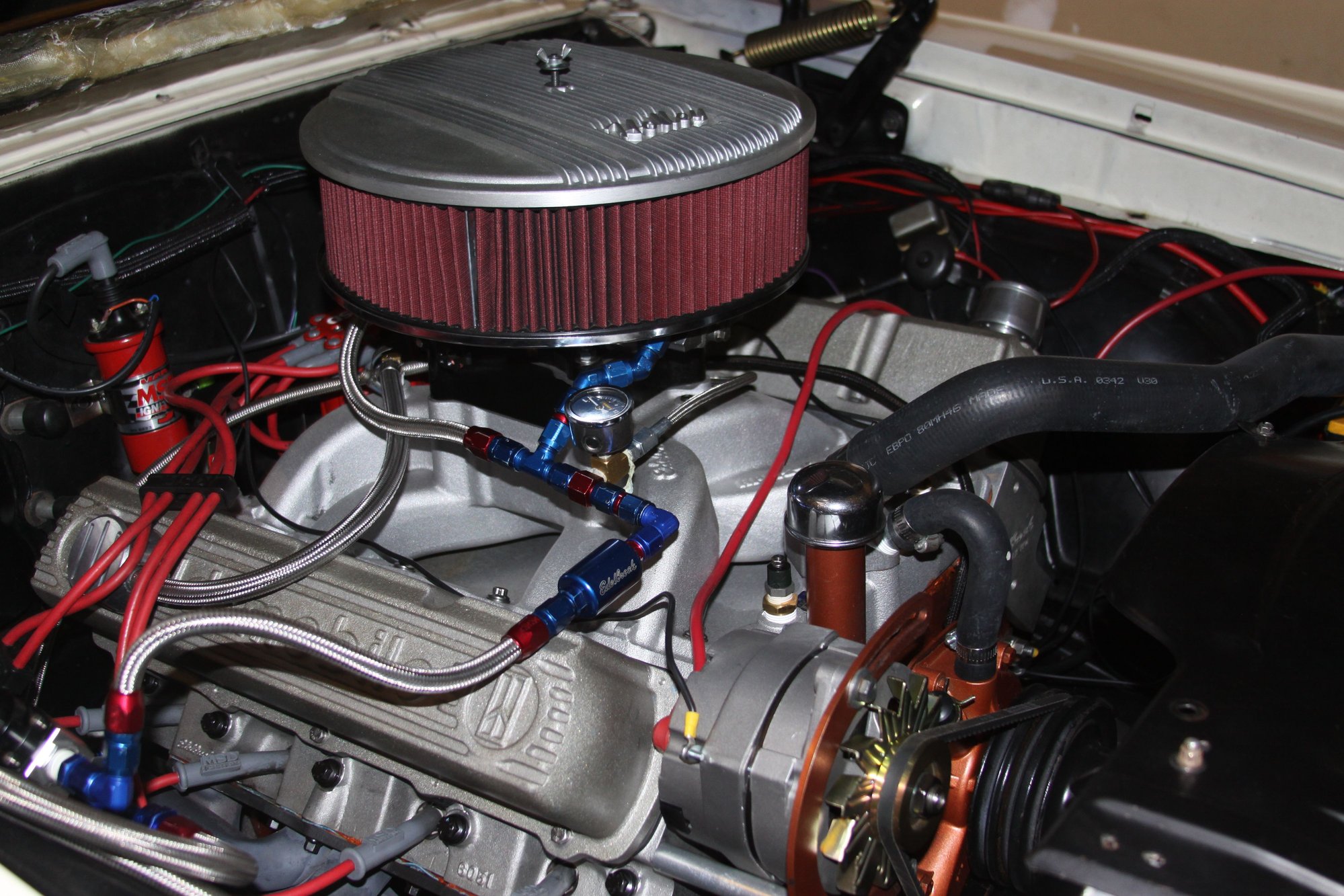

The engine is a 455 ,030 over.
Eagle crank
Eagle forged "H" beam rods
Probe Flat top pistons
11.5 to 1
LUNATI solid cam .252/.261 @ .050, .560/.560 lift
.595/.595 lift with 1.7 ratio Harland Sharp rockers
Lunati Beehive springs
Edelbrock heads
Edelbrock Air gap
Holley Ultra XP 950 cam carb.
Hurst Quarter stick
Hughes 3,000 stall
Hooker headers
Pypes 3" exhaust.
Rebuilt TB-400 with Hughes heavy duty bands and clutches.
Rebuilt "O" rear with limited slip 3.90 gears and HD axles.
Great stuff disc brakes all around.
Be Cool radiator with electric fan.
JVC stereo with Infinity 6 1/2 in kick panel, Infinity 6x9 in rear tray and 2 Infinity 10 inch woofers in trunk. 2 100 watt Pioneer amps.
Tubular front and rear suspension.
QA1 shocks
Lakewood ladder bars.
MSD ignition.
67Olds442X2 is offline

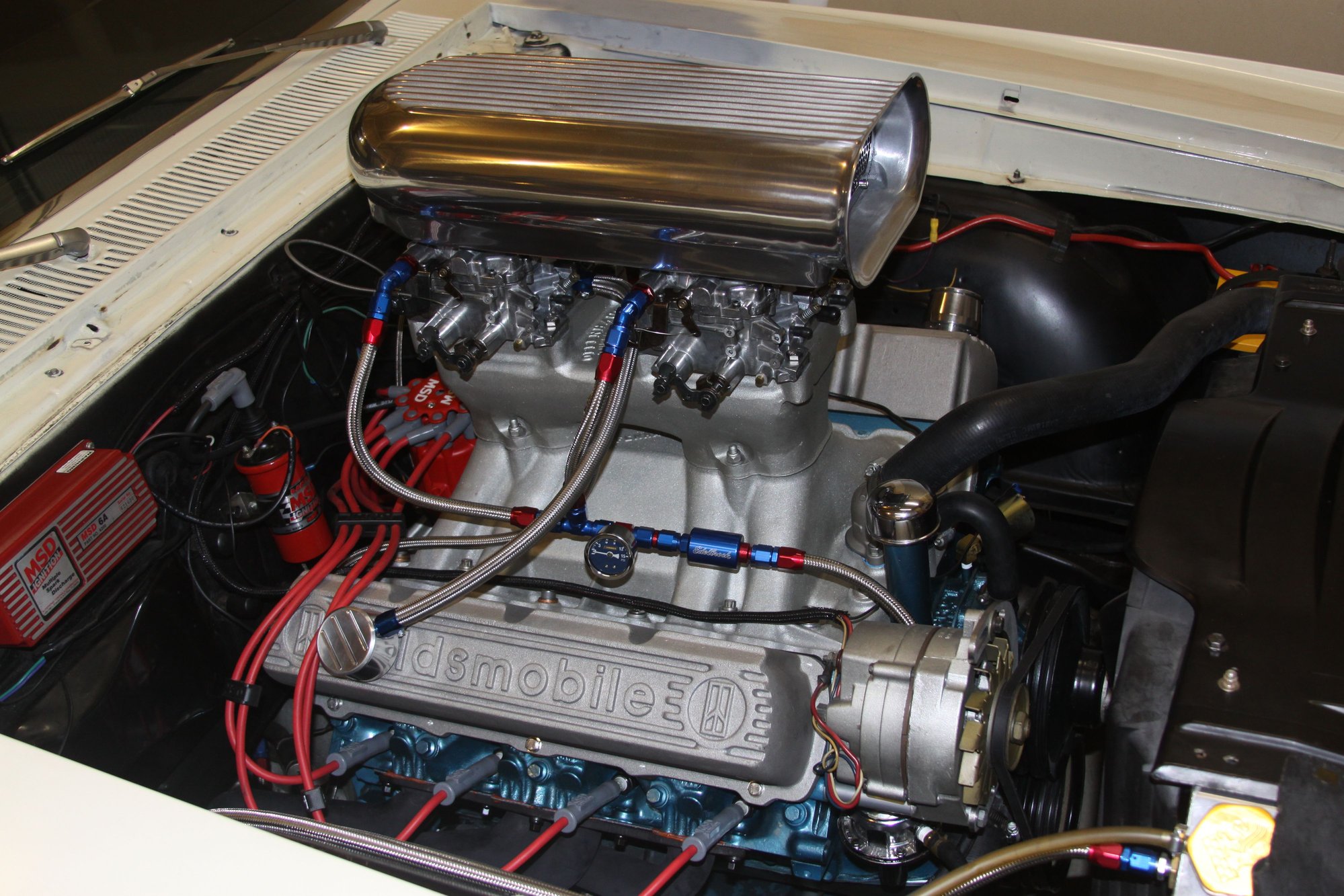

I've rebuilt the engine 5 times. Had a Vette to rebuild also. For the olds had duals quads, changed carbs, changed to roads lifters, put tunnel ram on then Edelbrock heads, then the final build with all the hot parts . I've used the same block for all and I with use my virgin block next go around and have it machined for the pistons. The first block was in limits but I was getting too much blowby crank case pressure. May change to a solid roller cam and victor intake. AS you can see i'm a weakling.

Thanks. The tunnel ram is gone. Using a 950 Holley Ultra. The block I'm using I got a long time ago. I've never had any machine work on it. I got a virgin 455 block and I'm going to build it a little smarter. I went farther than I should have tearing it apart, the bond on the passenger side started cracking. I'll say I got parts everywhere but I know where they all go.

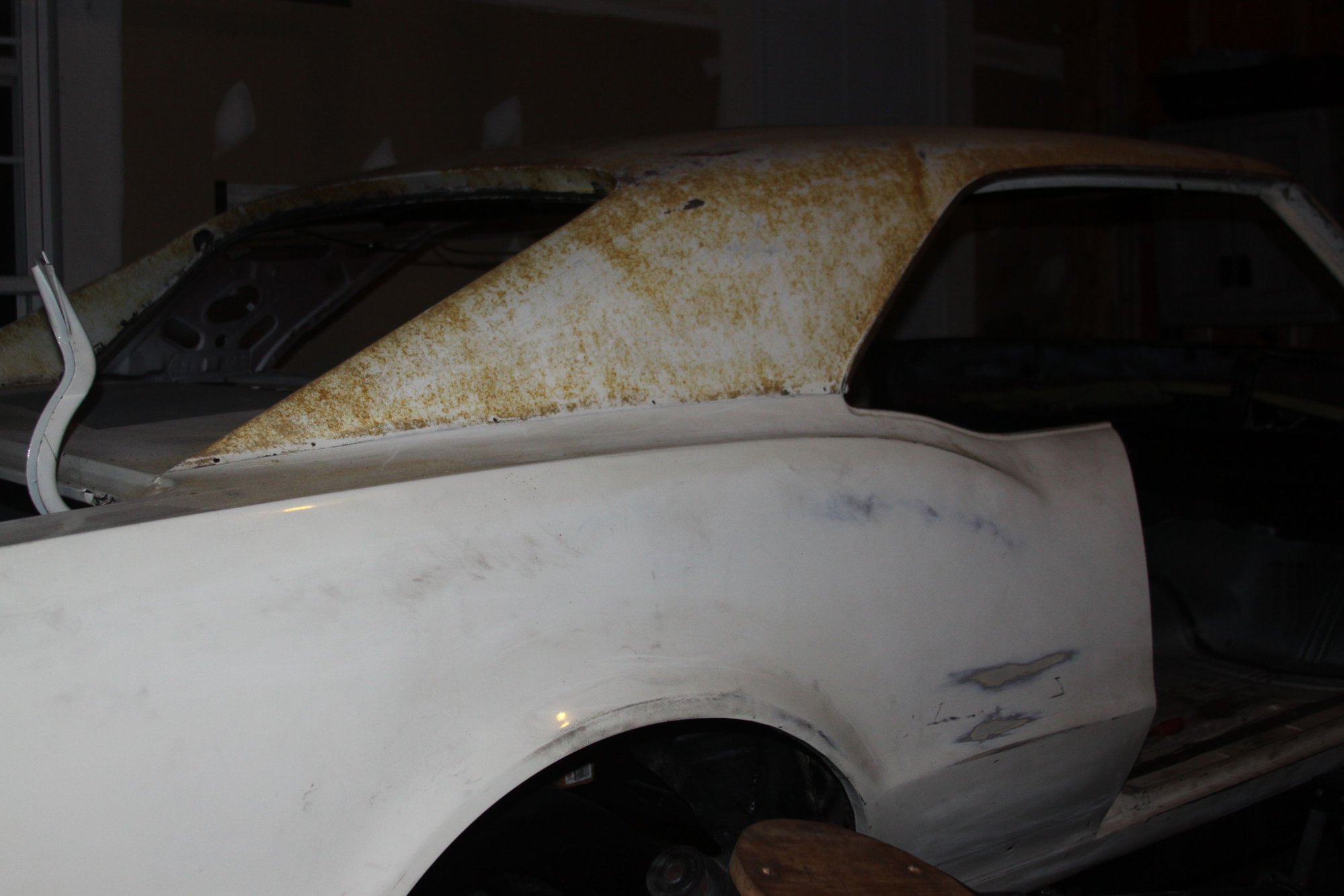

I started working on the car finally. Been sanding the body to get to the primer state. Need to get a welder. Some prior body work was done poorly. They drilled holes in the body and put bondo on and didn't try to bang out the damage. Just a small area on the right rear quarter panel. Need to fix the dent then weld the holes. I'm going to smooth out the firewall also. Was going to put in a roll cage but I'm not doing that, i don't have thee proper tools to build one from scratch. Need to get the mechanicals done first,
Enjoy the ride. A few years back when I had the tunnel ram which never ran well.
This is the car before iI took it apart, any sane person would have left it alone.
