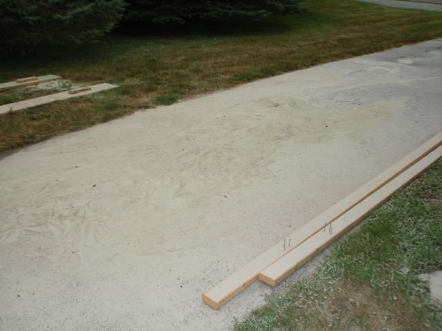

Scrappie - I can recommend the Dustless Blasting as it will give a very fine finish to the metal and the water helps to keep heat from building up in the body panels. Just be prepared for a MAJOR mess in your yard as this stuff goes everywhere. I'd have a large tarp laid down under the rotisserie to collect as much of the sand as possible and I also highly recommend sending your wife away for a "well earned" weekend and having it done then. Have her take your son also so he can't leverage it against you. Good Luck!
