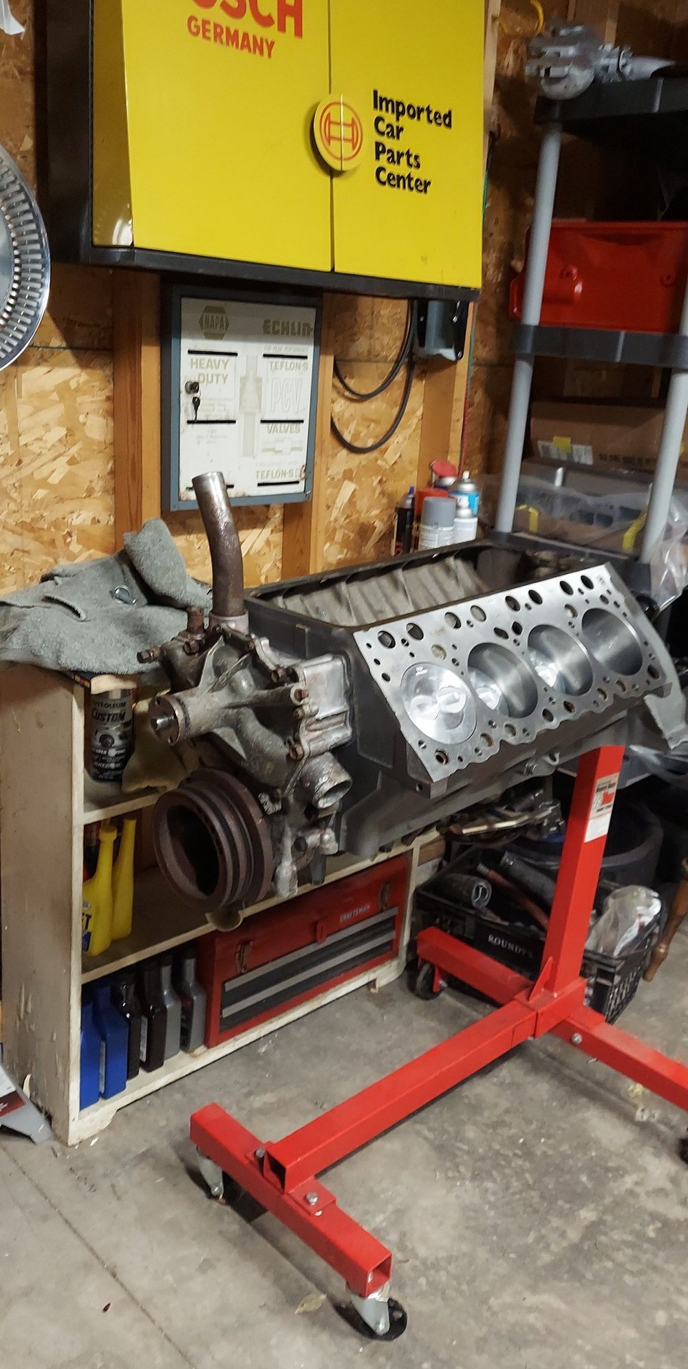

Hello! its been awhile since I have made a post. Today I got my engine back from the machine shop. They did...
Decking (dust cut)
Bore & honed (.30 over)
Washed crankshaft, main caps and pistons
Next the engine is being taken to a much more reputable shop in my area to have freeze plugs, crank polishing and cam bearings installed. I'm going to be reusing cam, lifters and pushrods. But everything else will be machined or replaced.
1. Do I need to have the mains line honed?
2. Do connecting rods need to have work done? I am unsure what to ask to be done on connecting rods.
I'm getting new pistons, rings, main bearings, cam bearings connecting rod bearings and timing chain
If there is any other tips lemme know, I'm trying to know a lot at 20 lol

It sounds like you're on the right tack .
Did you mark or identify each lifter as to which cam lobe it ran with ?
The cam lobes and lifters " wear in " together , and mixing them up can lead to their failure .
The mains should not need line honing , especially on a stock re-build .
You should ask the machinist to check them with a straight edge and an inside micrometer .
Yes , I would recommend that the rods be re-conditioned .
They will grind a small amount off the face of the cap and then hone them out the the proper size .
Are you getting the valves / seats ground ?

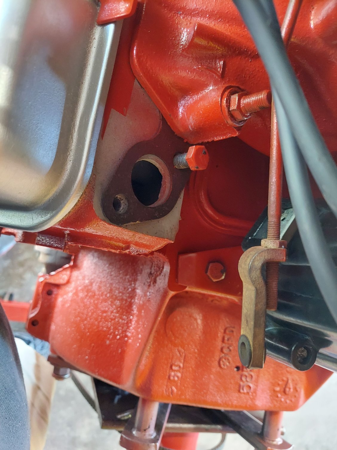

Hey guys! So I'm trying to put in all my oil plugs after it went to the machine shop but I don't know where some of them go for the 394. Does anyone know or have a diagram?

Read this thread ;
394 "Rocket" engine build - ClassicOldsmobile.com
I explain where the plugs go back in the block and heads . There are quite a number of them .
In the first few photos of the teardown you will be able to see the location of them on the block decks .
I got a frost plug kit from Fusick Automotive ;
1959-64 Olds V8 engine freeze plug kit-Fusick Automotive Products, Inc.
It contains a few more plugs than you will need , but it will have everything needed .

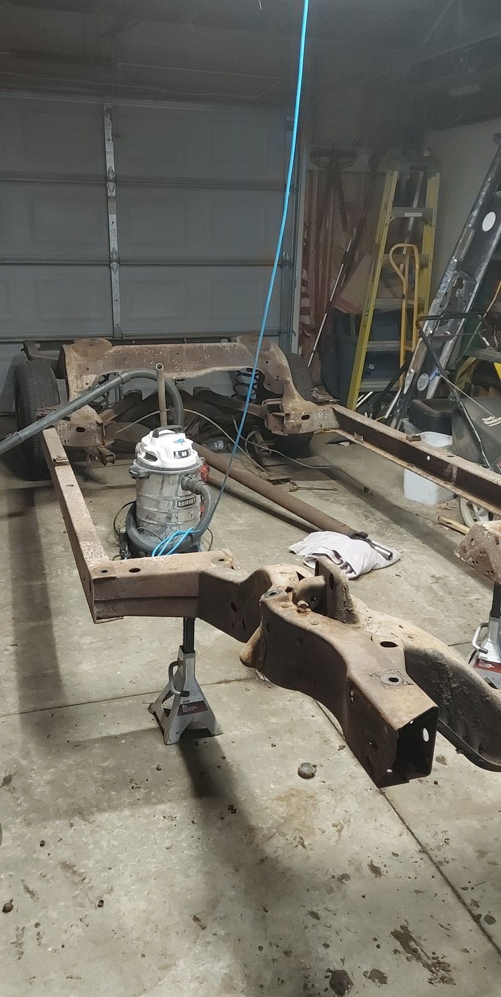

Do you still need a frame ?
If you do , I just thought of a place that might have one ;
Hess Bros. Auto Wrecking in Red Bluff , CA . Call 530-824-4100
They have several 63 & 64 full size cars in their yard .
Shipping will be expensive , but may still be cheaper than trying to repair a badly rusted frame .

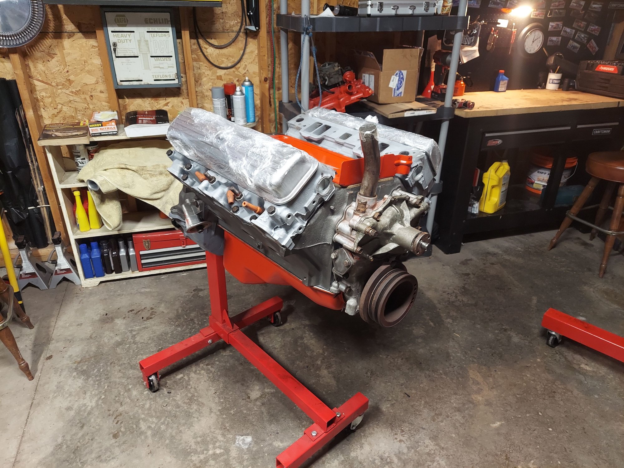

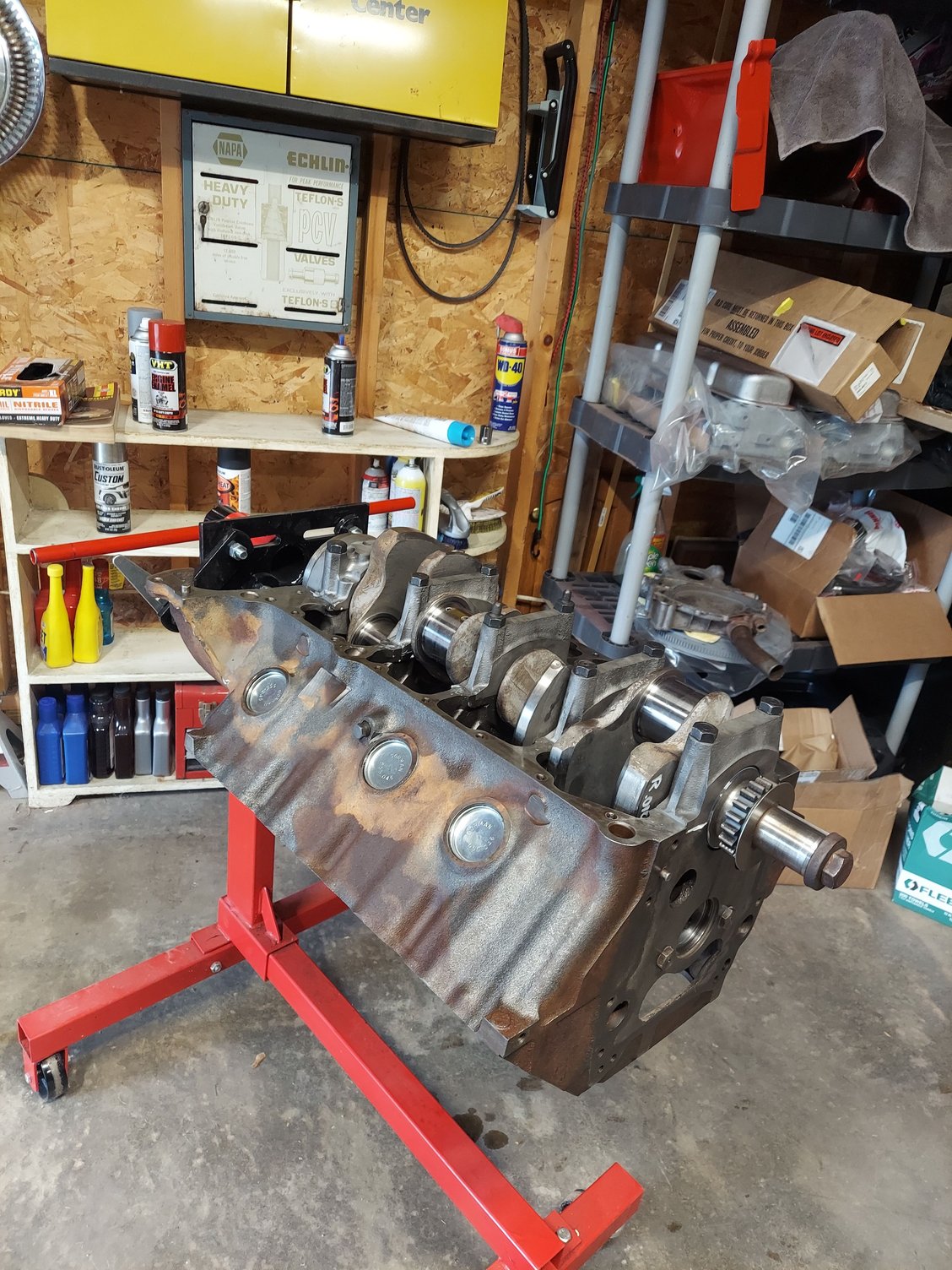

Things are getting closer! Bottom end has been assembled. I checked all clearances and all were within spec. These clearances were main bearing, rod bearing, compression ring end gap, oil ring end gap and side to side rod clearance. I also made sure things like oil spit hole direction, piston direction and ring placement was correct. The motor with the timing chain now on is a little hard to turn but with how many things are now moving I assume its normal, like I can do it by hand but its tuff. Also after it came back from the hone they bead blasted it for free! looks like it just rolled out of the factory. The only thing I'm nervous about is I cant seem to find the block dowels that aline the heads. They gave me a bag but I may have misplaced it, ill keep looking tho!

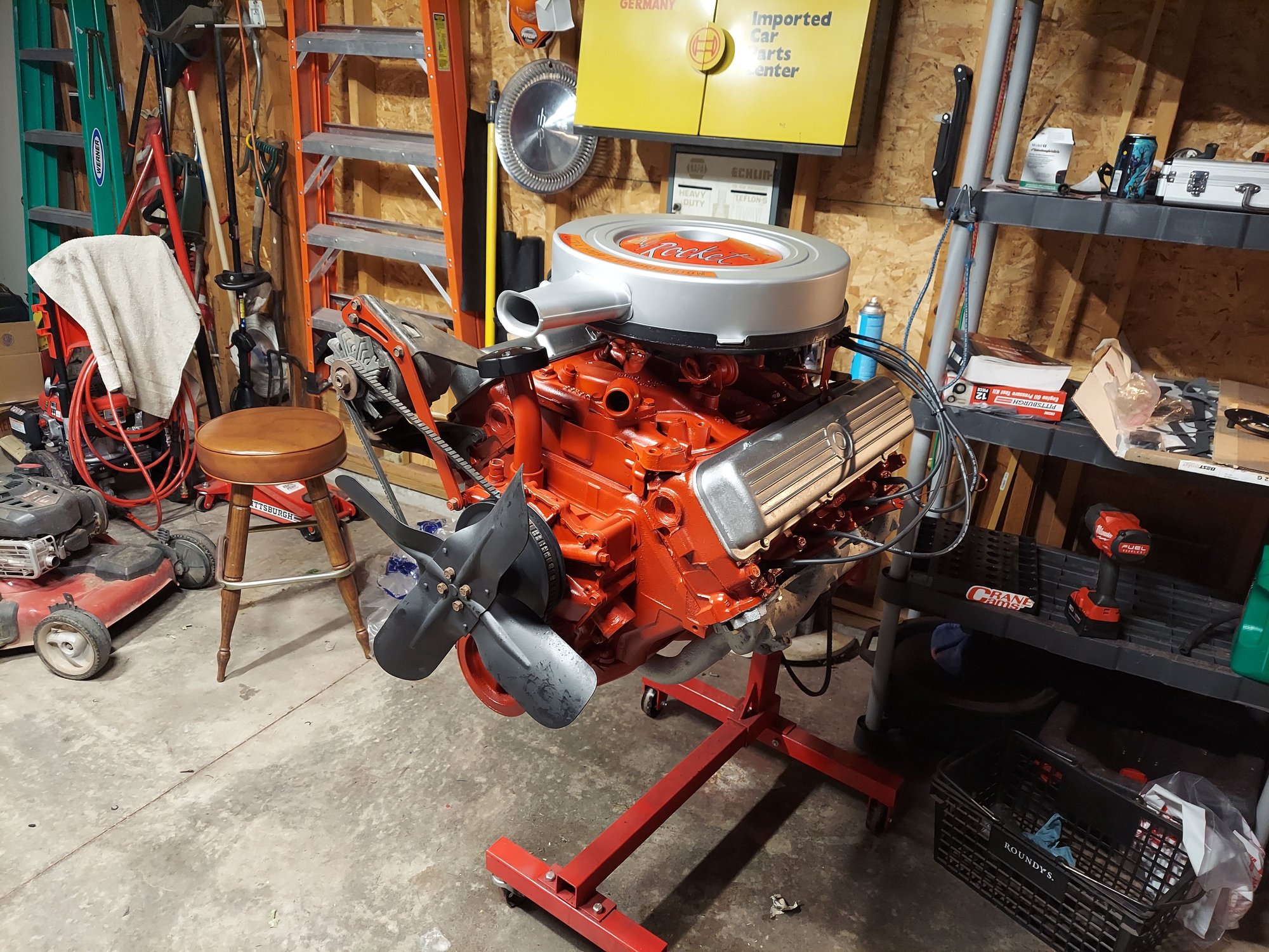

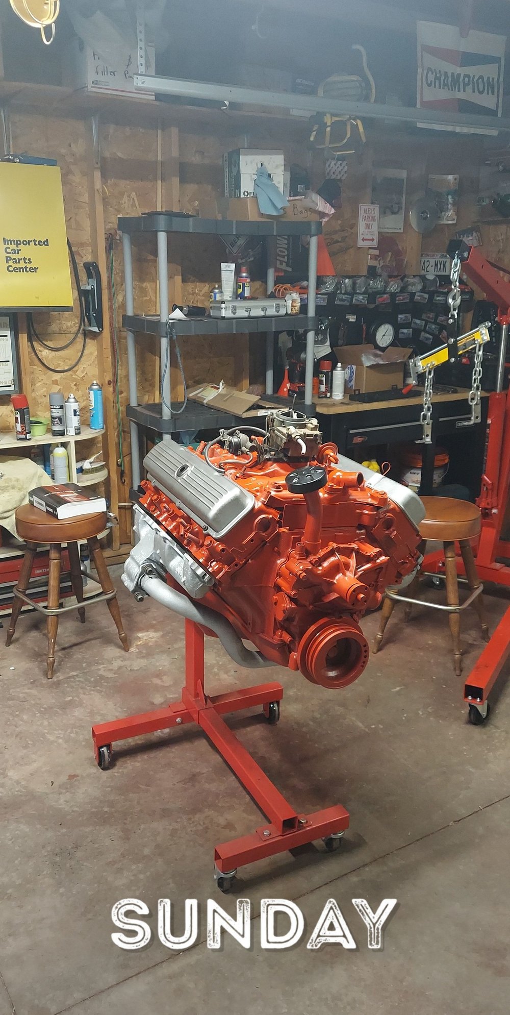

Hello im back with other update! My 394 has come a long way since last october. With everthing preped its time for paint!
Thank you all of this forum so much for almost a year of help and tips, I could have not done it without you.
I will keep updating!

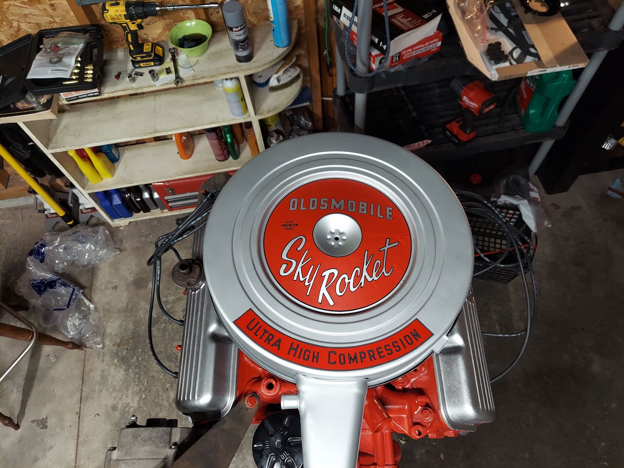

Talking So Close!!

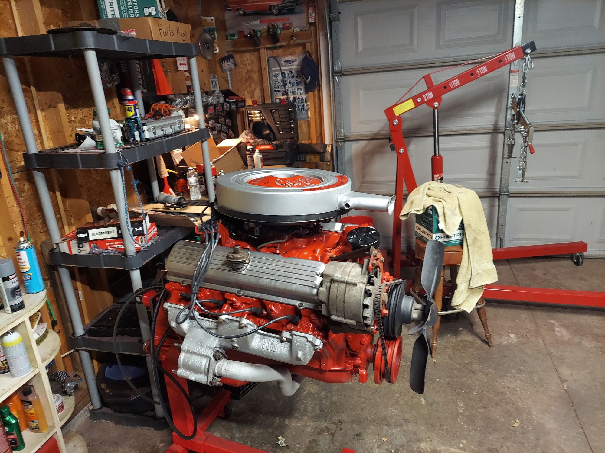

The motor is 95% complete! I pre primed the motor and it had 70PSI of oil pressure using my drill! Oil made it to all rocker oiling holes. I'm now doing some final things like the fan and the alternator. I unfortunately could not locate a frame near me that did not have holes in it, next week the frame comes home to get worked on. It almost been 1 year since my first post on this thread! More to come!
It red in real life! Its orange because of the lighting.

Don't worry, little 👨‍🔧 friend! No one would ever mistake that for a Chevy lump!
Wish I had a solution for the frame. If it's the usual 63-64 rust at the rear torque boxes, you might be able to scab or sister some steel plate onto what's there and save it.

Paint the harmonic balancer ring BLACK and then put a WHITE line across at ZERO. It will make timing it when running much easier.

Very intresting thread and the engine looks awesome maybe have the same piston issue in
my 425 -65 , have also zero compression in cyl no 5.

Unknown coolant plate?
Alright sweet thanks! Also I'm trying to figure out what covers the driver side rear head coolant port. The passanger has a plate for the heater core but I just can't figure out what's on this side:
Old Sep 28, 2021 | 04:57 PM
  #157
Charlie Jones's Avatar
Phantom Phixer
Posts: 5,522
From: Apopka, FL
The throttle bellcrank for the transmission mounts there .

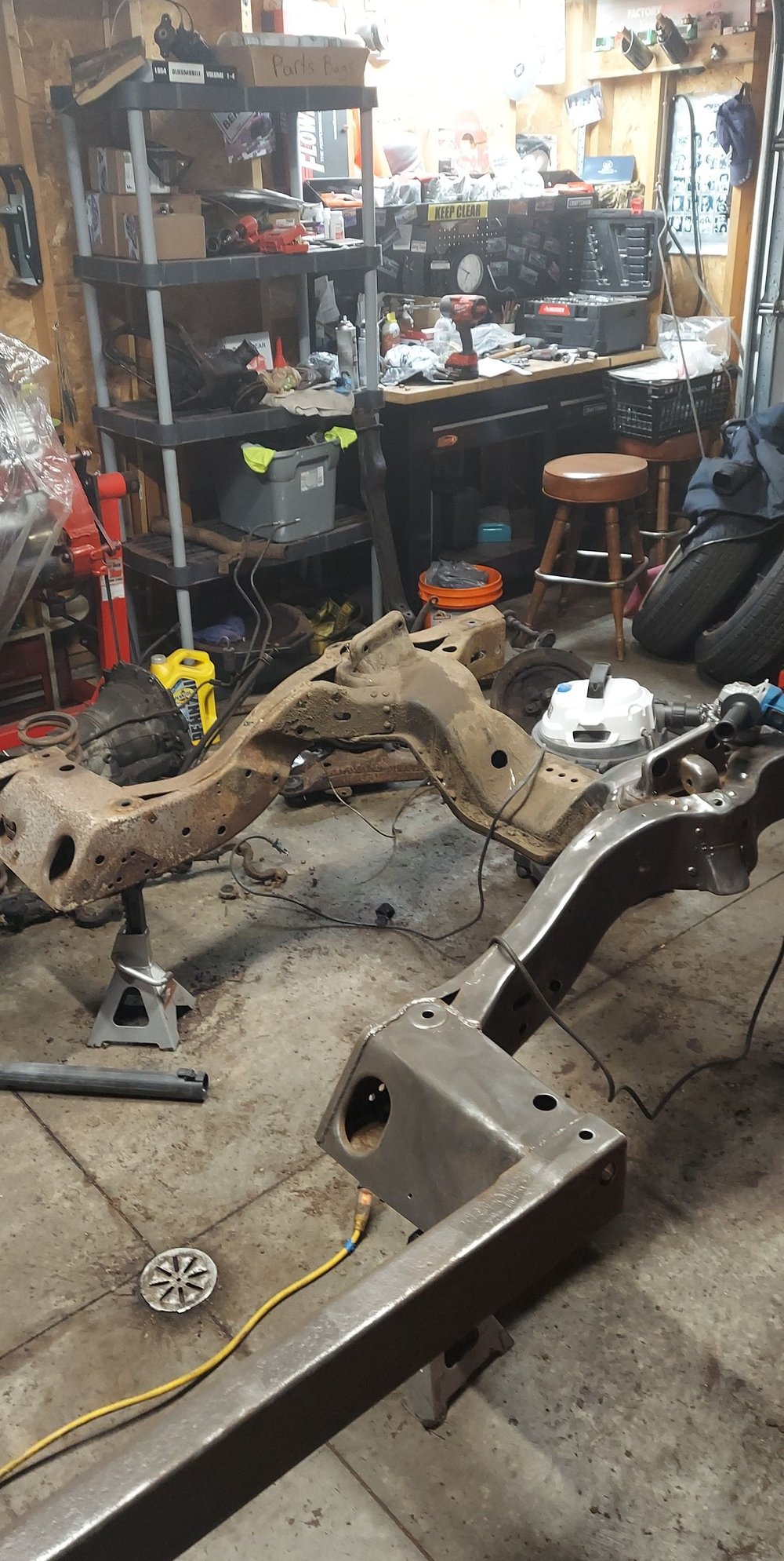

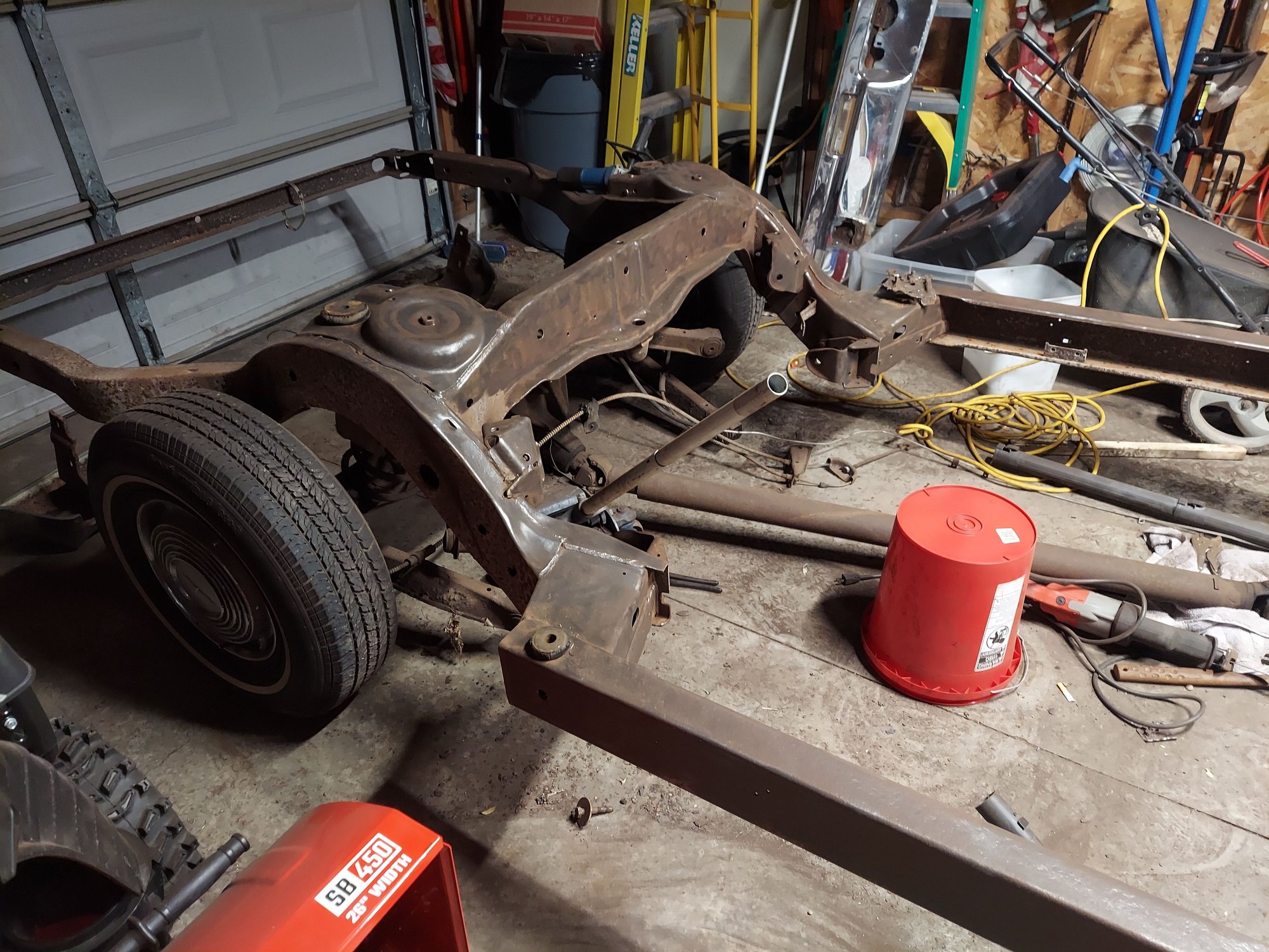

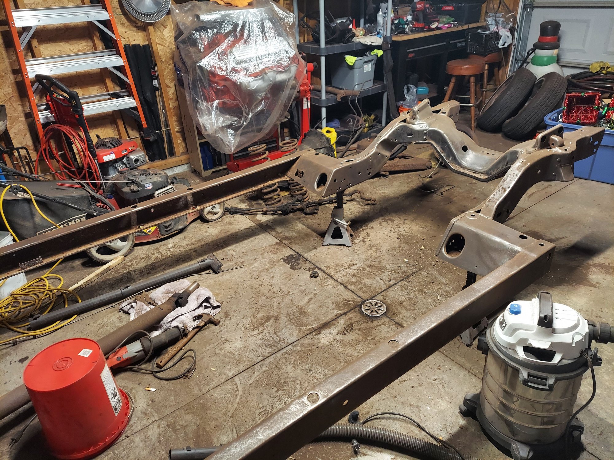

From: Appleton, Wisconsin
Update!
HEY GUYS!!!

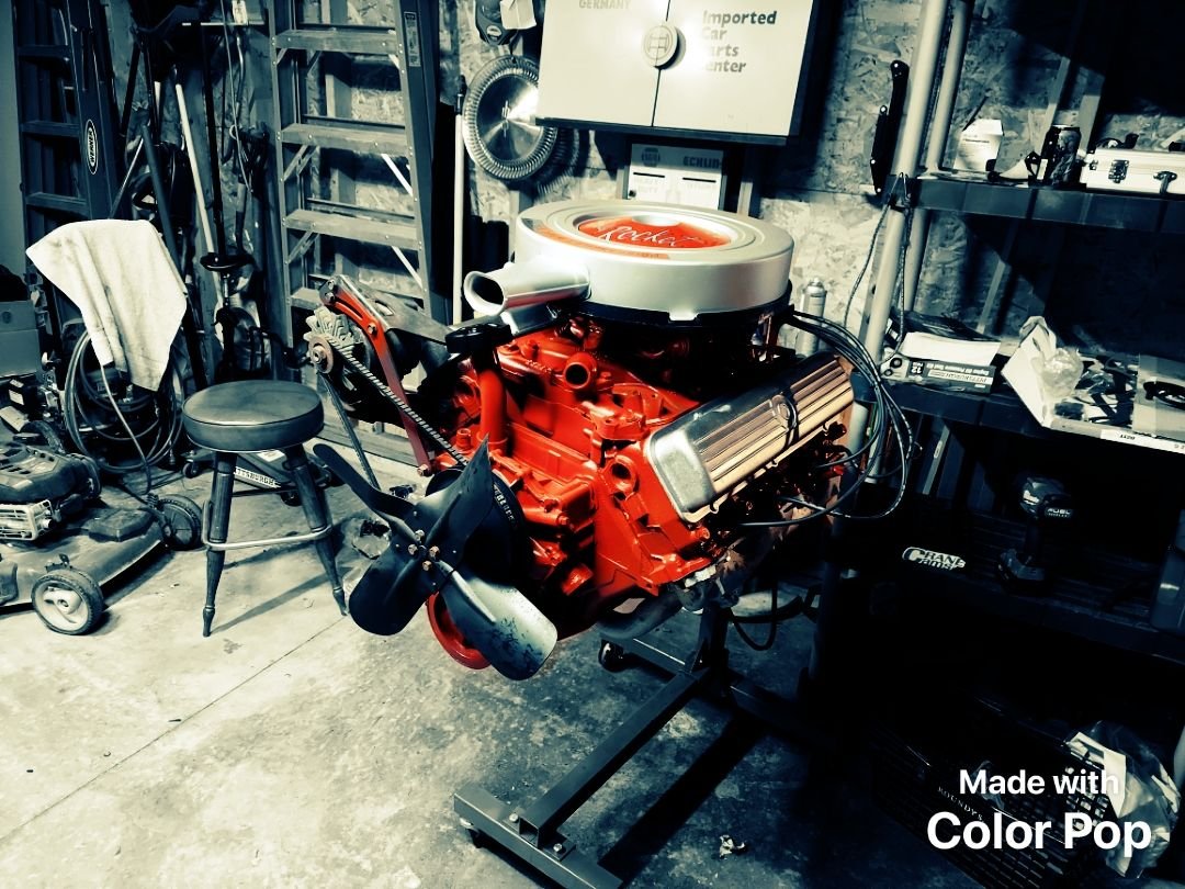

The motor is basically 90% complete. Its looks so nice! Now I have been trying to source a frame for the car since its shot. Please anyone who view this to check out the post I made today about trying to source a frame. The post is labeled Please help! Frame Needed!
here some pics of the motor!
Old Jan 30, 2022 | 07:24 PM
  #159
64Guy's Avatar
Alex
Joined: Oct 2020
Posts: 173
Talking Update guys!!!

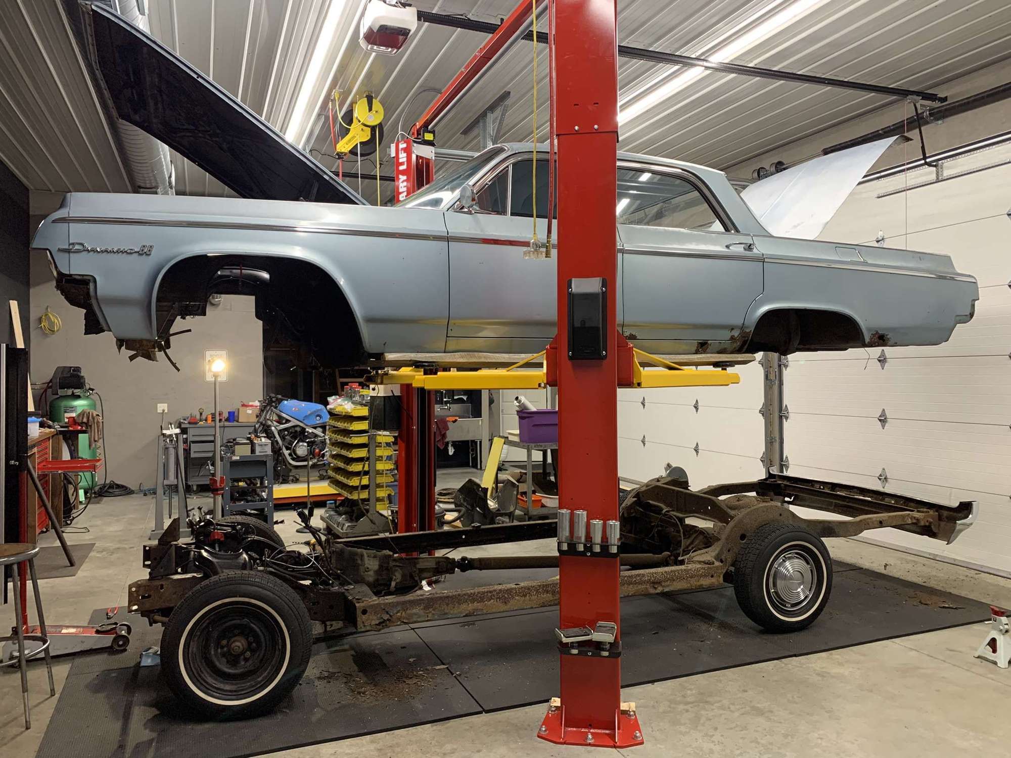

Hi Everyone! After many months of calling, texting and transport issues, I managed to acquire a 63 Starfire frame which had no holes! jhoppeolds, had this frame from his 63 2 door hardtop Starfire that had basically no floor since the back window was broken for a very long time. Rain water ate through the floor but keep the frame alive. After looking at some documents and some specifications, this frame I believe is 95% identical. The 5% being that the parking brake mounts are different and the bolt holes for the rear trailing arms are a little smaller. Right now Im grinding off most of the rust, then prepping the frame for POR. (I thought about sand blasting and acid dipping, but I'm not going for a show room car. just want it to be solid for a long time) After that, its getting a helping of new upper and lower ball joints and front and rear shocks. Then comes stuff like brakes, brake lines, a diff service, etc.
It looks a little rusty after the angle grinder because there is so much rust dust on it. I'm also not quite done with grinding yet. Gonna get cleaned before primer.
Also watch as the floor becomes a rust wasteland!
Its taking some time but it will be worth it in the end!

Hope the frame works out!
