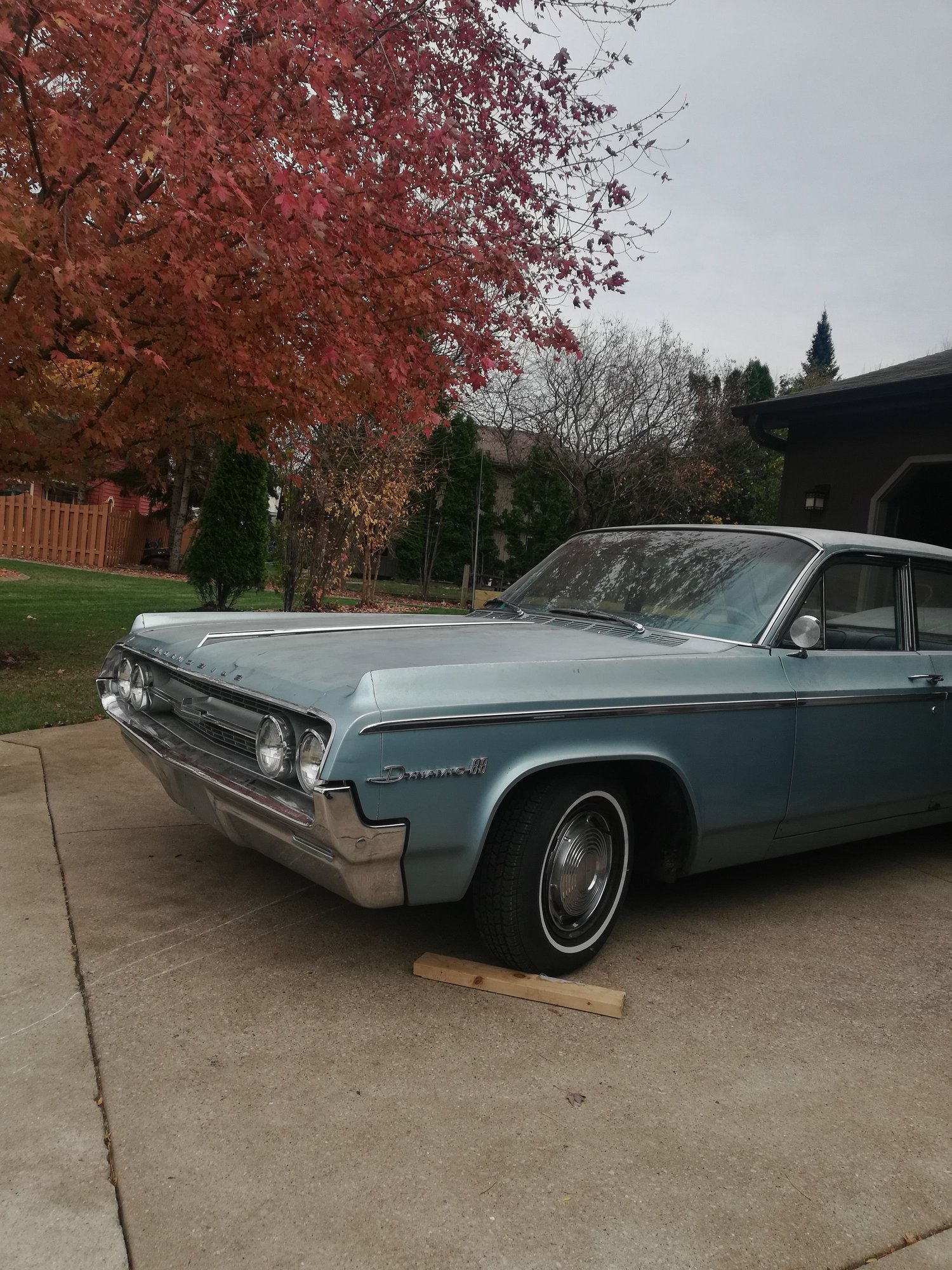

Hello everyone! I just bought a 1964 Oldsmobile Dynamic 88 4 door with the high compression 394 Rocket motor. It has 98K miles. The guy who sold it to me could not get it running for awhile. He sold it to me for cheap. $500. I found the points were junk and replaced it and it fired right up. Over the course of this week iv been trying to get it to idle and run better. Oil pressure is 40 psi when cold. When coming to a stop the car dies. Under hard acceleration the car stalls and just about dies The biggest thing that concerns me is there is quite bit of white smoke from the PCV valve and dip stick tube. Does anyone have suggestions?
Things that have been reminded or replaced:
-Carburetor was completely rebuilt with new Walker gaskets
-Changed oil
-New coil
-Has an electric Edelbrock fuel pump with a regulator (came with it)
Things that I still could do to improve it:
-I bought a timing light to do timing
-Compression test
-New spark plugs
-Changed oil
-New coil
-Compression test
-New spark plugs
Dwell if im right is the gap between the points. I did set it with the thickness of a match book. White smoke seems to increase with temp. I will do a compression test. But i don't think the acceleration issue is related to the blowby. It also almost stalls when changing gears.
White smoke is one of three things:
1) Steam from a head gasket leak
2)Transmission fluid though a SlimJim has no connection to intake to suck it into combustion chamber
3) Brake fluid from a master cylinder leaking into the power booster
Blowby smoke is bluish and comes from worn oil rings or valve guides, or bad valve stem seals. A clogged PCV system can also cause it.
Up front, 394 are notorious for worn valve guides and valve seals esp if they've sat any length of time. How much oil is this engine using? Losing coolant?
Tune it properly to get 30 degrees of dwell, then set timing at 2.5 degrees BEFORE top dead center to start. Doubt that engine would tolerate the recommended 5 deg on currently available premium fuels.
Stalling between shifts is not unusual on a SlimJim if it has sat a while. Usually worse on first shift as there's a big ratio spread there. SJ performance is also tied to engine performance and some critical throttle linkage adjustments.
