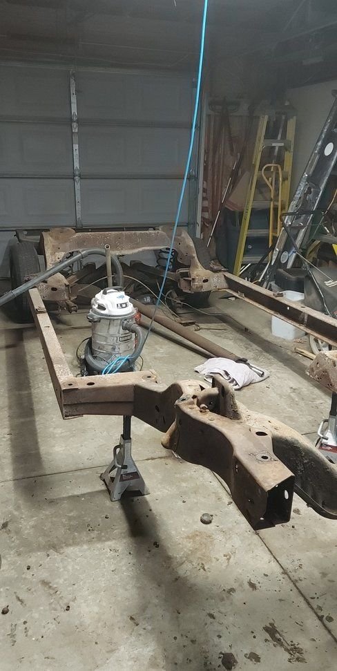

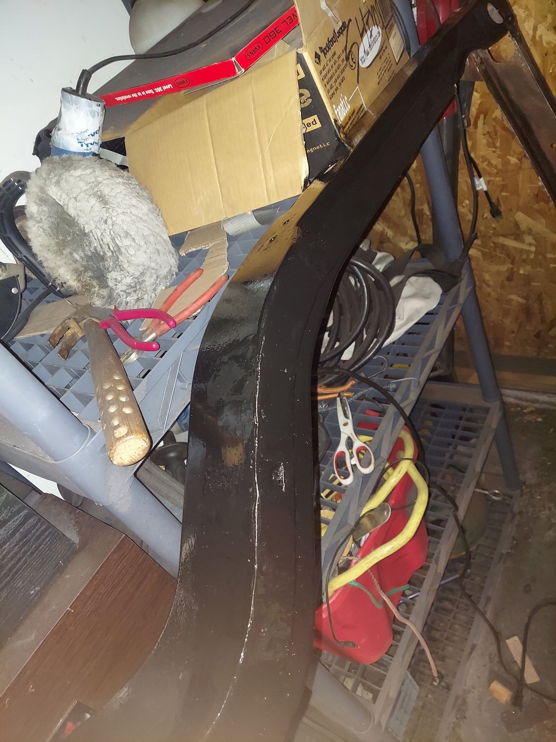

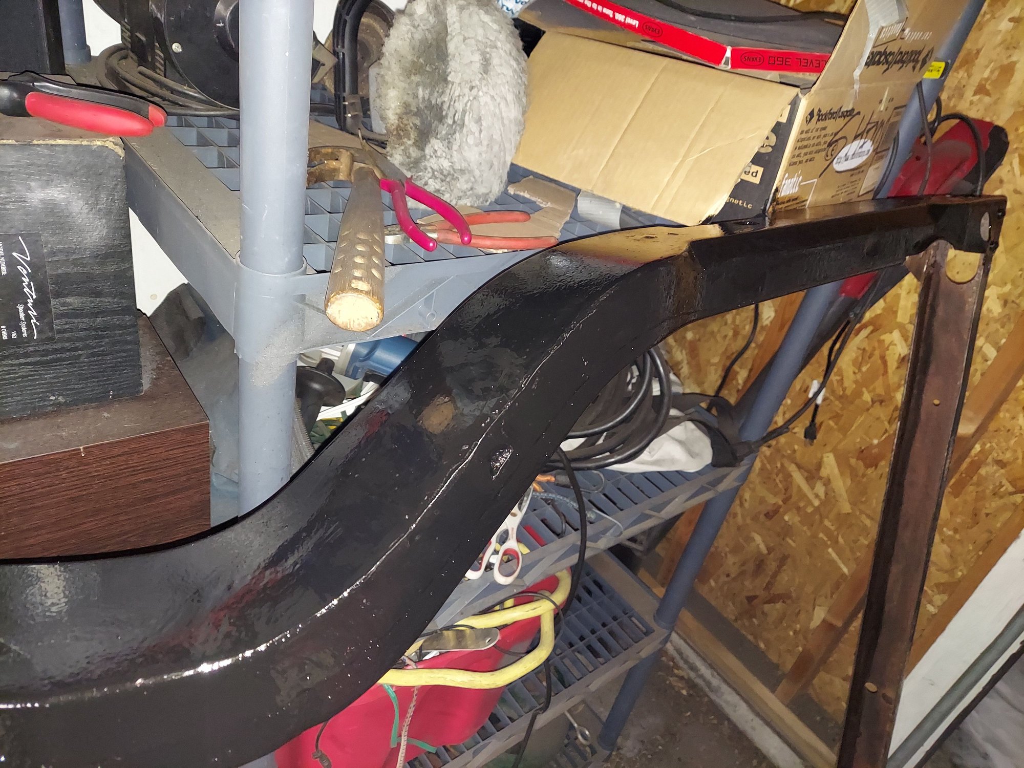

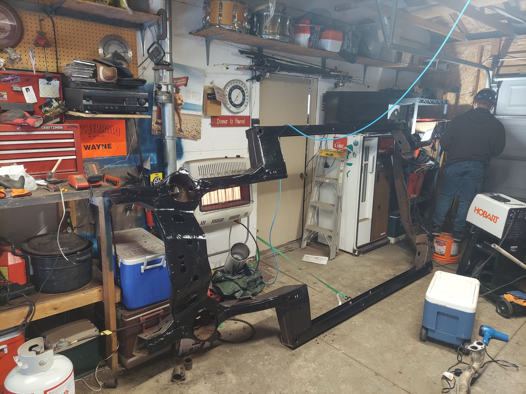

Frame Is getting closer
Hey guys!
After a week of work, help from a good friend and some problems that kept happening, the frame holes were properly welded and sealed!
I'm really happy with the results
Just gotta keep Finishing the POR-15, then it's time for suspension!

Very impressive work there.

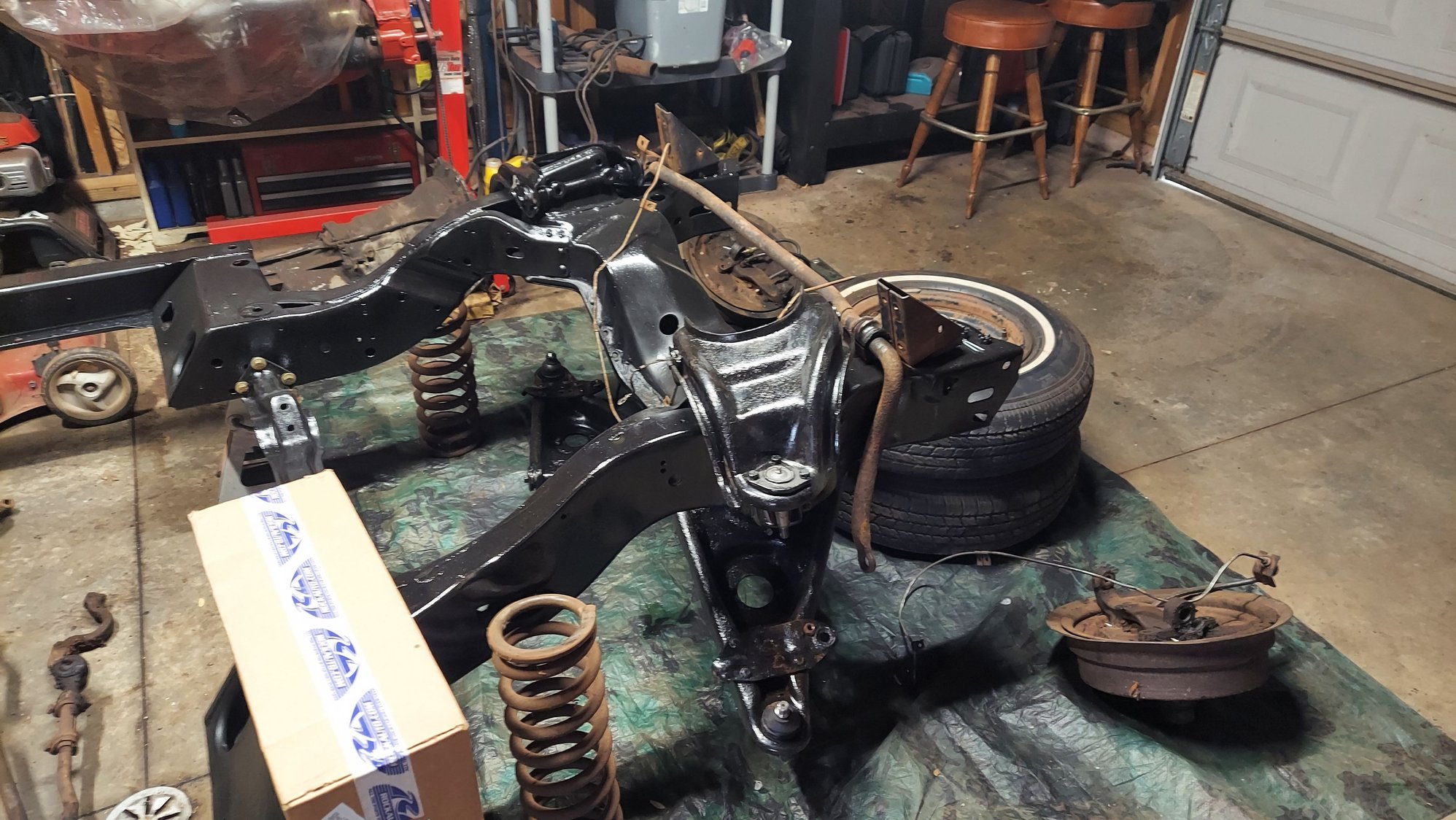

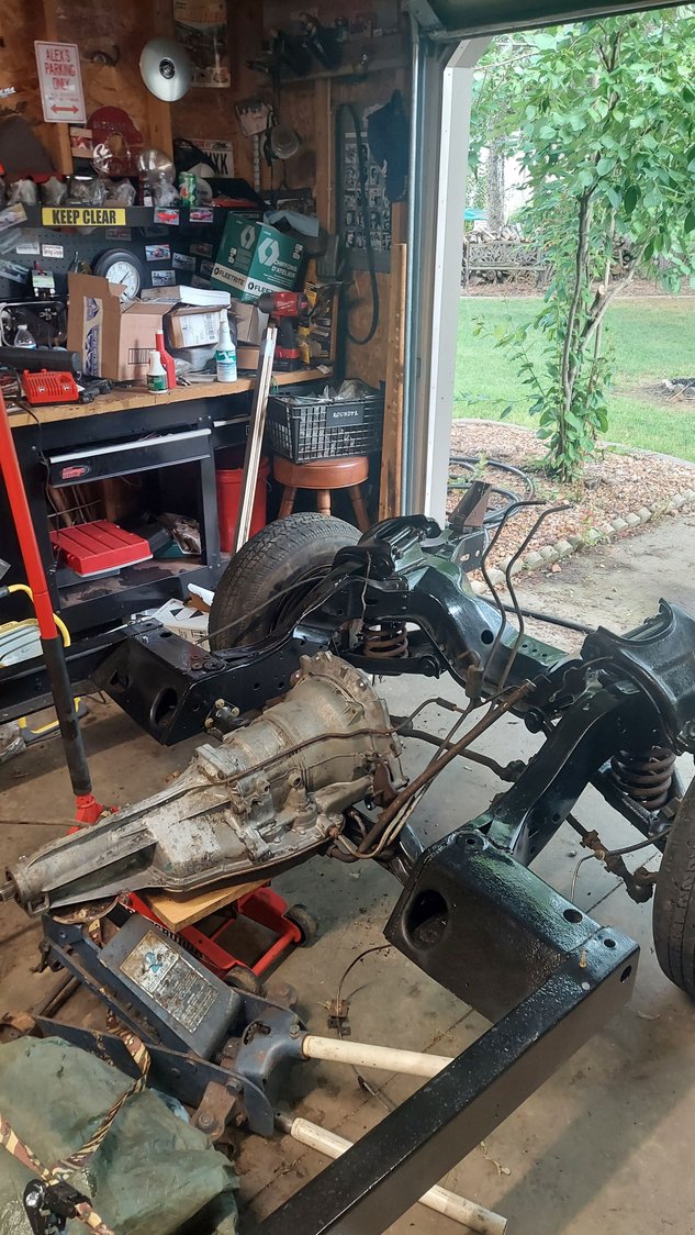

Talking Frame has been full prepped!
Hey guys. The frame has now been fully painted! I also sprayed cavity wax and sealer in areas that were accessible inside the frame. The trans cross member was also cleaned and painted with new bolts The rear end has had a helping of a diff service and new rear shocks, it has also has been painted.
Now comes the time comes for suspension. I had the control arms sent to a local shop for cleaning. I did new lower and upper ball joints. I think at this point and time I'm going to forgo control arms bushings. There way to expensive and i can make due with them for a few years before replacement. A friend is coming over on Friday with a spring compressor to put the front springs in.
I gotta say this is one hell of a project but every bolt gets me more excited to have it done.
Thanks for the support!
Here are some pictures of progress:

Lookin' good! Nice work there.

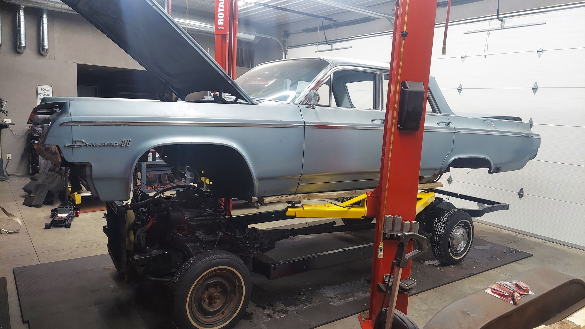

Lightbulb Need some Tips

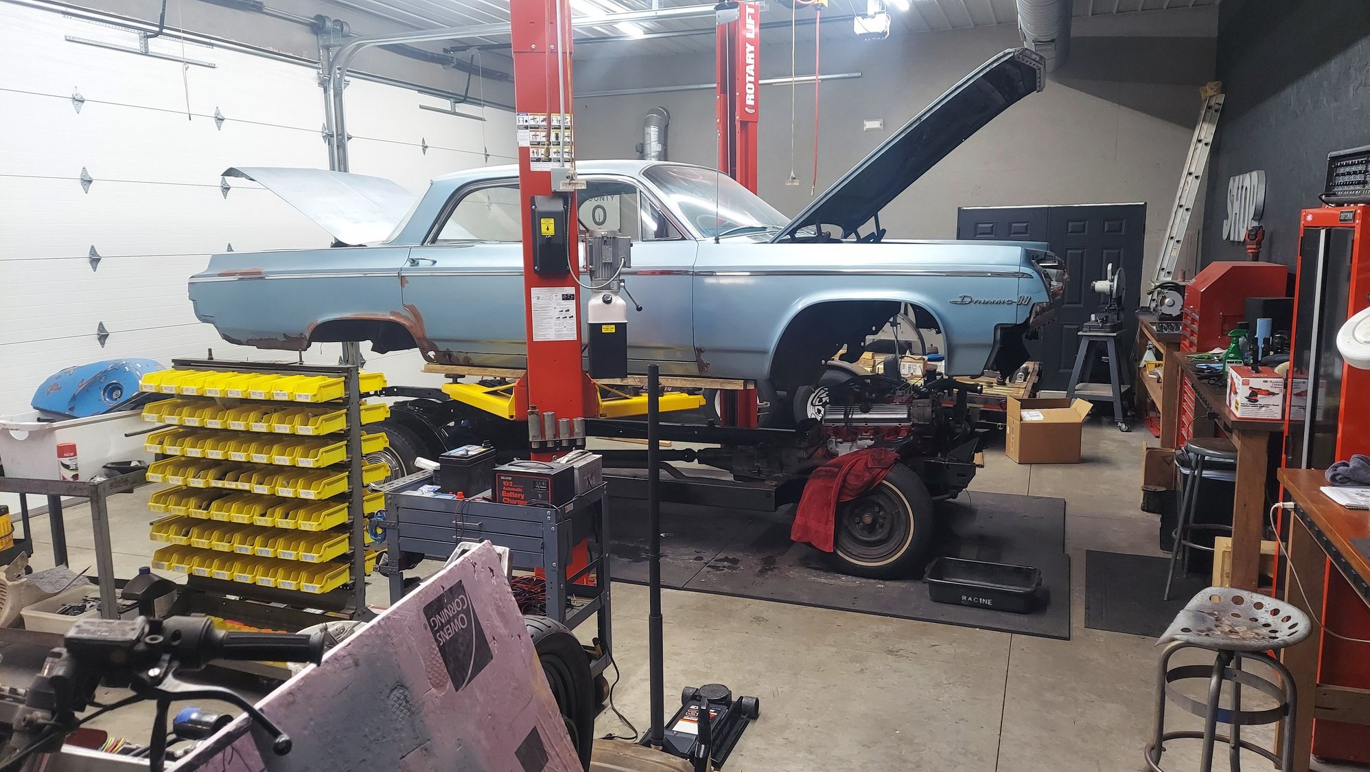

Hello folks! As the Old's gets closer to finally being paired with her body once again I need some tips. We are using a full 2 post rotary lift to set the body back onto the frame. What I don't know is how we are going to align the frame with the body? We were thinking using floor jack to move the frame back and forth until the holes lined up but if there even off a few centimeters, the holes will not line up. Is there a method you guys have used to line up the frame to the body properly? The body is once piece, no sections have been removed.
-Also it was 1 years go today the body came off!
Old Jul 21, 2022 | 02:56 PM

I believe car dolly's would make your job easier, they are available everywhere or some people even make them.
Old Jul 24, 2022 | 08:42 PM
  #176
Charlie Jones's Avatar
Phantom Phixer
Posts: 5,522
From: Apopka, FL
When I put the body back on the frame I used wheel dollies from Harbor Freight on each wheel.
I nudged the chassis around with a crowbar just where I wanted it.
There are two holes in the frame and body near the firewall area that the factory used to align the body to the frame when they "dropped" the body.
A tapered drift can be used in them to get the body in exact alignment.

I used some long bolts with the head cut off, and a slot cut into it, once the body was lined up, unscrew the bolt

One other thing.
Put the engine and exhaust system back in the chassis before you drop the body on.
That will make things much easier.

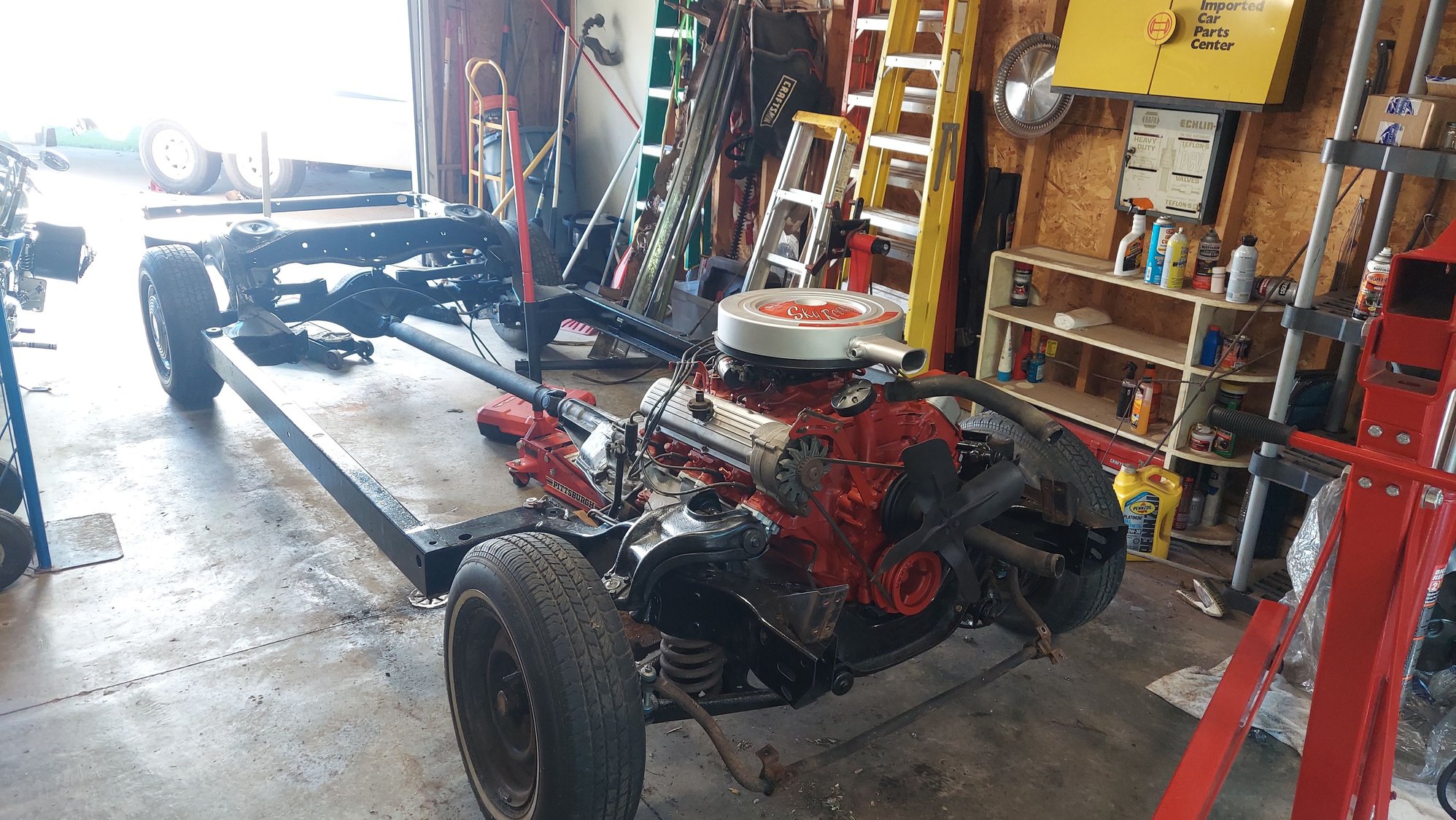

Talking Update and Question:
In 2 month we will be coming up on 2 years since the start of this amazing project. I can finally say the 394 is in her final home! it sort of sucked to get it in the frame since I never knew the clearance from the control arms is so tight, like maybe an inch!

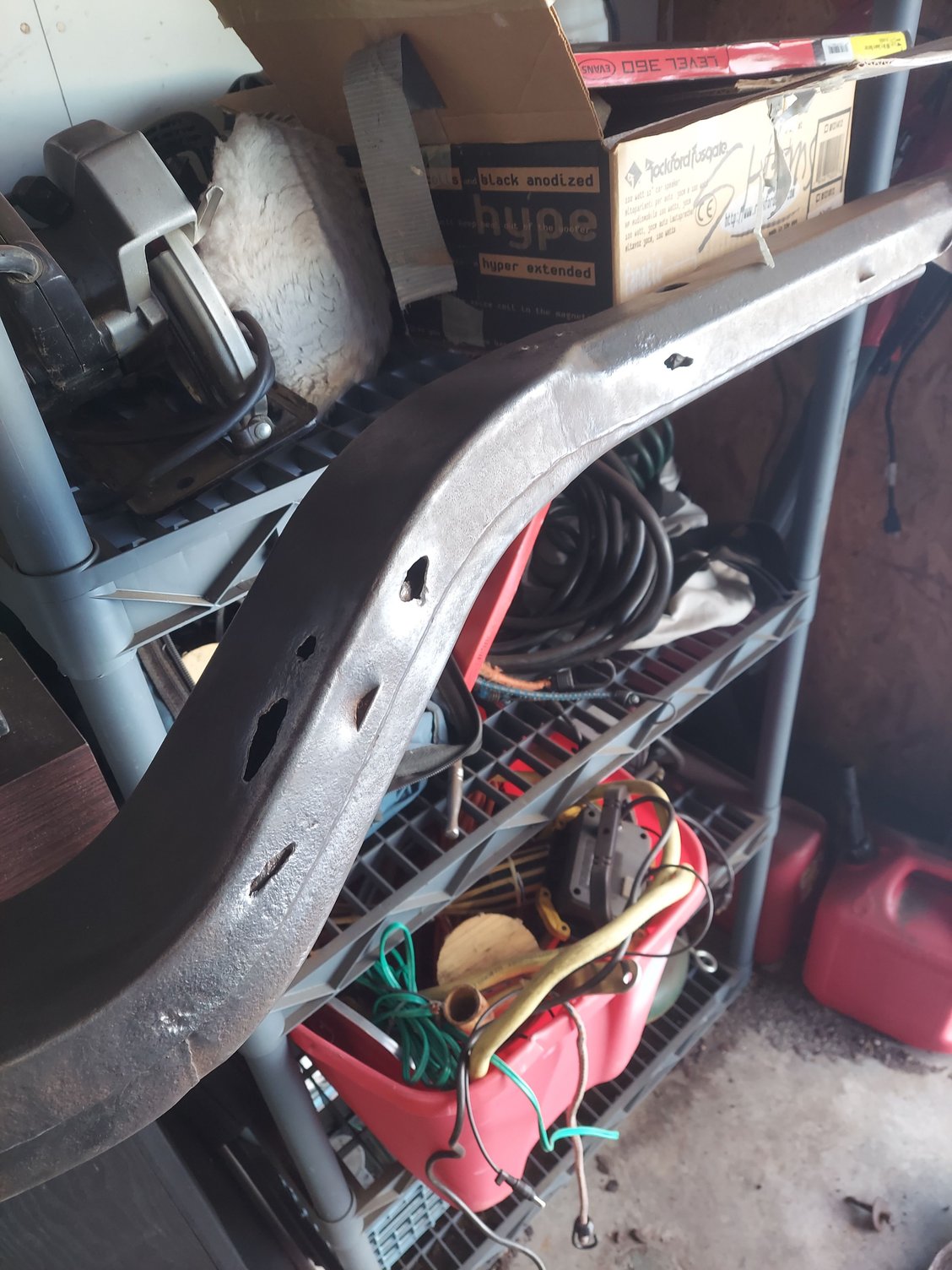

Also on the frame, can the alignment holes be seen in this picture? If so can someone point them out?
These were the holes that the factory used to align the body during the body drop.
You should find corresponding holes in the body.

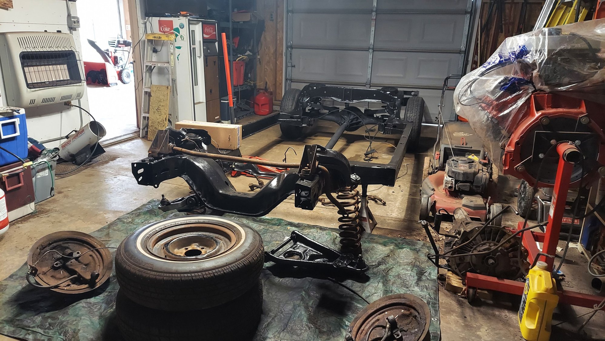

So close!!!!
Im starting to feel like Charle Jones! Were very close to body time. The new brake lines from Inline Tube are comming on Saturday, so iv been tiding up other things that need to be done.
Enjoy a short and some pictures:

You have certainly come a long way. It looks very nice.

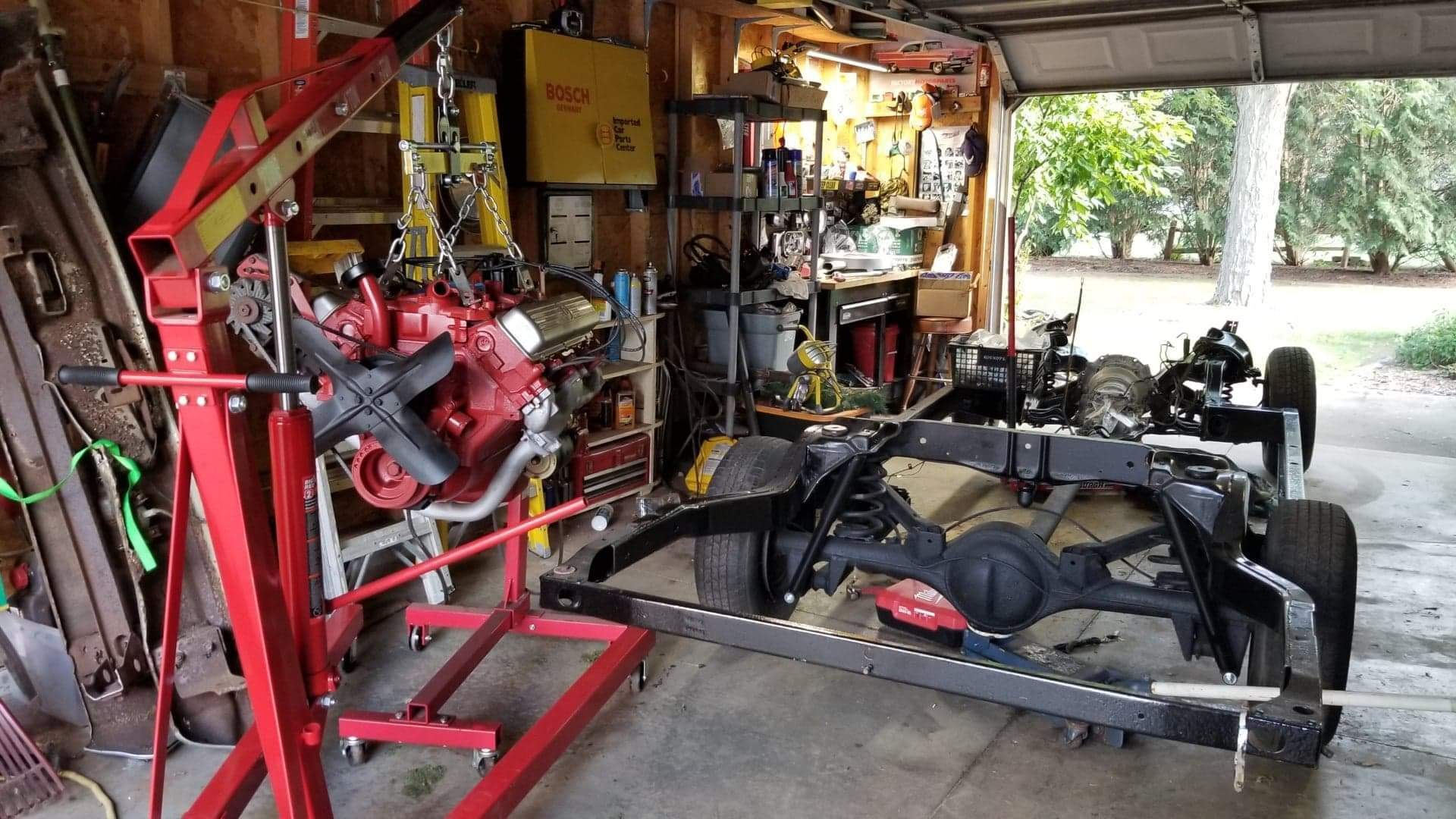

Ready to Run!

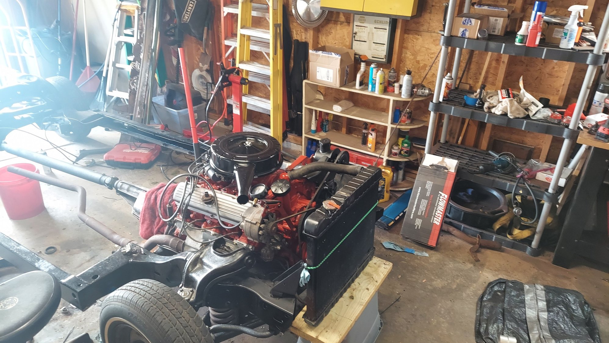

Hey guys! The motor is finally ready to run! I got everything hooked up and just now have to buy some fluids. It was wrong of me to look at some forum posts where some 394s after rebuild have gone terribly wrong!!! One therad i saw is the cam walked out of someones 394, and there was supposed to be a pluger installed on the cam. In my whole rebuild process, i have not seen this "plunger". I made a video eariler in this thread of the play on the cam but it seemed very tight when i installed a new cam gear. Is the only thing keeping it in place really just the cam gear and chain? Im excited but also terrifed of finally running this old beast. Any motor tips or easly missed things would be helpful to know! Thank you and lets get this party started!
Old Sep 23, 2022 | 07:06 PM
  #187
Phantom Phixer
Posts: 5,522
From: Apopka, FL
The camshaft plunger and spring was only used on late 1949 thru 1962 engines.
In the 1963 & 1964 engines the cam gear just bolted on the cam.
DON'T believe everything you see on U-Tube.

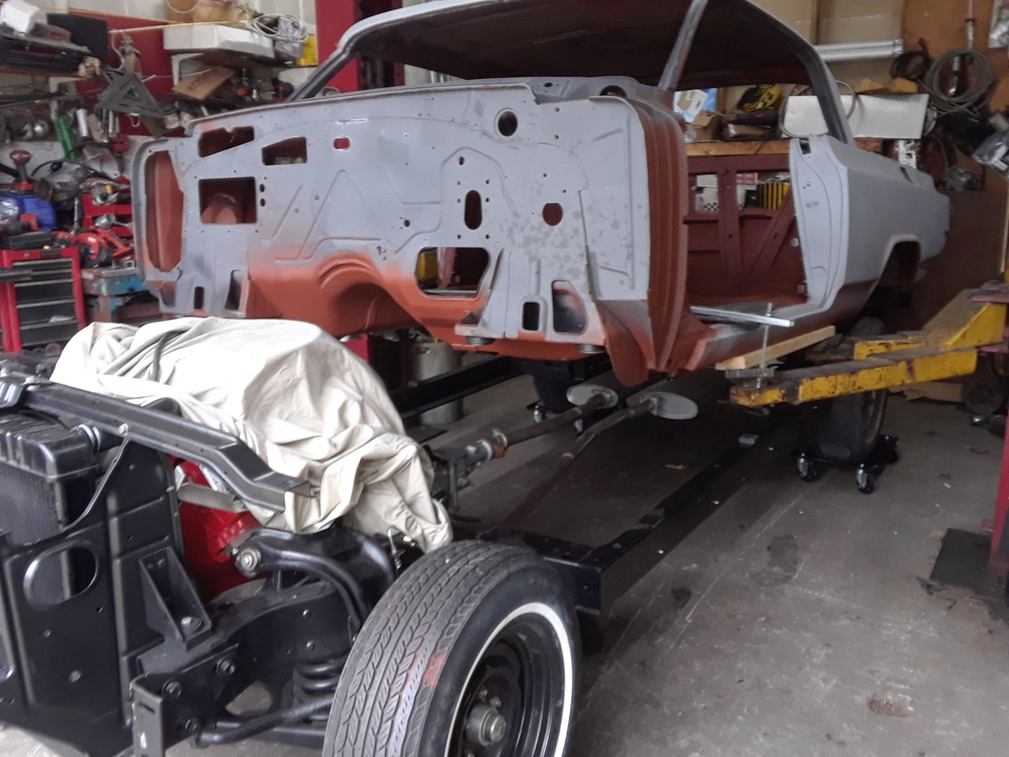

Body back on question?
Hello! Charle Jones could you explain a little more in depth the process of putting the body back on and how to use a Taper Drift? I'm a little nervous to begin this process, we will be using a 2 post lift to lower the body onto the frame. Just lining it up is what I'm mostly concerned since it need to be almost perfect!
Old Sep 25, 2022 | 03:11 PM
  #189
Phantom Phixer
Posts: 5,522
From: Apopka, FL
You will need to get four wheel dollies.
I would let you use mine, but it's a 1500 mile trip.
They are available for $60 per pair from Northern Tool,
Ironton Auto-Wheel Dollies — Pair, 1000-lb. Capacity Each | Northern Tool
Put the body up on the lift. And roll the chassis under it in the approximate place where it will line up.
I used a 6 ' crowbar to nudge the dollies one way or the other to line it up exactly where I wanted it.
I put the upper part of the mounts in the holes in the body.
Then I used a tapered drift about the size of the body bolt to make the final alignment.
I then lowered the body until it almost touched the lower mounts.
Get the left front and right rear bolts installed loosely and the rest of the bolts should drop in pretty easy.
Once you get the bolts in, then lower the body all the way onto the frame and tighten the bolts.

She lives!!!!!
Finally exactly 1 year ago today, I finished the motor and I present to you my running 394! Its got a few leaks but I'll sort those out, I will upload a longer video of us trying to get it started! For now, ENJOY!
-it had around 60 pounds of oil pressure at the start then moved down to 40 as it warmed up
-temps stayed at 160F and did not rise above that
- no smoke out of tailpipe
-it needs alot of tunning becuase it ran a little choppy, i didnt have a feeler gauge so i used a match book to guess the dwell
-i ran 93 octane gas, pretty much the highest we have in the area

You might be able to find a functional dwell tach and timing light or even a Sears engine analyzer at a pawn shop or estate sale.

X2 on the dwell tach.
They are all over E-Bay, and they're cheap.
tach dwell meter: Search Result | eBay
The points can be adjusted with the engine running, to 30 degrees of dwell, with an allen wrench through the little "window" in the distributor cap.
Where did you even find a matchbook?

The Body has Arrived!!!!
After years, countless hours of welding, painting and small details, the Oldsmobile is once more a car!! I will have plenty more questions and issues to solve but for now, thank you all for the help along the way. This would have never been possible
Old Jan 29, 2023 | 03:15 PM
  #197
Phantom Phixer
Posts: 5,522
From: Apopka, FL
Congratulations!
Did the body mounts bolt up OK?

Red face
Yep and all torqued to spec! Do you by chance know what size the steering coupler bolt is? It is the bolt that pitches the steering coupler joint to the steering gear. I lost the bolt and can't seem to figure out the size!!!

Good,now we know that 63 & 64 88 & Starfire bodies and frames will swap.
Widens the seach for the next guy with a rusted frame.
The bolt is a specially made bolt . the factory number is 5686553.
Perhaps jhoppeolds or deadds would have a used one.
It fits 59 thru 64 Olds. Also fits Chevy, Pontiac , and Buick
