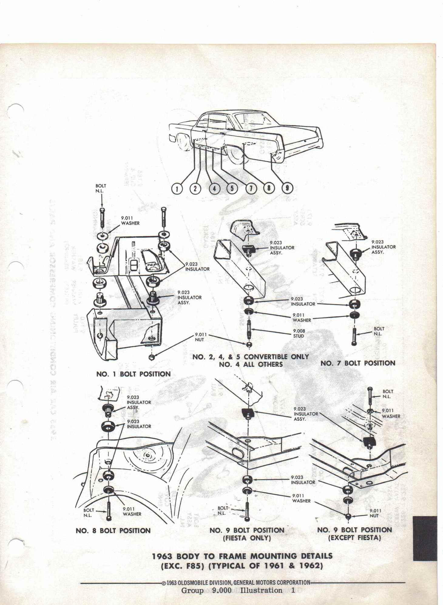

Does anyone know where I am able to find body mount bushings for my 63 olds? I have done quite a bit of research with no luck. Is there another vehicle with similar mounts that would work such as buick or pontiac?

There are body mounts available , but you have to go outside the box .
Positions 1 & 8 can use a 1966 Toronado mount . You will need six . They are available from Steele Rubber ;
Steele Rubber Products - Body Mounting Pad | Classic Restoration | Steele Rubber Products
The rest of the mounts can be obtained from Ames Performance Engineering , a Pontiac company .They list mounts by dimension .
On page 270 .
8.125X10.5 (amesperf.com)
I've got to look at the car again to tell you for sure which ones go where .
I'm going to the shop tomorrow and I will let you know which ones go where .

OK , I had a look at what I had , and I can tell you this ;
You will need to order the following from Ames Performance ;
Four #PS413 mounts for positions #4 & #9 .
Two # PS412 mounts for position #7 .
Two # PS411 mounts for the radiator support . You will need a shorter bolt with this mount .
I've got the body back on the frame and everything fits .

That really is looking nice. And Charlie, aren't convertibles different? (Not to mention mine is a '64, but I'm guessing '63 & '64 would be the same, all other things being the same.)
Some of these cushions I see online say "Except Conv."
Also, is the one that needs a shorter bolt thinner than the factory one?
Thanks.....
Old May 14, 2021 | 07:25 PM
Charlie Jones's Avatar
Phantom Phixer
Posts: 5,526
From: Apopka, FL
Yes , convertibles are different .
They have several extra mounts in the middle of the car . ( positions 2 and 5 in the diagram above )
You would need to measure them and compare with the dimensions in the Ames catalog .
Seems as though 63 and 64 full size cars are the same .
Yes , the radiator mount is slightly shorter on the top cushion . Hence the shorter bolt .
