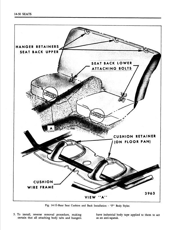

There are hangers at the top of the rear seat back. "Raise" the entire rear seat back until it is free from the rear seat back panel support(s).

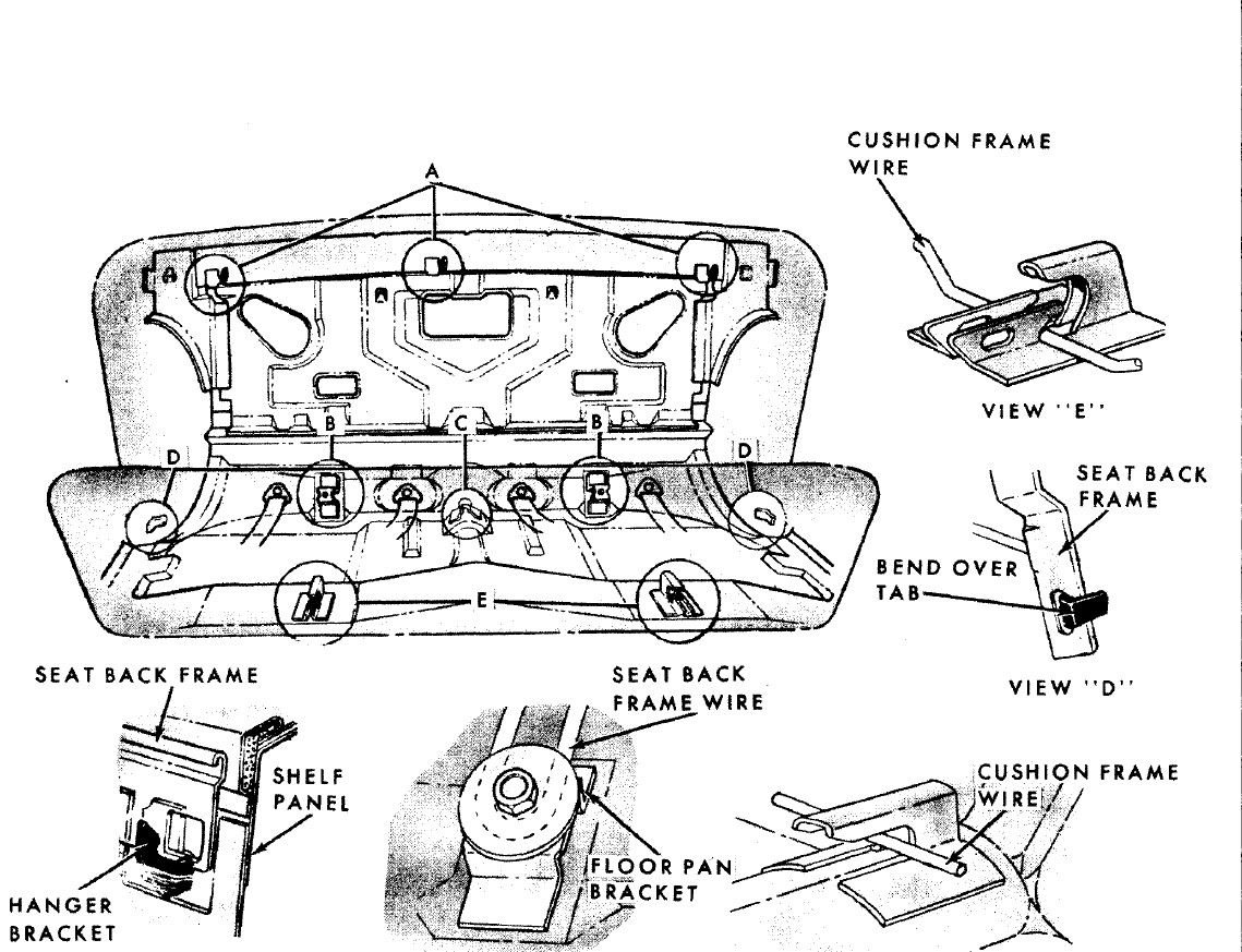

Position(s) "A" are the rear seat back support brackets.

In your description you indicated you removed screws from the bottom of the rear seat back, I believe they're actually bolts. None-the-less, once those two bolts are removed, you'll need to "pull" the bottom of the rear seat back towards yourself so it's clear of the body tabs, at that point all that's left is to "raise" the rear seat back up from the top support brackets. Depending on how many times the rear seat back has been removed in the past 50+ rears, they may have gotten bent (a little), but raise (push) upward to clear the support brackets at the top (A).

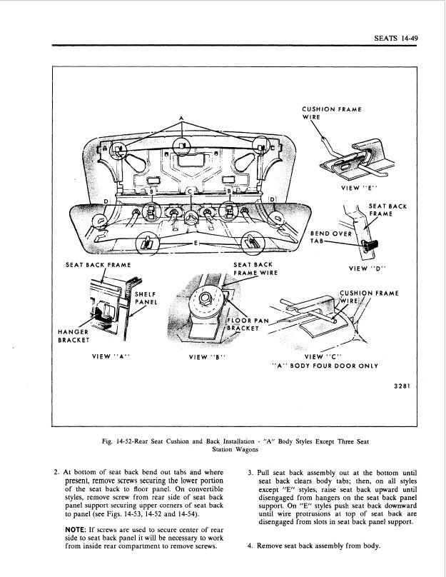

Billy - I'm trying to envision how this may be failing since I've done this many times myself. Here's the full diagrams + instructions. Maybe you'll read something & a light will go off. Using a floor jack is just far, far too much pressure. Maybe the package tray wasn't installed per specifications?
