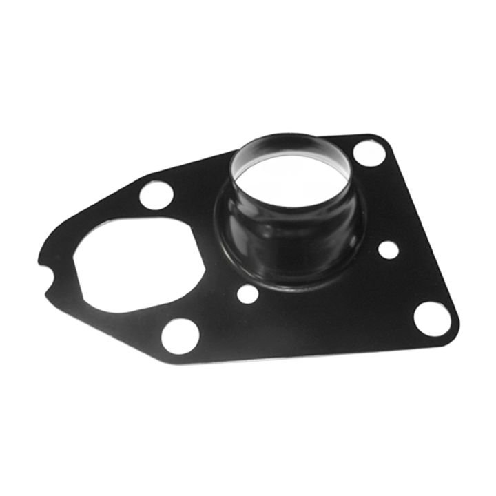

Continuing to sort 66-67 parts collection.
Found different firewall pedal plastic pieces.
All are slightly different. Just wanting to ID application before listing.
Thanks

Firewall plate #2 is 64-66 (rounded below column). #3 is 67 ("triangulated" below column). #1 is from a 68. Obviously 69-72 uses the wide plate pictured at the top left.

To add to a little more information, the reason for the change in 67 was that 64 - 66 simply used a rubber sleeve to support the column in the metal firewall mounting plate. 67 was the first year to use a "split-plate" that clamped the column to the firewall (part of the safety improvements in 67 so that the column would collapse in the event of a front end collision). The lower triangulated section on the plastic cover is there to provide clearence for the lower clamping bolt.
64 - 66 column mounting plate:
67 lower column mounting plate:
