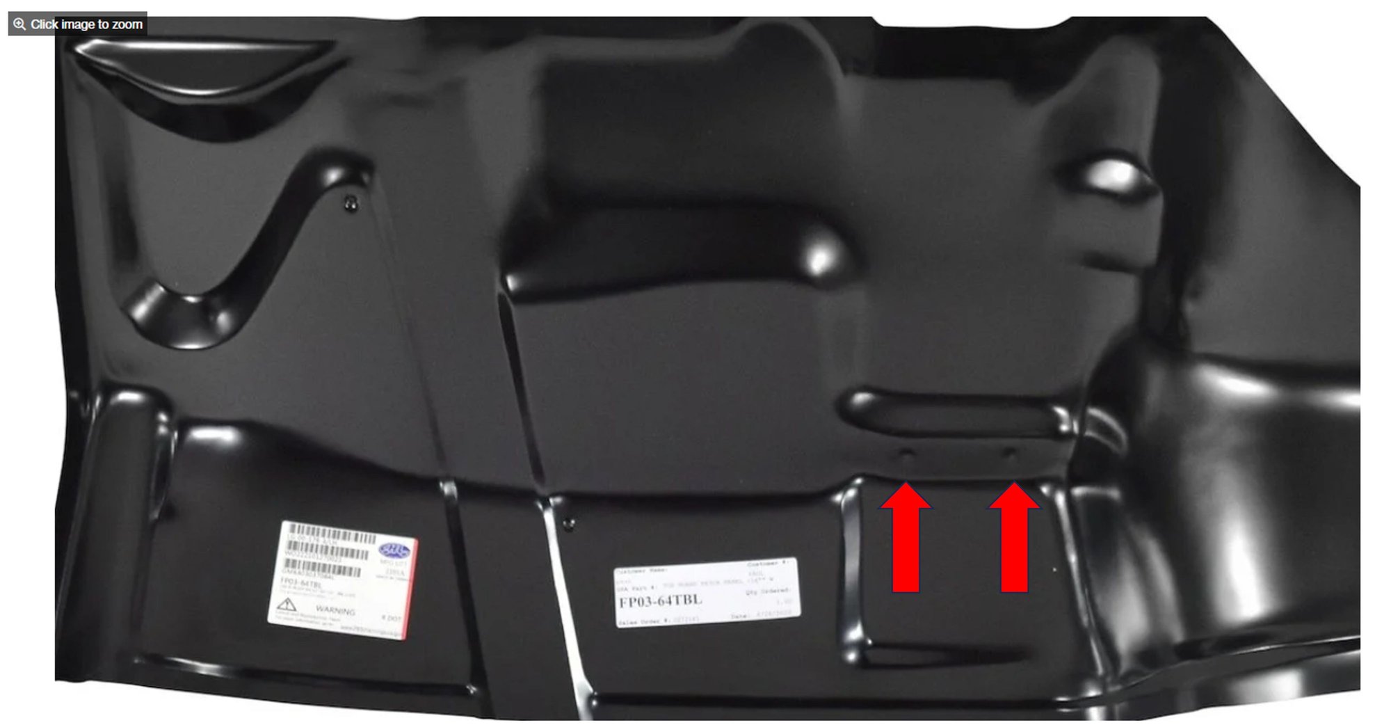

Old Apr 7, 2026 | 03:31 PM
DHawkman's Avatar
Joined: Jan 2025
Posts: 13
From: San Angelo, TX
I ordered it and got it in. No plate attached, just two indentions where it appears the plate goes. Guess I will contact the company and ask them if there was supposed to be a plate. Really disappointed as I hoped to try to install it this coming weekend.
