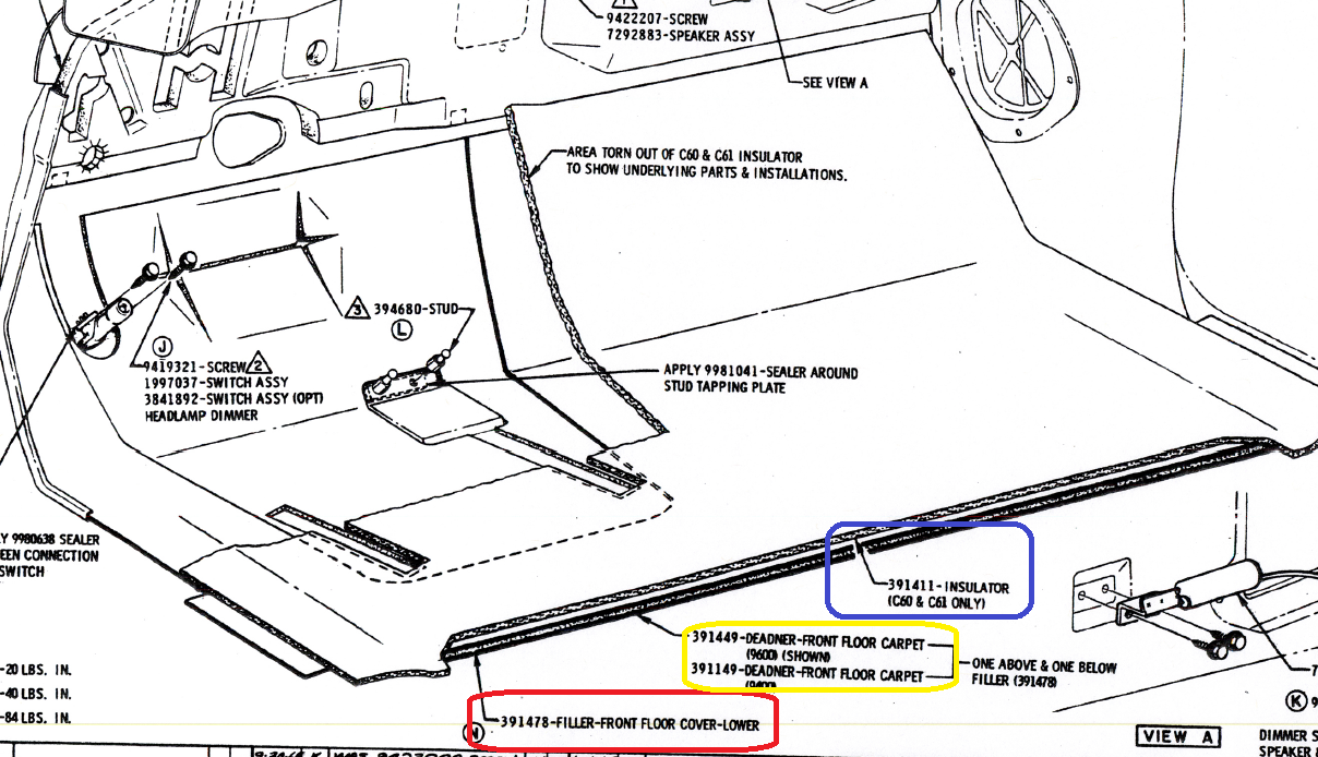

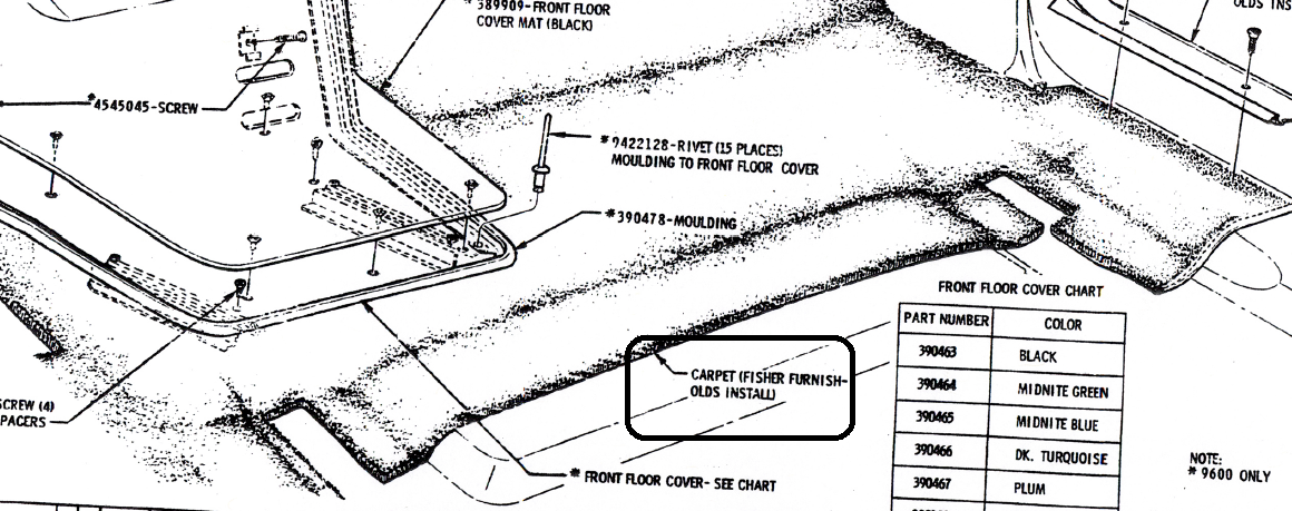

Just looking for a little advice with the potential replacement of the carpet on my '66 Toronado. The stuff in the car is looking pretty rough and I'd like to remove it. The carpet replacement looks straightforward enough but it's the stuff underneath the carpet that I'm curious about. According to the assembly manual there is a "floor cover", a "deadener", and an "insulator" beneath the carpet. Seems like an awful lot of stuff under there! I'm sure the installed stuff is pretty ratty and needs to go. What's everyone putting underneath their carpet when they do a replacement? I don't need mine to be a concourse restoration here, just want to make it enjoyable to sit in and drive.
See my pics below that show the current configuration:

According to the 1966 Dealer Specs book, C60 and C61 are air conditioning options. What you have circled in blue would be for A/C-equipped cars. Does your car have air-conditioning? If so, you would have that layer.
If it were me, I would just put in a layer of some kind of insulation and then the carpet. I wouldn't go nuts on this.
In every car I've ever replaced carpeting on, the underlayment was always in reasonably good shape, so I just put the carpet back on top of that.
Yeah, mine has manual air conditioning. Thanks for the advice! Any suggestions on the type of insulation people like to use?
