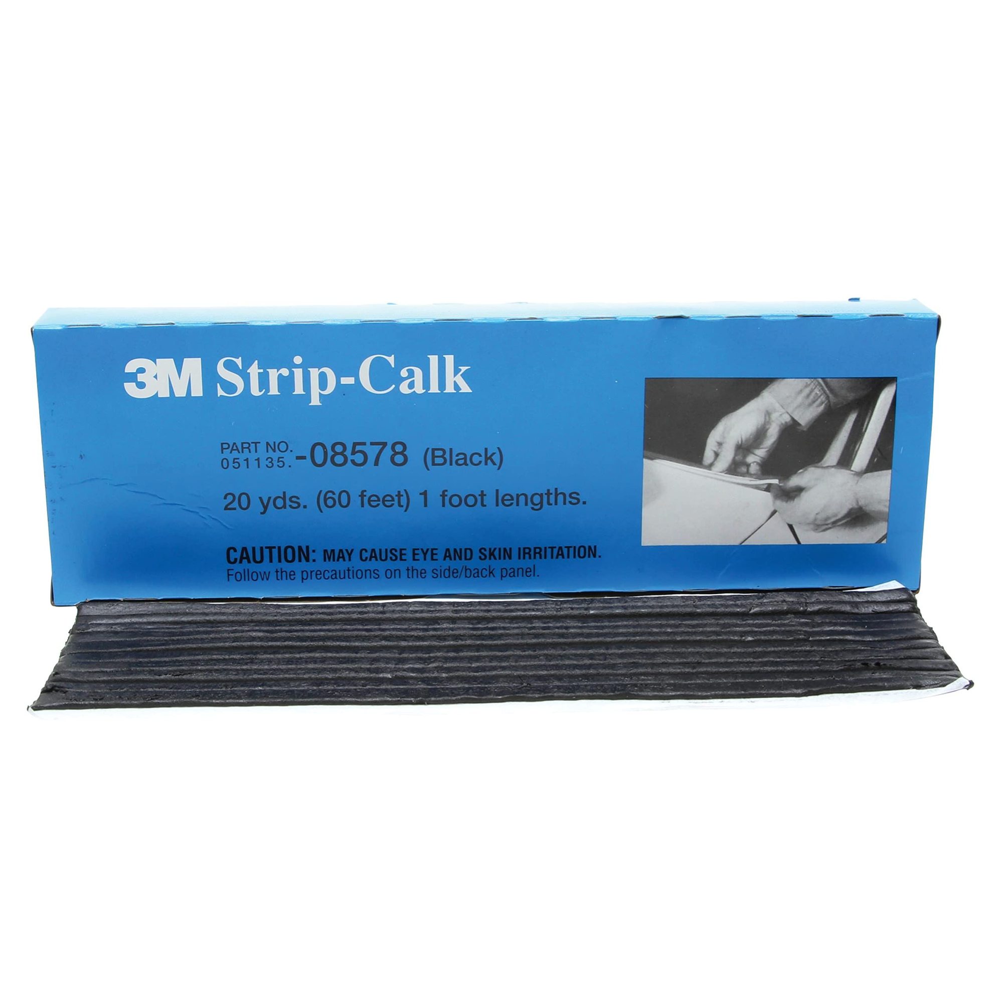

Looking for recommendations on what brand/type of butyl to use to attach the splash sheilds - rope, flat? It looks like the original was a rope, about 1/4" diameter. Car in question is a '71 Vista Cruiser. Thanks!

If you are talking about the door water shields that go behind the door panels, I would suggest 3M strip-caulk.

Thanks, I'll give it a try. I like the 3M products in general, I see the OD of this is about 1/4" whereas other butyl rope is typically 3/8". Not sure it matters a whole lot though...
