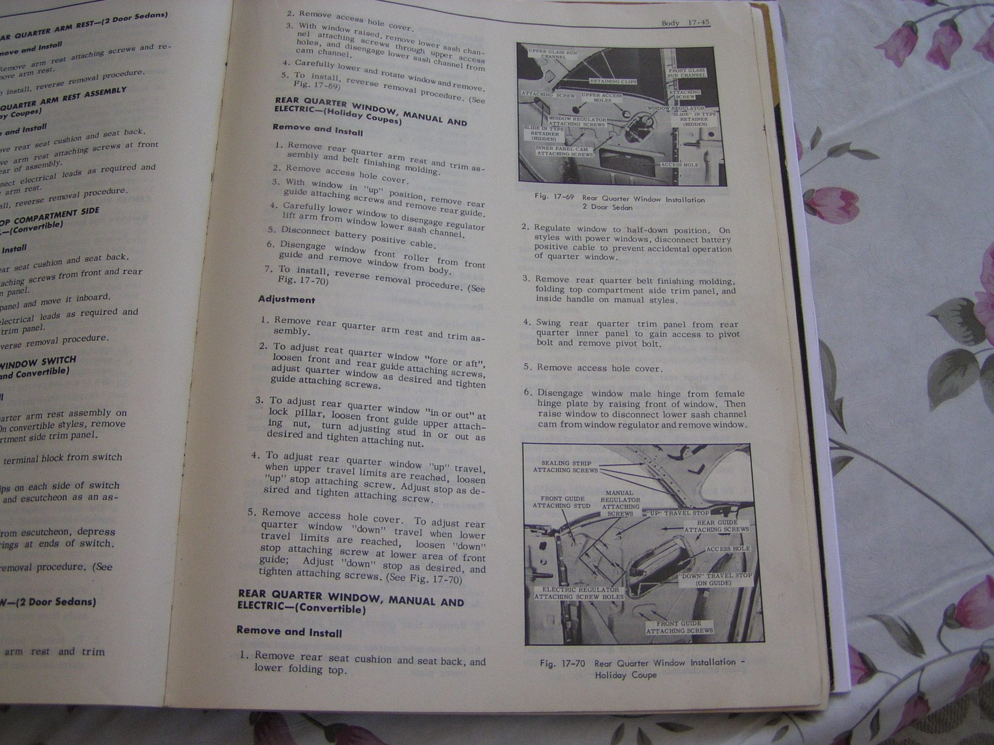

Finally closing up access panel to rear window mechanism and can't figure out where to adjust or locate up stop of window as it closes to far and jams against front window causing problem with door closing - opening. Can anybody who has done this on a 57 98 please fill me in?

Do you have a 57 workshop or service manual? I will look at mine tomorrow and see what i can find.
Old Jun 8, 2022 | 03:34 PM
zzcruzin's Avatar
Joined: Jul 2017
Posts: 272
From: Reseda, Ca.
Does this help? Maybe? Maybe not?
