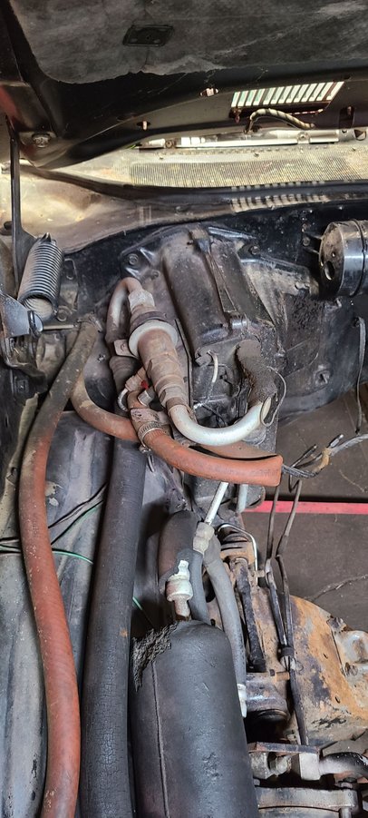

I went out again and looked, the box on the firewall (engine side) looks like it just comes off with a couple bolts. I saw where there are studs sticking through from the interior side, and the speed nuts on the engine side. Of the 2 studs I saw easily, one was missing a nut already. I know the car was apart once already during its lifetime, so maybe they just forgot to put it back on?
Also, do I need to discharge the refrigerant when removing the box?

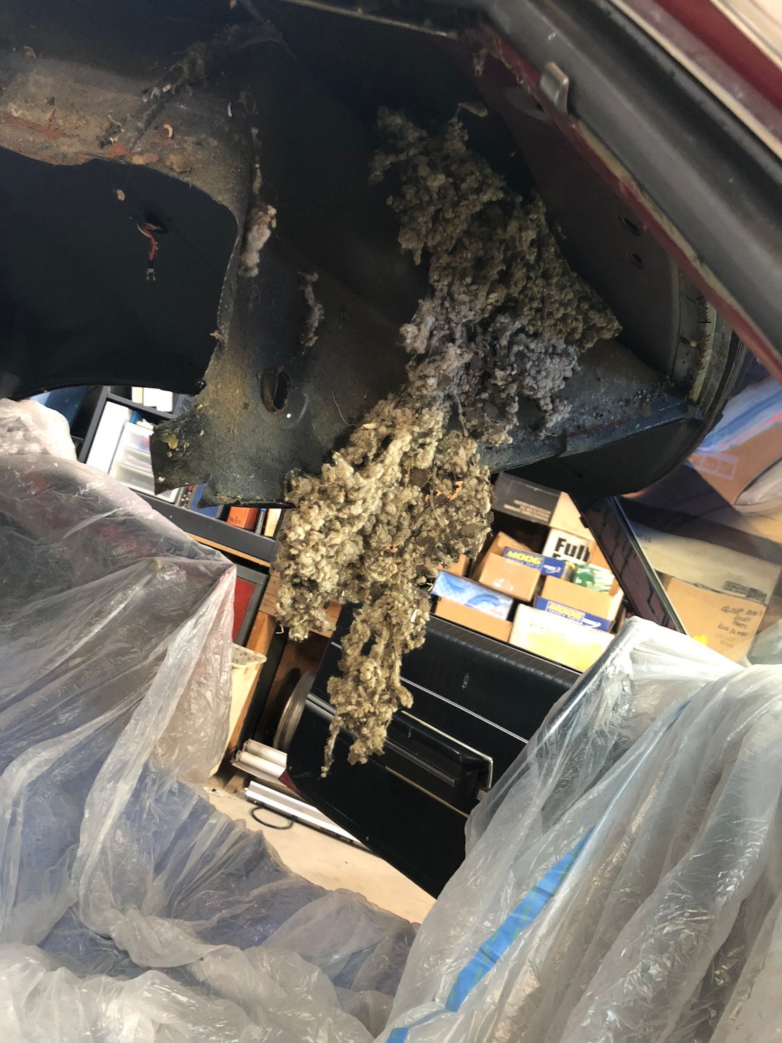

As everyone here has mentioned, they get EVERYWHERE inside your car… Behind the kick panels, inside the doors, in the seats, in the glove box, in the channels of the roof, and especially in the headliner!
This photo is from a car that has sat for years, and the odor just made you sick… and you can see why.
I spent hours gutting the inside of this car and cleaning every surface, blowing compressed air thru every possible place inside the roof and the debris that came out of the roof was unbelievable.
it’s a lot of work, but in the end it was worth it. You can sit in the car and it smells clean.
if you haven’t done so yet, drop your headliner…
You may find something like this… Good luck!

Are the inner fenders pliable enough to just unbolt the first couple and pull it out of the way? I've got everything off on the firewall aside from the bolt(s) unreachable due to the inner fender.

I thought I found all the mouse houses in mine, literally stripped the entire interior and trunk and found about 5 and still couldn’t get rid of the smell.
The massive one I found was in the cowl on the drivers side and ran all down the rocker. Had to yank it out with my arm, hood off and then use a hook from a pick set to pull out of the rocker drain…. Ugh 😑
They are gone now

Finally got around to it..and holy smokes that inner fender is a pain. Once I finally got it to move, I got the last bolt..but the box is getting stuck on that inner fender.
Called it a night at that point..Hopefully I can finish removal and start taking it from the inside in the next few days.

Got the box out on the firewall side and saw nothing but turds. Pulled the glove box and found a small nest behind it, along with a bunch more droppings but still no mouse. Went ahead and pulled the box, still nothing but droppings.
I'm going to just go ahead and reassemble and move on at this point. Hopefully the Ozone generator can get rid of the smell (assuming it's just residual at this point.
