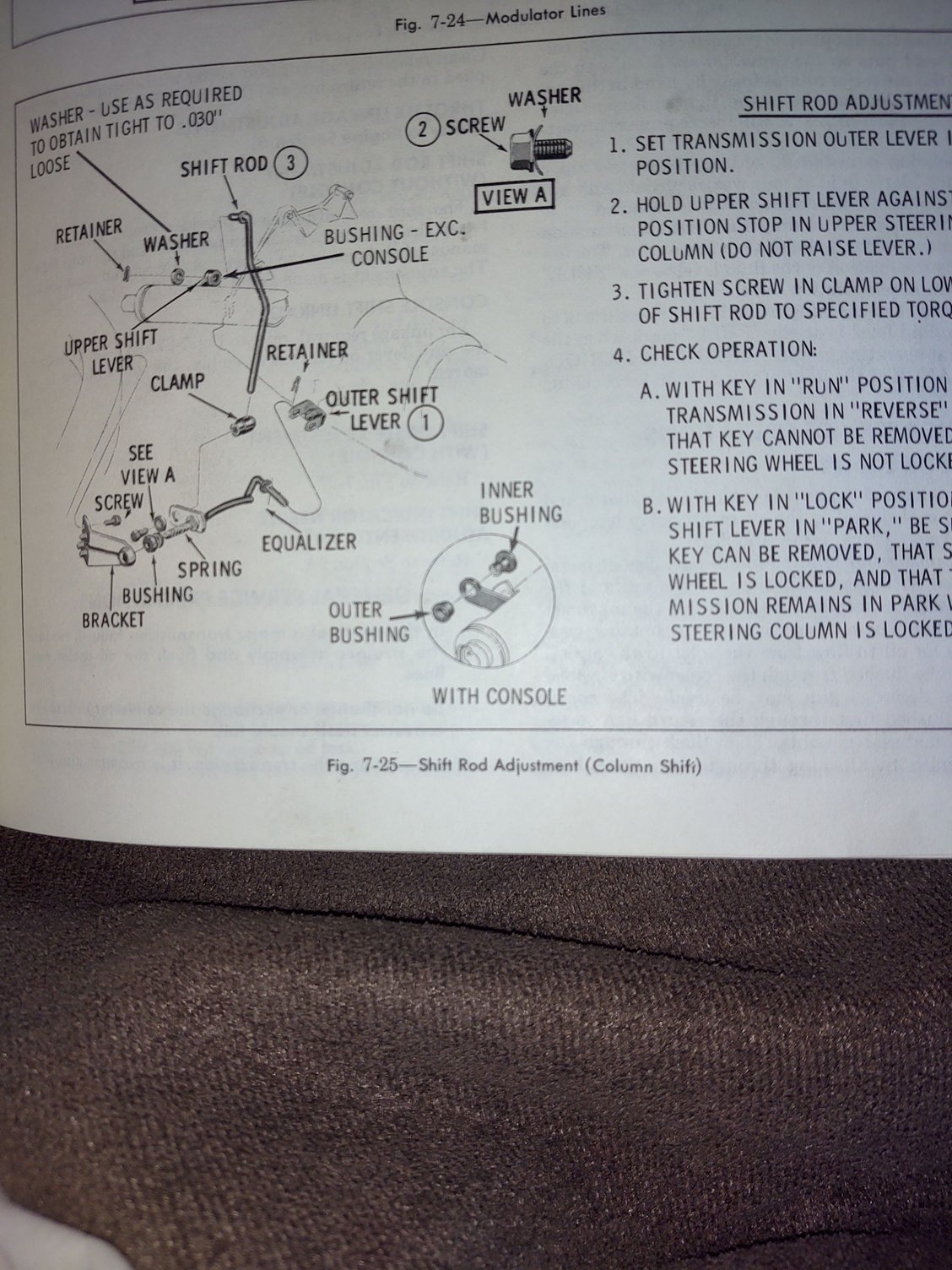

Hey Guys, here is a picture from the Service Manual can't find exact picture in Assembly Manual so I'm kinda lost for part numbers. But I need your help need to rebuild the entire shift linkage assy - NEW BUSHINGS & HARDWARE any ideas as to who would have them? Is there a rebuild KIT for the ENTIRE SHIFT LINKAGE ASSY? bushings look standard Except for the two piece bushings If you know where I can get these for my 69 H/O would much appreciate it Thanks alsmith787@msn.com
Another picture from Service Manual
Section 7, Page 140
