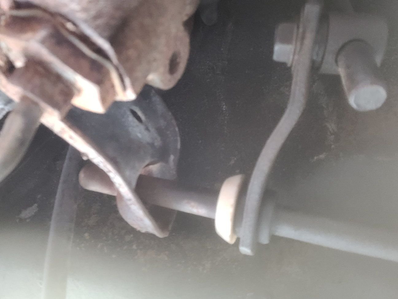

Hello all!
I recently purchased a 66 Ninety Eight. I was poking around underneath the car and noticed a loose shift linkage rod. It looks like some kind of bushing is missing. Picture below for reference.
Does anyone know the part number for this part or where to get it?
Thank you!
-Chris

You may be able to find a working part looking under Chevies, Caddies, Buicks or Pontiacs, but you can gin up something that will work short/medium term from very short length of rubber hose. It won’t rotate as well, but it will give you a little more precision as compared to an empty hole.
If you have a good hardware store nearby, particularly with a big Hillman display, take the frame bracket and rod off the car and go get some rubber parts that will allow the rod to rotate smoothly.
Another way to go is to polish, really polish, that horizontal rotating rod and get a teflon or brass sleeve with a just-slightly-larger inner diameter, the put that whole assembly inside a bushing or secured rubber hose. The idea there is the rod would rotate smoothly inside the metal “bearing” which would be secured in place by the hose. Or bushing.
At the end of the day you want that horizontal rod rotating smoothly inside or with some kind of isolating element which allows the engine/transmission to move just a little independent of the frame to which the bracket is bolted. Look for correct ID (inner diameter) or OD (outer diameter) bushings, plumbing washers, etc. You might have fun getting creative.
There are lots of options, just play around with combinations until you’re happy with the shifter action. And remember they probably weren’t the most precise things from the factory.
Final suggestion for these and the throttle parts - once you have them out, clean & grease them to discover where the wear is, or at least to make the work and look a bit better than they have for 56 years.

Here ya go. And yes, this is the correct kit despite the fact that it is called a "backdrive linkage" kit. The white plastic washer fits into the frame bracket from the trans side, followed by a flat washer and the spring. Then the rod fits into that.

Well... I can confirm that this is NOT the right kit. This kit is for the 2 bolt cupped bracket. The spring keeps the bushing in the cup. Attached below is a picture of the corresponding bracket as well as a diagram showing the bracket.
Here are pictures of my 4 bolt flat bracket. There is no cup for the bushing to sit in. This kit will NOT work with this style bracket. Maybe the vendors and manufacturers didn't list my year because it's not compatible. Who would have thought...
If anyone needs this kit, I have a brand new one available.
-Chris
