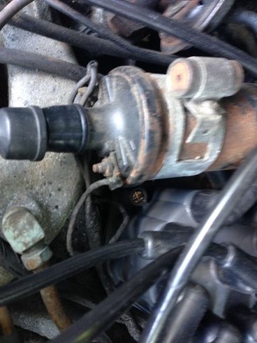

Another odd thing I noticed was that on the old coil there was condensor that had no wire on it:
Now that I know I have a uniset, I have a condenser that I don't need. Would that condenser be the same as what was on the coil? If so, would I connect it to the negative? I read somewhere it helps keep the noise down in the radio.

Don't worry about that condenser on the coil right now/ It was put there to suppress ignition noise in the radio. It served no purpose in the ignition system.
