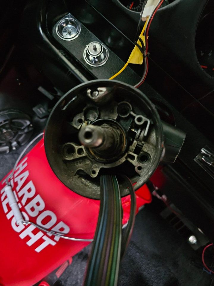

I didn't see a specific section for steering so I'm posting this here. · 69 Cutlass convertible, tilt steering column
· Tried starting the car, turned key.
· No resistance whatsoever, no feeling of accessory position
· Ignition lock rotated all the way to full stop
Reading net articles say 1of4 scenarios:
1. Rack and sector gear might be bad
2. Disconnected or broken actuator rod
3. Ignition switch
4. Worn or failed lock cylinder
Getting the cover off on a tilt steering wheel is not easy, for me.
· Lock bolt was seized inside cover channel. Used deep creep on lock pin and punch and hammer to loosen. Moved pin back inside channel but it did not come out.
· Used rubber mallet to pound on cover and on ignition lock channel and it came off.

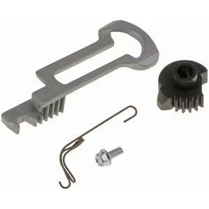

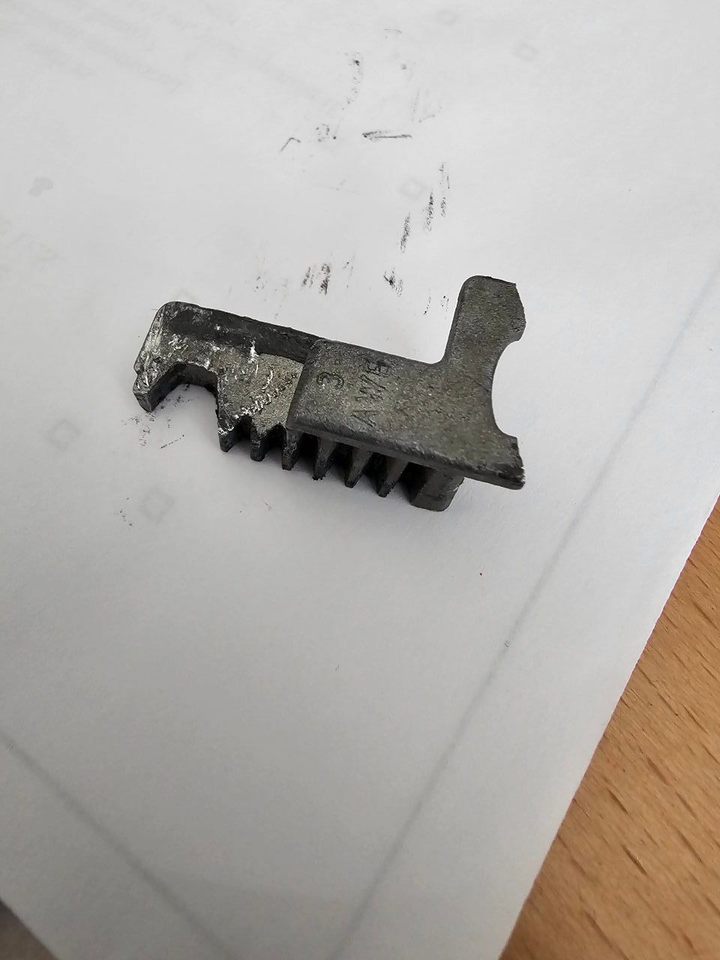

· Cover off reveals a broken rack. Not sure how that happens. Don’t think it was from cover removal because the sector gear is in tact and Start behaviors exhibited symptoms of a disconnected operating rod. The Dorman rack seems 3/16 shorter.
Now I’m just staring at this mess and I’m wondering if I have to take the steering wheel out of the vehicle and totally disassemble it to rebuild or if I can do a replacement with it in the vehicle
Before I got the cover off
Before I took the cover off
Busted rack
Busted rack

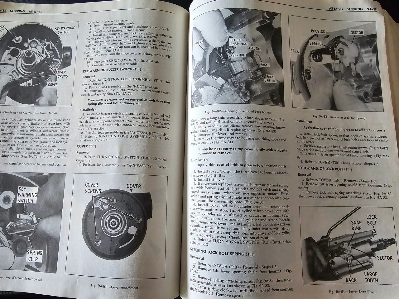

manual
manual
busted rack
Dorman 83211 replacement

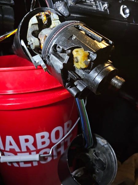

Another big surprise. Unless things are just wildly out of scale, this does not look like the same tilt steering column I have. (As depicted on 9A-33 of the chassis service manual and this picture I took of the current work.) It’s similar, but it looks like the housing should have a long extension where the lock bolt goes. In my particular case there is no housing extension for the lock bolt to go into. Instead, the lock bolt sits in the cover I took off initially. Additionally, there is a hex friction nut on the steering shaft that I don’t have a socket to take off. I’m not sure which tool it is in the service manual on page 9A-70 of the chassis service manual unless it’s the lock nut socket. Again, the chassis service manual does not show a similar nut attached to the steering shaft. High adventure, this car.
Service manual tilt column
This is my steering column. Do I really have 1969 steering column in this thing? Who knows
There's the hex that is not depicted in any of the service manuals
Don't have the right tools so I had to use hammer and drift to lightly tap and slowly unthread. It's not held on with any significant torque as underneath it lies a nylon housing for the bearings.
Here's that nylon hex nut
Not sure if the lock nut socket is the tool that's supposed to get that hex nut off but I don't see depicted in the chassis service manual anywhere
