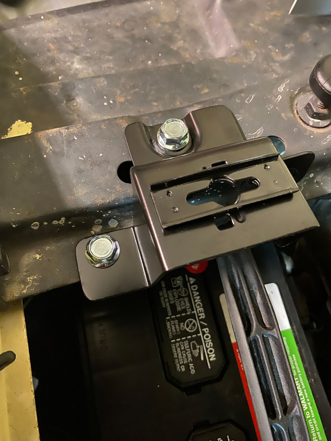

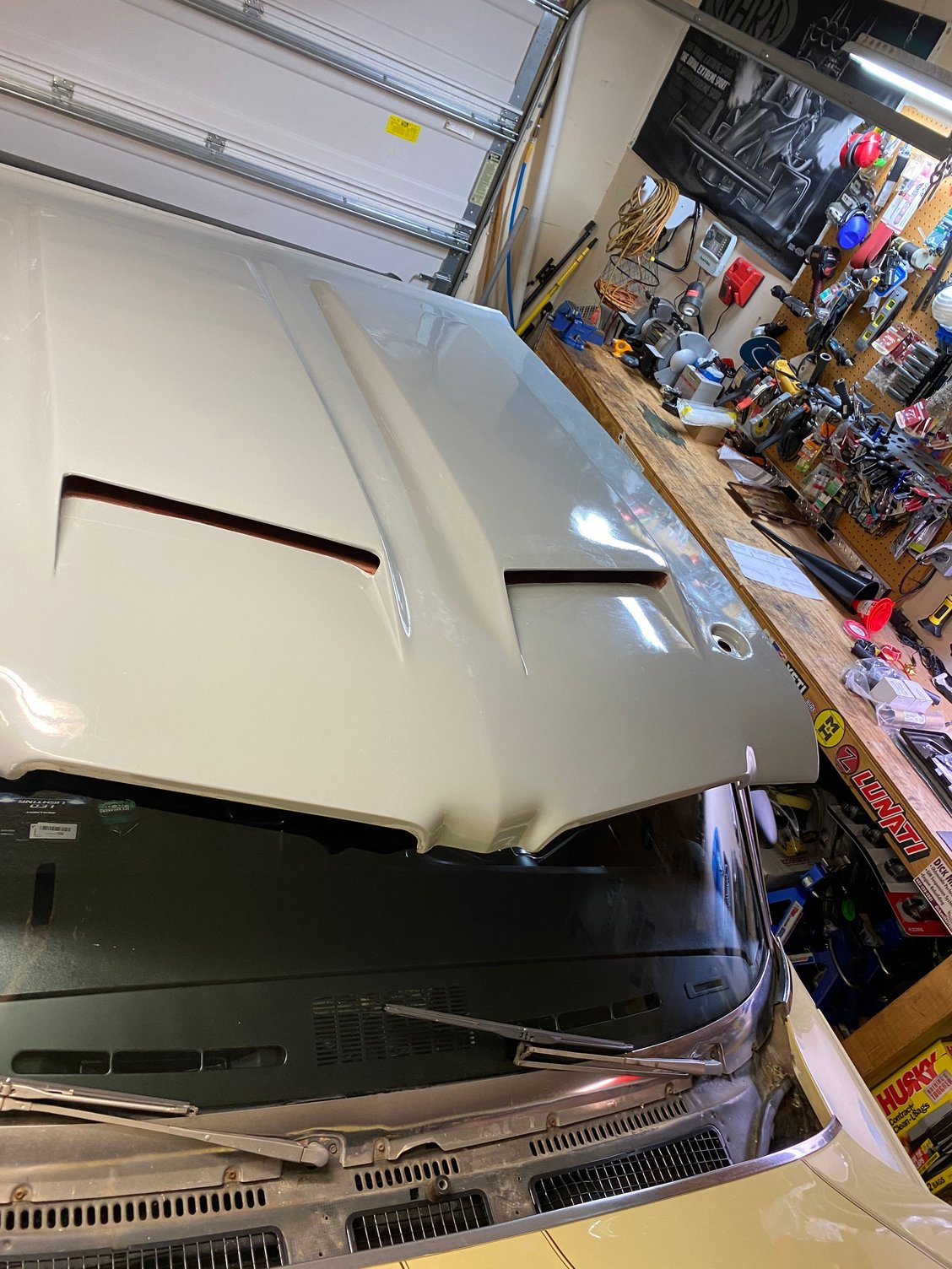

Need some clarification, just purchased my W-25 hood from Stinger Fiberglass (looks great BTW) and I also brought the needed hood latches/locks/springs needed to complete the install on my non w-25 car.

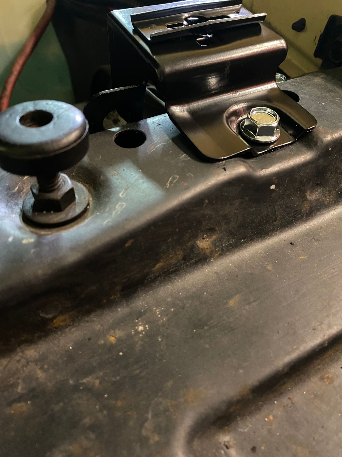

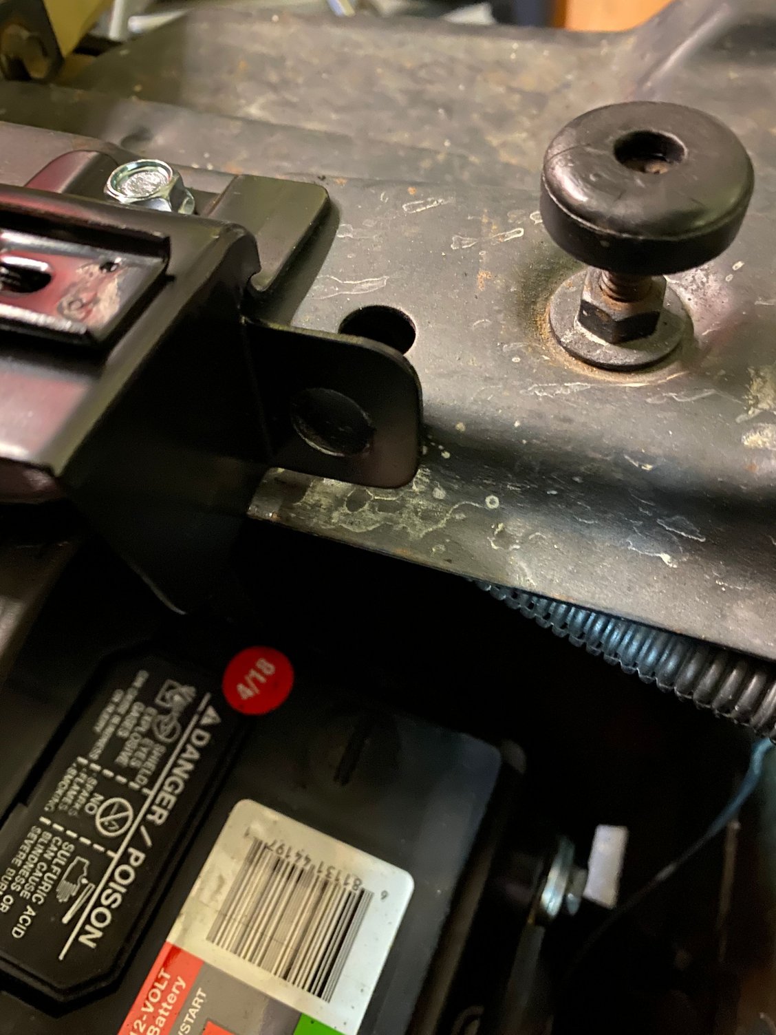

Just did a test fit of the brackets for the hood lock...I know its in the right spot due to the indentations but is this overlap and lack of a 3rd hole expected, I didn’t see a different cross brace/radiator support for Non W-25 cars....
Here is the Hood as well

That is all just fine and correct. Just put your own hole in the support for the third bolt/nut.
Just for grins.....took this pic of the "third hole" side of an original hood pin bracket. Shows the height but not ULTRA exact for comparison purposes as you'd have to have a caliper in the same spot. I swear your bracket appears to be slightly taller but it might just be the pics, etc.

Thank you , I just needed the sanity check
