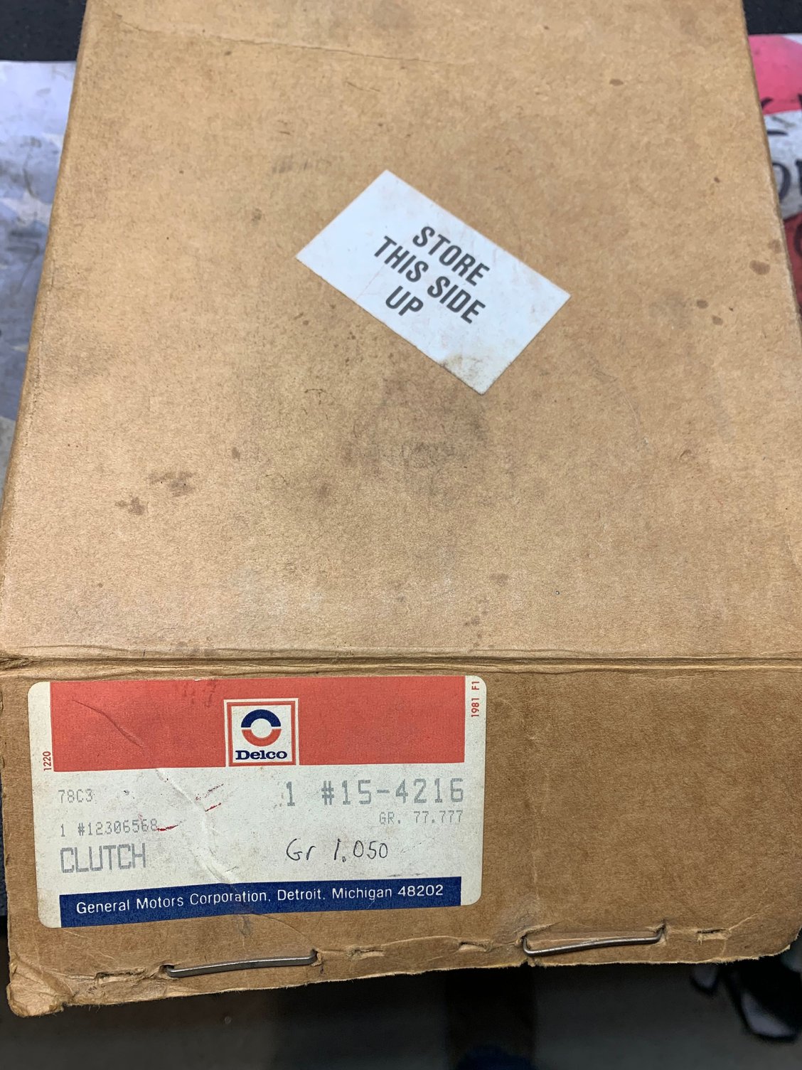

Those had a gold zinc finish on the front that you will never get back once it’s sanded. They should always be stored face down as well. No one will see it when installed anyway.
They go years at a time "sideways" when installed on an engine. Why would they need to be stored face-down?
I’m not an engineer but it’s often printed on the box to store face down.
In this case store face up is the flange side up. It’s an NOS clutch

As a follow up as to how to store a fan clutch, the following was printed at the bottom of my rebuild fan clutch receipt that I received from Dan Kirkconnell Corvette Service. This outfit rebuilt the OR code Olds fan clutch for me. I guess it does not matter, horizontal or vertical, both are proper.
Note:Although some fan clutch units state “This side up”,
We recommend storing units on their side (as in the normal application), which will help the oil to remain distributed evenly within the unit.
