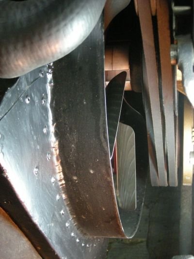

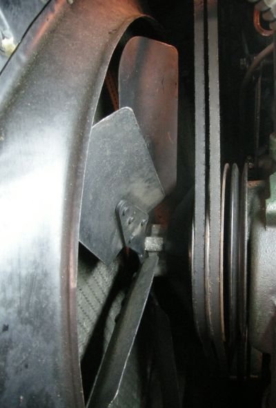

My clutch fan fan blades sit almost perfectly half in the shroud and half out. It'd prefer the entire fan is in the shroud, but without a spacer, or without changing all the pulleys on the motor(not going through that trouble, it'd rather replace the radiator), it is what it is.
But, the car does run consistently 5-10* cooler in traffic with the fan clutch. So it makes a difference, and it was in the shroud more, it might help that much more.

Fan/shroud position relationship
The positioning of the fan in relation to the shroud "might"
be dependent on the design of the shroud.
One rule might not fit all circumstances. Here's one placement
which was done by Oldsmobile in the mid 1950s.
1955 Oldsmobile with C.A.C. (car air conditioning)
And here's a home made one on a mid 1960s Oldsmobile 442.
1965 Oldsmobile 442
Both seem to work reasonably well.
