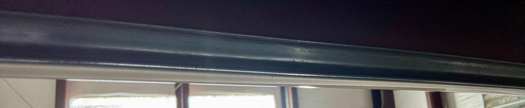

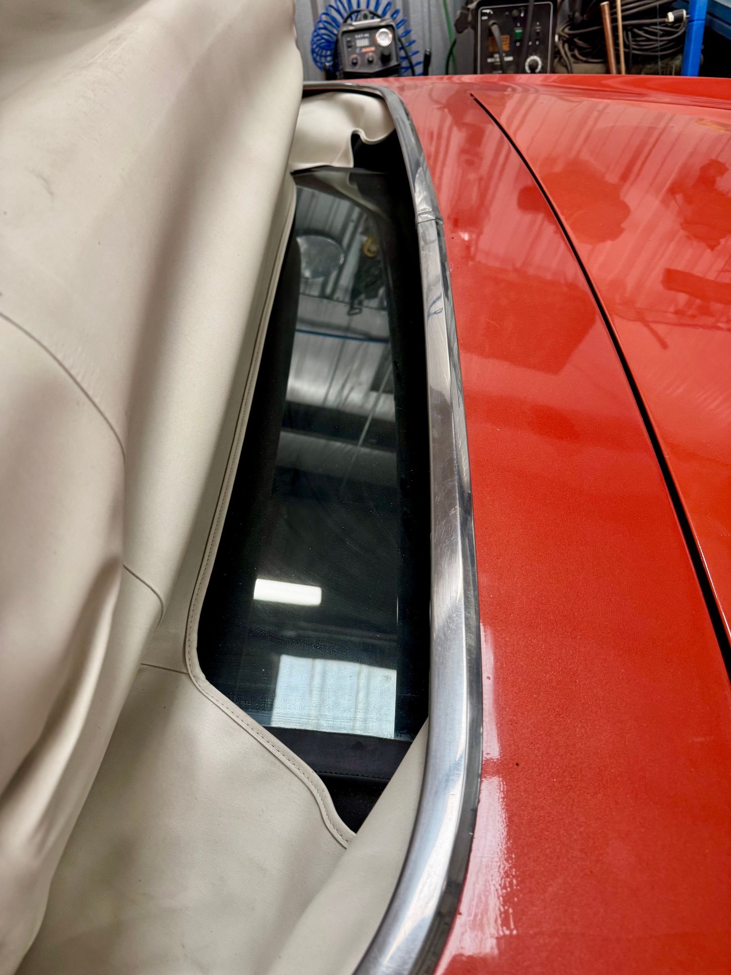

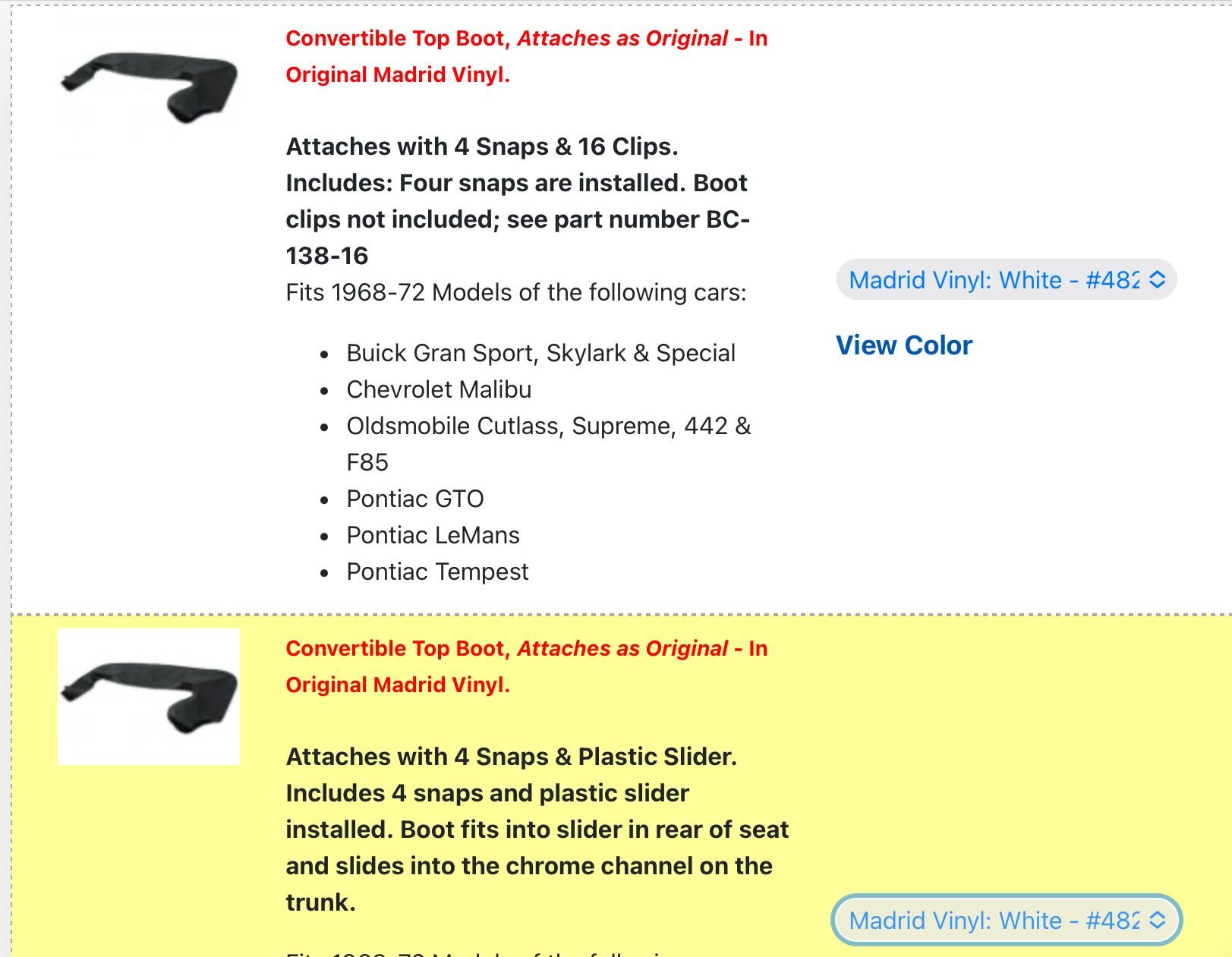

I want to install a boot for the convertible top on my 1972 Oldsmobile Cutlass Supreme Convertible and see that there are two options for connecting the boot to the vehicle. I’m looking for some clues on which one I need for my car as I don’t believe it’s ever had one installed. Here are the two Options Offered:
Here are pictures of what I have:
Top of the trunk deck chrome
Bottom of the chrome piece
channel attached to back seat.
Hate to order one and have to send it back? Anybody have pictures or drawings of whether I should use 16 metal clips or plastic sliders?

This is what the plastic slider looks like. A good clean finish. Easy to put on and it stays on.

I don't know if slider & clips are interchangeable - I suspect they are not. I believe/suspect the pinchweld molding is specific to a convertible.
Molding, Pinchweld, 1968-72 A-Body Convertible, Complete Set, Finished Ends

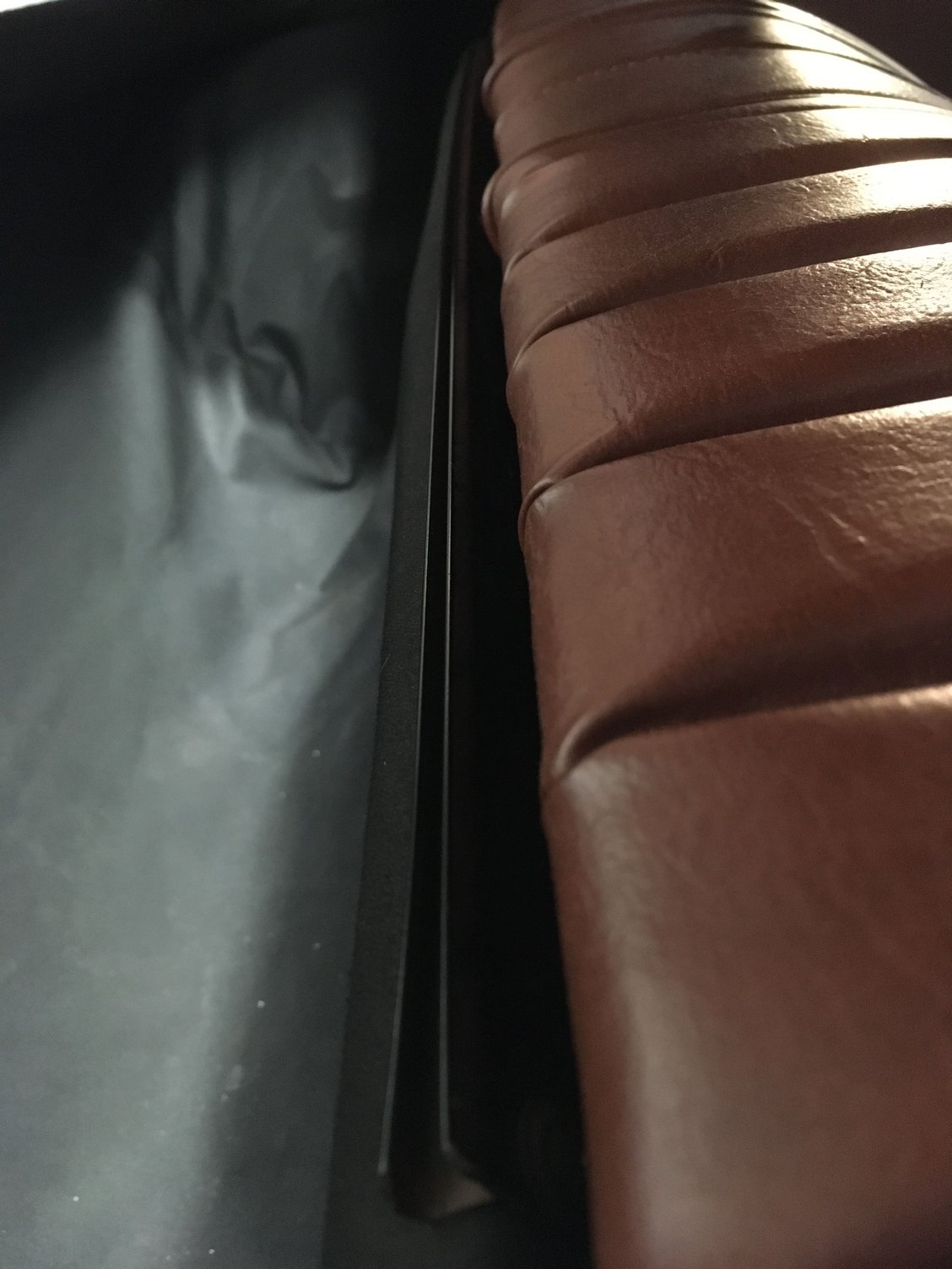

I'll provide several images. I call the leather/vinyl piece attached to the top cover a bead molding. The bead molding slides into the channel, which you already have installed behind the rear seat. You require four (two/side) snaps to secure the top cover.
I've found if you spray in the inside of the top cover channel w/ silicone it makes it far easier to slide the bead molding in/out.
