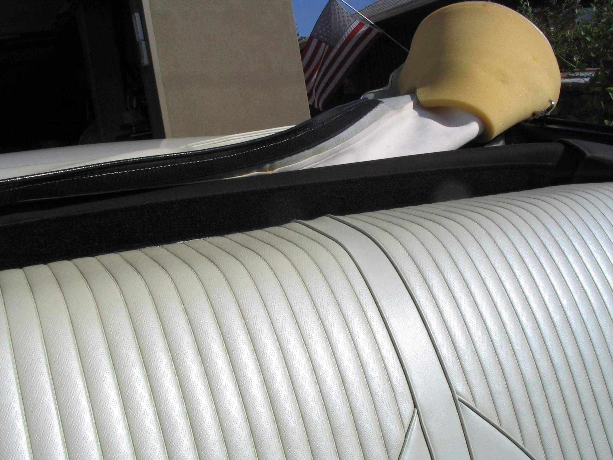

I got a new boot from Legendary for a 1971 Cutlass Conv. A the front of boot I can not seem to get it to tuck under the convertible top. It also looks like it needs some time to stretch, it was pretty tight to get on around the pinch molding. I attached a couple of photos.
Any thoughts on getting it to look neater ?
Thanks, Pat

Not familiar with this car, but wonder if there is a surface at the top/behind the seat where the boot could be secured with velcro?

On my 69 drop top, the boot has a beaded front edge that slides thru a channel behind the rear seat and is a giant PITA to pull thru

X2 on the beaded edge.....The channel is screwed to the body just behind the top of the rear seat back.

^^^x3^^^ I have the exact same year & type tonneau cover. Need to slide into the channel.

Beaded edge
Slide beaded edge into channel

X4, I had a tough time sliding the bead thru the chanel. I use a screwdriver to widen the channel a little bit and then it slid thru with no problem.

I never take mine off. When I raise the top, I leave the beaded edge in the slot and lay the boot cover into the top well.

I found that rail everyone is talking about and can also see why everyone is saying it is such a pain to get in there. May have to spread it open it open a bit. Hate to snag or tear that new boot already. Trying to figure out if there are other ways to tuck it in there. Someone mentioned Velcro ?

Glad you got it in there. Silicone spray on the beaded strip and inside the channel really do supply a lot of smooth sailing.
If you read below in the Related Thread section it appears the one poster did use the velcro and from all accounts was very satisfied with the results. Unfortunately, the pictures he posted are unavailable - probably because they were hosted on the previous version website of Photobucket and are no longer viewable.

Or take the slider from my old boot.
Rockauto wanted "pictures" what the problem with the boot was so they could
show the manufacturer but i send this link so they can read and understand the problem.
Here you can see why its impossible to fitting the new boot in the channel,the old boots
plastic slider are smaller and slides perfect in the cars channel. Have tried to grind the new
plastic slider but it,s probably better to find one who fits the channel instead.
Here pics of my old boot.
