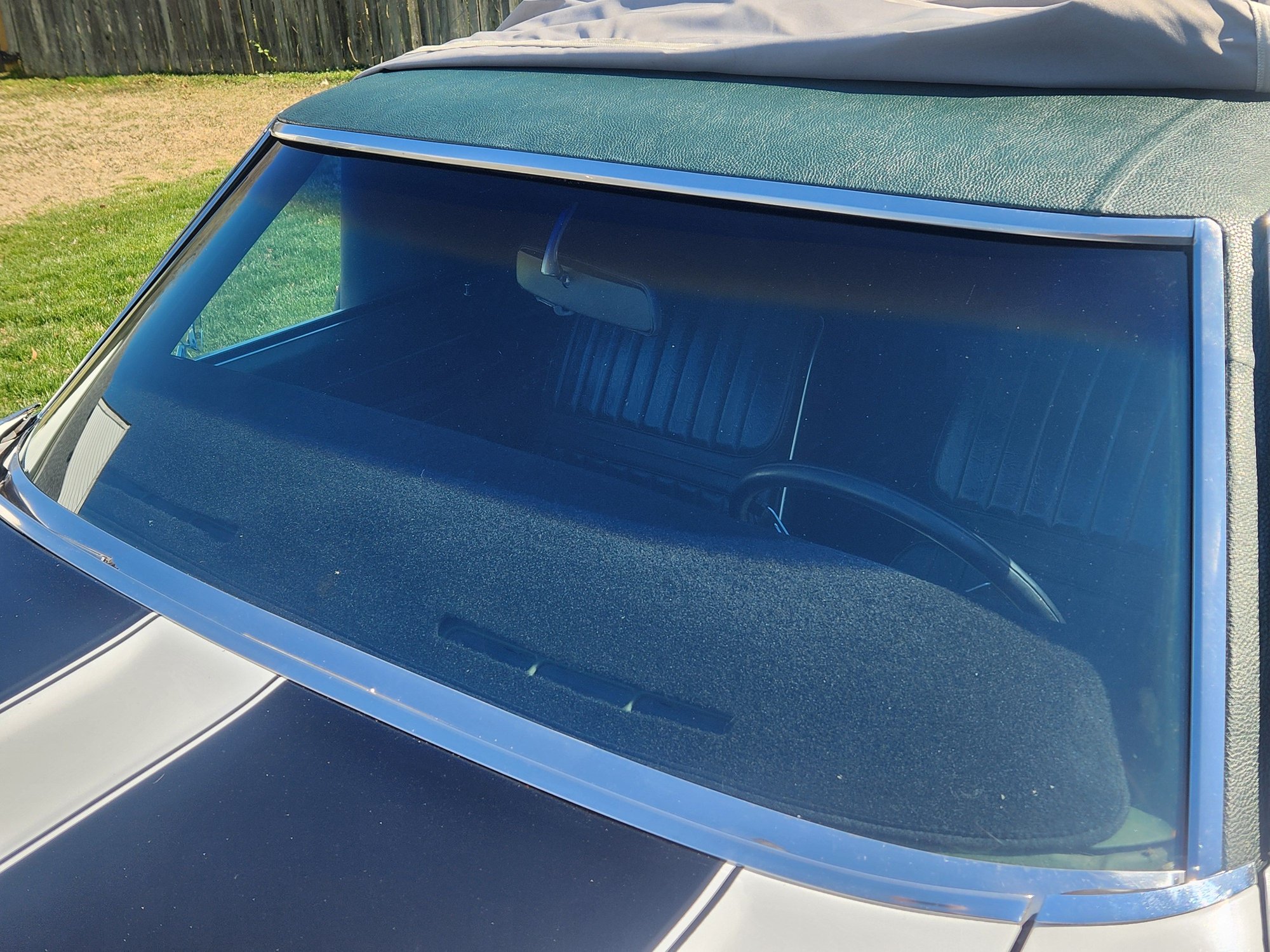

So I drove my '72 Supreme to work today and on the way home, I heard what sounded like a branch bounce off the roof. Immediately after, I looked in the rear view and watched in disbelief as a piece of trim was blowing down the road behind me. I thought "no way...no freaking way!!" Sure enough, once I got home, I checked, and ALL of my windshield trim blew off while riding down the interstate. Cruising along at around 65, I figured there was no sense in turning around to go back and fetch it as it probably wasn't worth saving anyway.
So I just continued on home and once parked, I checked for any further damage. Luckily all was good.
And now here I am, needing to replace the lost pieces. Not wanting it to happen again, I need to formulate a plan to prevent a repeat occurrence. I blame the issue on the repop clips that I used when I had the top replaced,
Since it seems OEM clips are not available, I'm stuck with the repops. So are there any better than others, and do I trim the vinyl under the clips to allow the trim to sit lower, thus maybe preventing the wind from catching the trim from underneath and blowing it off again? Keep in mind that the trim was flush with the A pillars, so lowering the clips would also lower the trim, correct? Also, should I use some sort of adhesive to hold the trim to the clips, or perhaps "tweak" the clips so they get a better bite on the trim?....
Mind you, I drove it to an event a week ago, and to work two days before that, and no issues.
Just need some solid input...

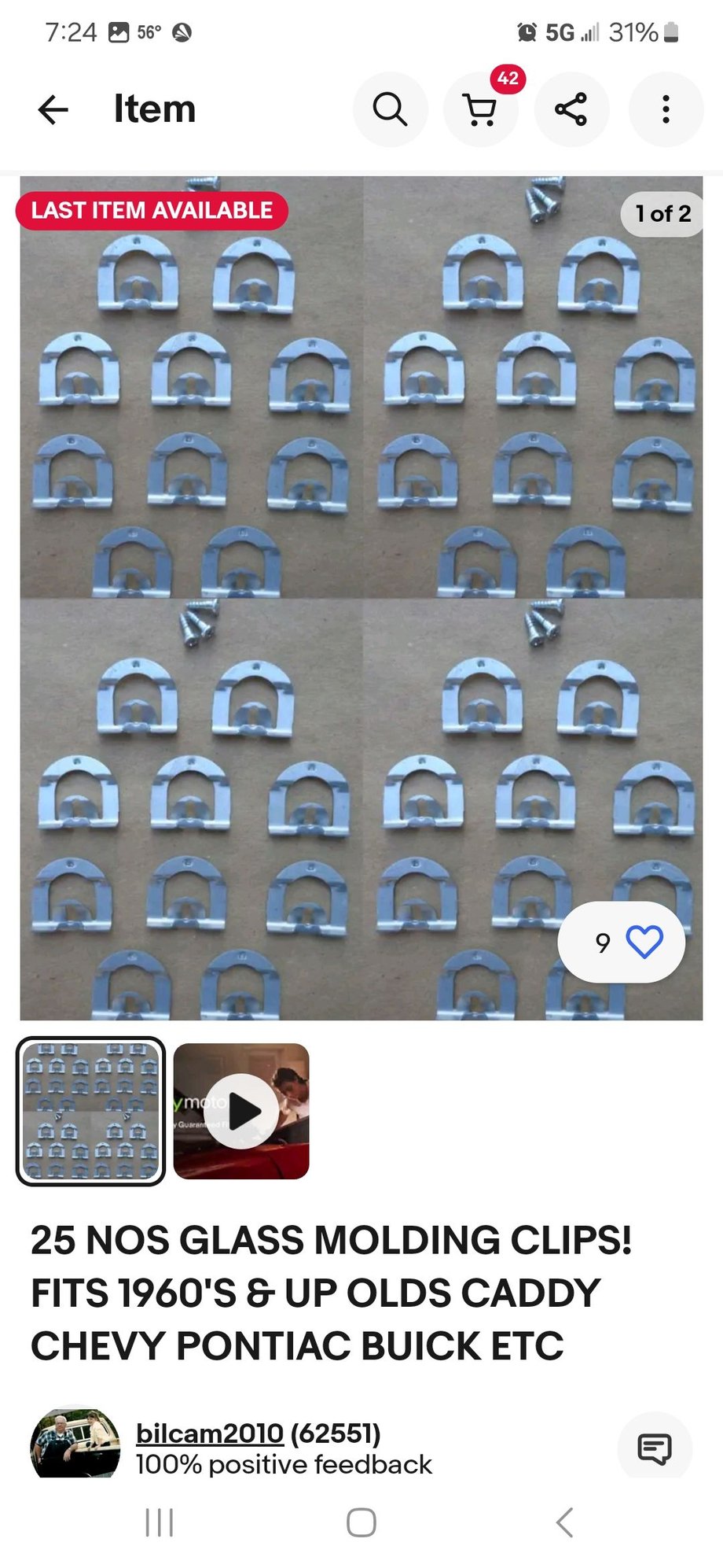

Two different styles of clips, and which ones are factory correct?

At a guess, I would say that at least one (or some) of the clips didn't fasten all of the way. You said that everything was fine until you replaced the vinyl roof. Maybe one of the clips caught in the vinyl and didn't seat properly and after 2 weeks it popped and started a chain reaction at speed with the other clips and just "zippered" right off.

Probably so. And here's another hypothesis...with the vinyl adding thickness to the a pillar, maybe the trim is supposed to be a little lower and not sit flush?

Looks like the clips on the driver side pillar are missing. If they came off and that side came loose, then it just keep peeling off. I found when taking the off, once you get it loose,it does come off a lot easier, wants a couple come loose.

Since there are several clips missing in various areas makes me suspect the installation of clips and trim.
Why are clips missing in the upper corner of the windshield and not the other ? Why are most of the clips missing on the drivers side "A" pillar and not the passenger side ?
I think there may be more than one issue involved.
The missing clips blew off with the trim. They were all there before. But, as pictured above, I'm using different clips this time.

More like the wrong clips were used. I had the clips that I installed in the above pic, but didn't use them cuz I couldn't figure out how they went on (despite several inquiries here on the forum). So I just left the other ones and since the trim was staying put, I figured I was good, especially since I had driven it twice before with no issues.
After some further research, I finally figured out how to install the other clips, and I feel pretty good that they're gonna work.

All done and nice n tight

vinyl behind the clips is fine but not under the clips,the clips need to snap into place and that vinyl can prevent that.
