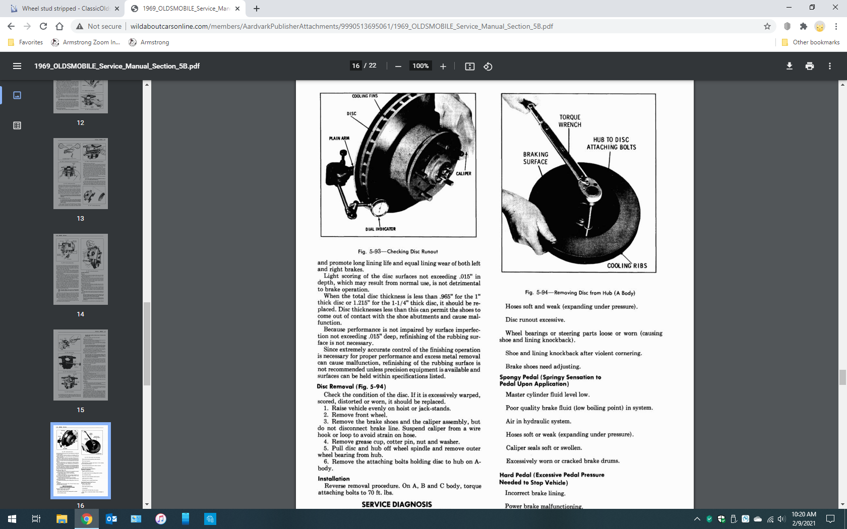

Those rotors are bolted together from the back side, you have to unbolt the rotor from the hub & then press out the studs of the hub. The studs don't go through the rotor on this type.

Of course you have to remove the hub but I've taken those out and replaced them with just a hammer. They come out easier than you think. As long as you set the hub on something solid you shouldn't damage it. While you are at it I would replace all of them. The one that was broken was probably weakened by some tire guy over torquing the lug nuts so they are probably all weakened. .
