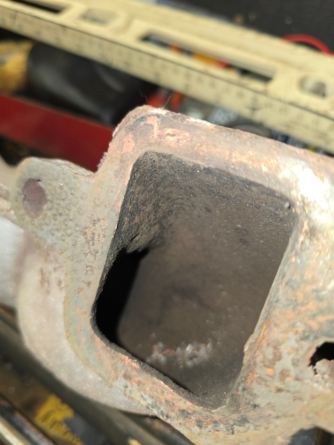

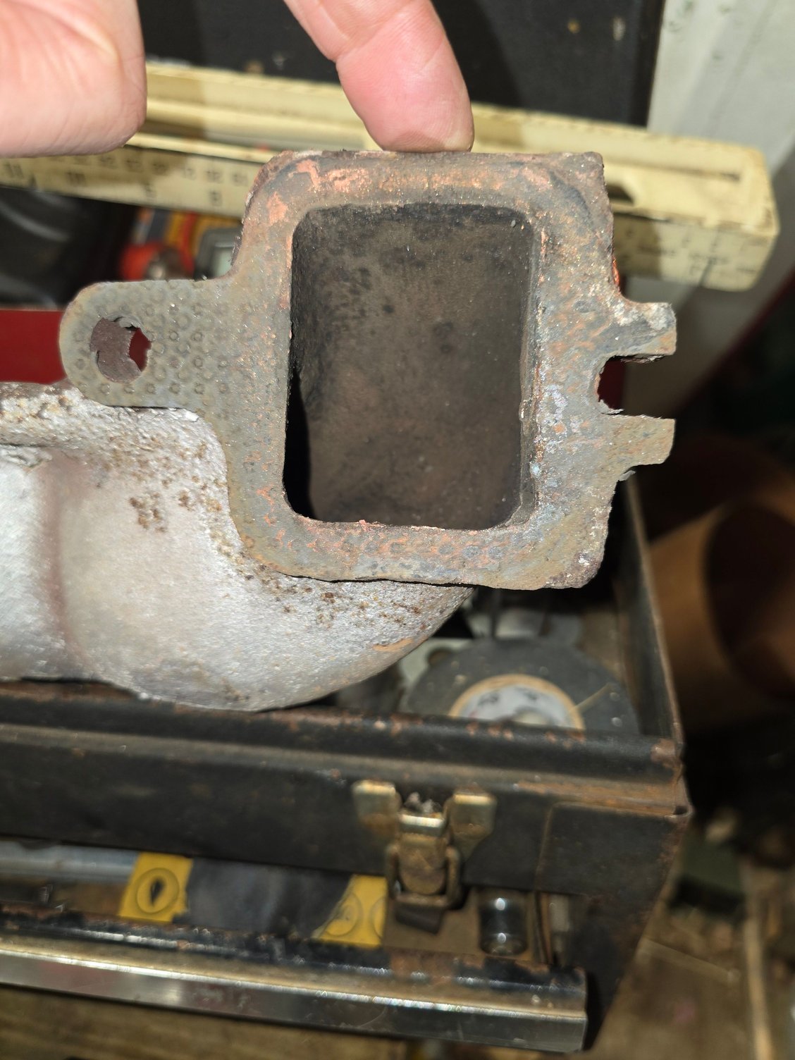

It?s been my experience the prep is far more important than the type of gasket used. As long as the surface is clean, relatively flat, and properly torqued they don?t leak.

Grateful for all the input. I pulled the manifold and my "guy" Steve is going to resurface the manifold for me. It only took maybe an hour to get this off the engine, because It's been on and off three or more times in the last 2 years.
this is where it has been burning through.
Upon close inspection, its really not a clean and flat surface.
Upon close inspection, it's really not a clean and flat surface.
