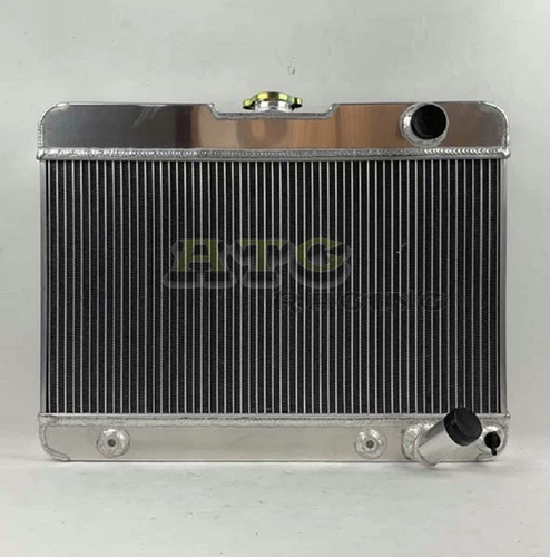

if you havent seen the 63 buick ,,skylark,, check it out,, itAluminum Radiator for 1962 1963 Buick Skylark 3.5L V8 Engine AT 62 63 - Picture 1 of 7 has the bend,,
Old Nov 19, 2025 | 08:22 AM
jensenracing77's Avatar
Posts: 11,878
From: Brazil Indiana
I think that is like one I have from a parts car and you have to modify the lower mounting brackets or make new ones. Not sure what these sell for new but I could sell my used one. It only had about 100 miles on it and like new. I will be out till Tuesday next week. Headed to MCACN in Chicago. WHere are you located, If interested in it I could bring it with me if you are near there

i will be $143.50 shipped,, the fill is in center instead of offset like the olds,, but i will go and order one,, i dont think that will be a bad thing to drill and tap a couple holes
