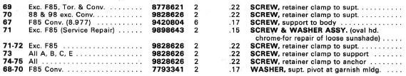

Posts: 25,660
GROUP 10 Section 10.203 SUNSHADE ASSY, WINDSHIELD of the Thru 1975 - Oldsmobile Chassis and Body Parts Catalog - ClassicOldsmobile.com
The SUNSHADE ASSY runs ~7 pages in length (10-34>10.40)
Representative illustration I snagged from page 10-40.
