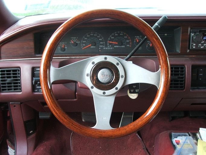

You can still get really nice 50s-90s wheels from Moto Lita. https://www.moto-lita.co.uk/.There are also nice Nardi wheels on ebay. You will probably have to make a stack of adapters for it to fit properly. I have an old refurbished Moto Lita Mark 10 on my 92 OCC, and an interesting MOMO on my 91 OCC. For the price of a new Moto Lita, it is not worth the effort to refurbish an old one. The crucial distance is between the wheel and turn signal stalk. A Grant adapter with a 1 inch spacer/adapter works with MOMO and Nardi. I had to find the right stack for a 9 hole Moto Lita. I used a short NRG, and a short Nardi adapter, then a short Nardi to Moto Lita adapter. I had to shorten some screws, and make it fit, but it turned out good. The pic for the Moto Lita is forthcoming. The horn button in the Nardi is a Grant with a ring to fill the gap made from a piece of black plastic. Nardi and MOMO have different bolt patterns, and some adapters have both patterns.
Nardi
MOMO

Here is a pic of the Moto Lita wheel in my 92 OCC. The sun is shining on part of it, so it looks discolored. This wheel, new in polished aluminum is $216 plus shipping from England. Shipping is about $83.
I bought this one on ebay for about $150, but I had to refinish the wood. It took me about 6 hours over 3 days, a bottle of superglue, 2-4 sheets of 180 grit carbide sandpaper, and two spray cans of urethane spar varnish. The cracks are filled with sanding dust and superglue, and there are about 10+ coats of spar varnish on it. I taped off the spokes to keep the anodizing from getting varnish on them, and to give me a place to hold it while varnishing.

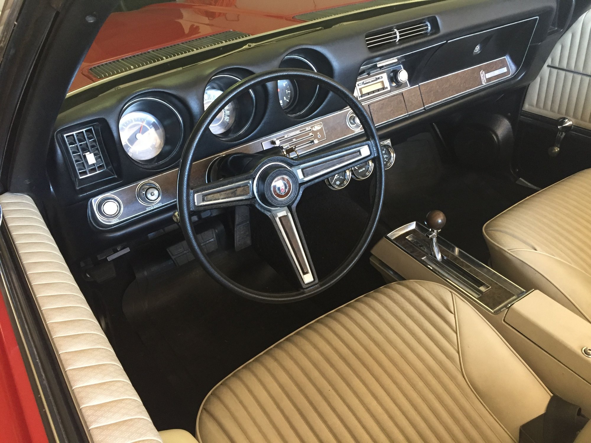

Real deal vs decent aftermarket
Take a look at these..on my 69

Well spit, either the format has changed or I have forgotten how to get pictures posted! Tried 5 times..sorry.
Old Dec 30, 2018 | 06:27 AM
pops1958's Avatar
"I need a couch"
Posts: 177
From: Brandon, Mississippi
One more time
Old Dec 30, 2018 | 06:55 AM
Rvsmith5's Avatar
Joined: Jun 2018
Posts: 227
From: Wisconsin
Originally Posted by pops1958
i do like the way this looks, especially with the white interior.
Old Dec 30, 2018 | 11:13 AM
Inline's Avatar
Joined: Sep 2015
Posts: 1,882
I have that exact same Grant steering-wheel on last picture, on my car.
Take a note; wooden halves around metal-frame werent centered to other side, therefore needing sanding to get it "good" ( would pass QC at 70's maybe), and the gluing of wooden parts to each other to form a circle, was badly done, pieces slightly separated here and there.
Classic example about you get what you pay. Invest to Nardi if you want wooden. Just my opinion.

The horn buttons are not bolt in, they are spring loaded, and push in. Sometimes the wheel has a bolt on trim ring around the horn button. The black spoke Moto Lita, above) uses the ring to bolt the wheel to the adapter, and the horn button slips in the opening. It can be removed by prying it out. The Nardis have a trim ring that slips over a couple of extended bolts as an enhancement, but is not supplied with all wheels. The fancy screws are often allowed to remain exposed. The MOMO above is secured by 6 screws, and the trim ring is held in place by the two screws at 3 and 9 o'clock.
I looked into replacing the wood, and it is a major undertaking. You need a large diameter lathe to shape and finish the wood. The time required to complete the task far outweighs the cost of a new wheel.
