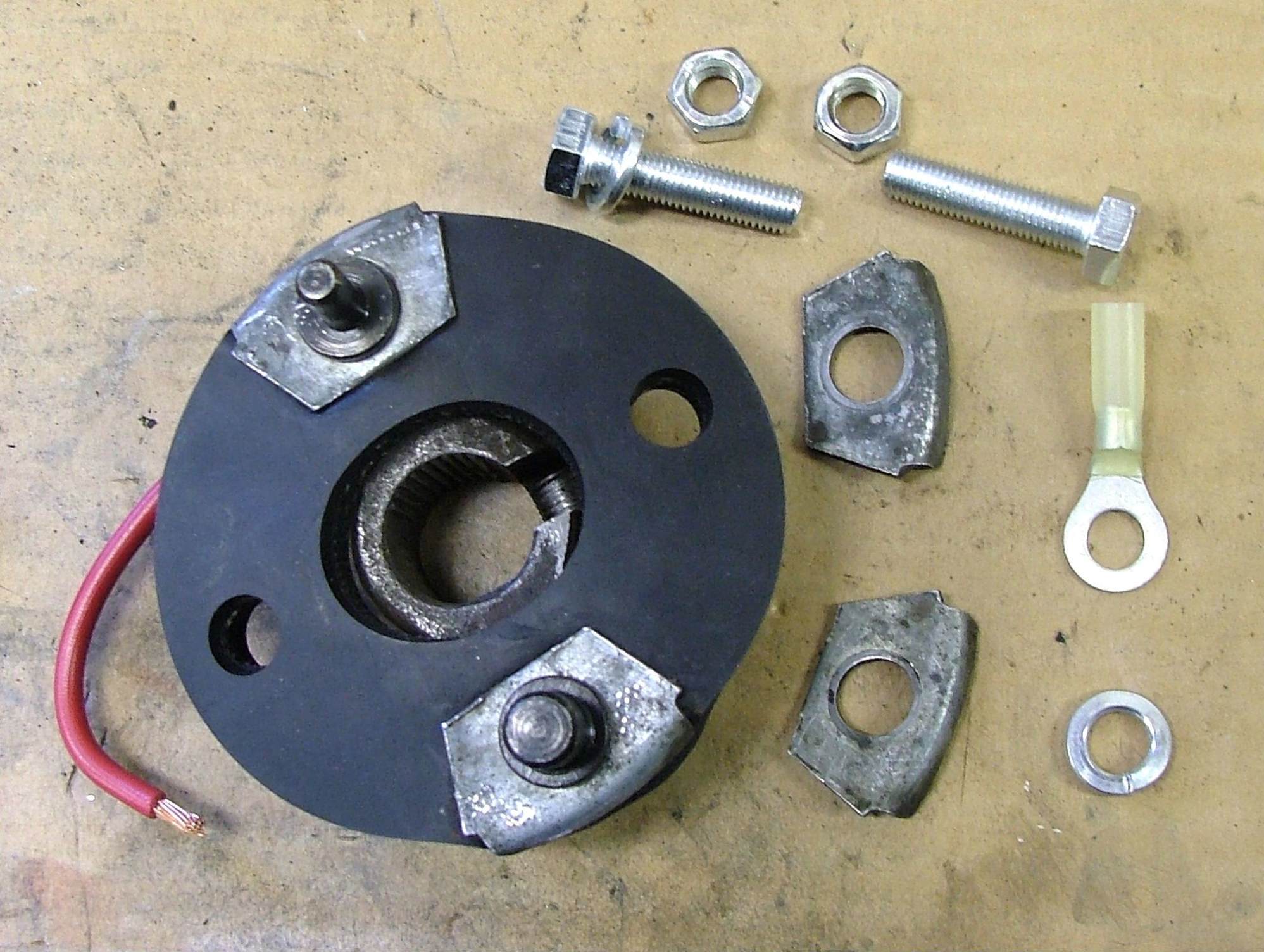

I had to do this with the new rag joint for my 67. A short piece of wire and two ring fittings. Took longer to write this than to cobble that up.

Just be sure that you position it so you are electrically connecting the steering shaft flange to the box flange.

Easy fix.

That’s beautiful, thanks Don.
