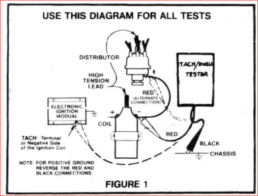

Thanks for the feedback guys. Exactly how do I setup the dwell meter/attach what to where, etc (again, not sure how I can't recall ever doing this way back when)?
Old Dec 23, 2021 | 10:02 AM
Posts: 50,802
Depends on the meter. Most have two wires, but I have one with three. In all cases one wire goes to the negative terminal on the coil.
