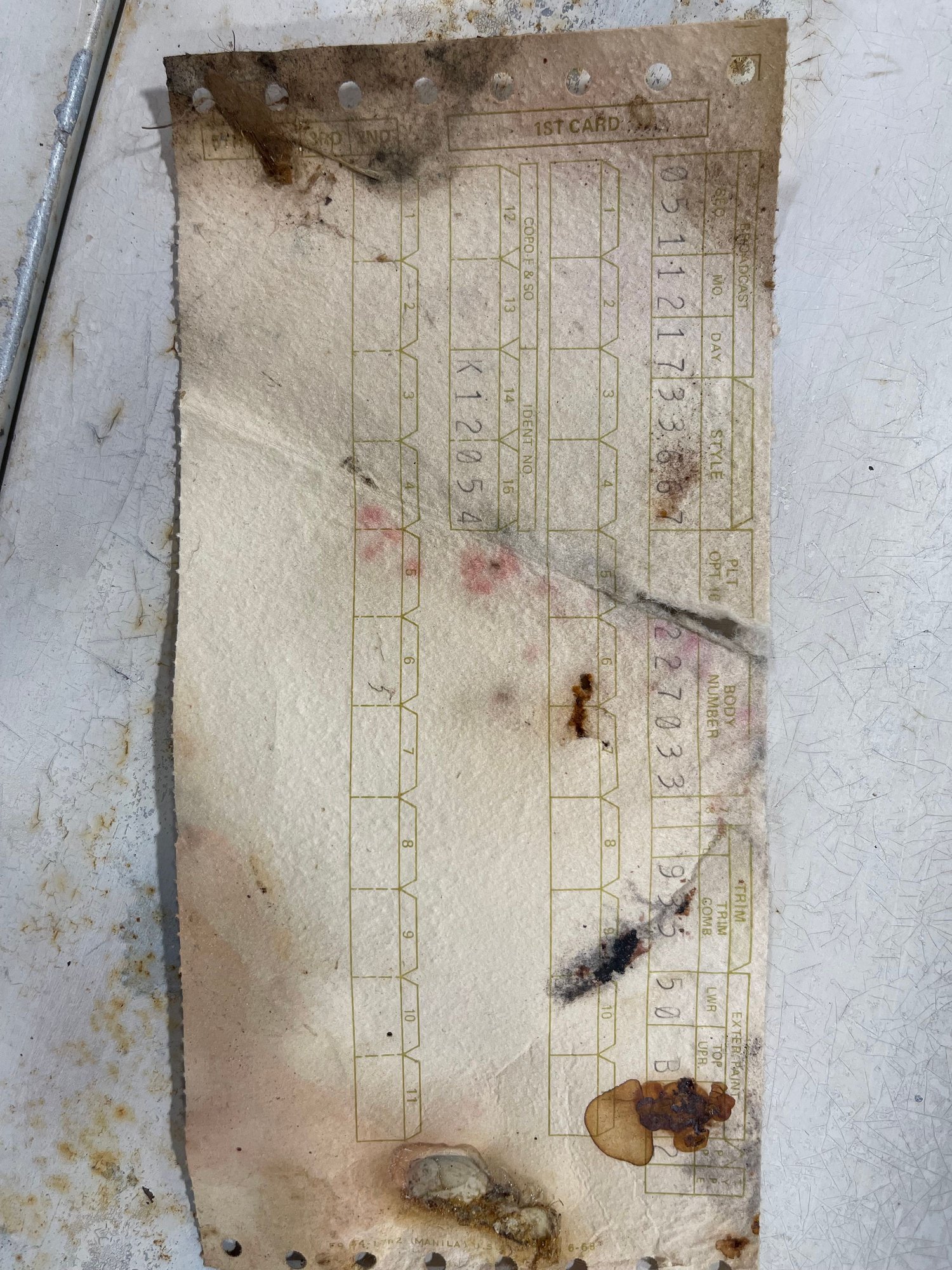

Hey Oldsmobile guru’s
try this with your numbers and see if you get what I get just in different #. I’m curious if it works the same on your ride. Please nothing to loose I just want to clear up the noise

Originally Posted by oldoldss
From what I'm understanding, the transmission (225486) matches the VIN, so its original to the car, but the engine (115959) isn't?
Ok.
Yes this is what I’m trying to clear up the problem with !
so I got this book called a service manual for Oldsmobile and it clearly states that the # on the oil fill tube indicates what engine is what ok that’s fine.
so if you look at the math I did on the white paper in first photo! I can do the addition and subtraction and not in a complicated way I get my oil fill number that is on the engine.
Something is very strange about that whole situation! You explain how that could happen if the stamping “ Should “ always match the last # of the vin.
All I know is that the only true way to know is if there was some way of getting the copy of final documents from federal government with the vins of all Oldsmobile products from the 60s because we all know the world was a different place and I remember sitting in the office listening to my babysitter making last minute changes on vehicle orders with GM themselves and I had to be very quiet in the background because it was always very important calls dealerships had graces periods to make changes to orders for customers!

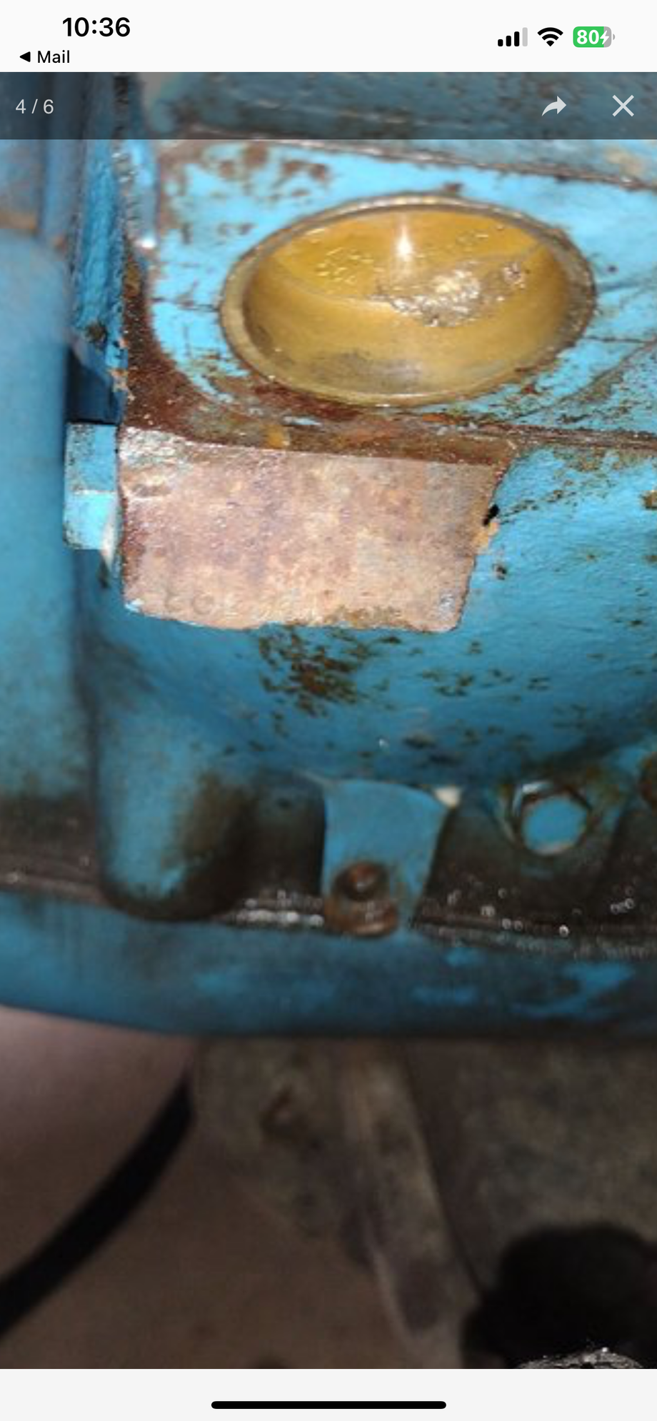

Originally Posted by v8al
The first problem I see is "Engine part sequence # 115959 ( Stamping on drivers font flat) last Six" If this is the stamping located on the pad as shown below then the last 6 digits should match the VIN.
yes I see the problem as well but I keep going down rabbit hole after holes with this for some strange reason. Explain to me why I subtract that no. From the vin or body no. And add both answers take that number and add back into the EPN. And get my oil fill no. Completely baffles me! Something is going on here?
Old Dec 3, 2024 | 08:35 PM
tylerk's Avatar
Joined: Dec 2024
Posts: 56
It’s funny that I just looked through this sight and found a post
2023 of clearly posted pictures of an engine part number stamped upside down on the front pad. ? I thought hmmm people told this guy that was legit! Upside down light stamping and wrong size as well holy sh*%!
Numbers match yes but not correct !

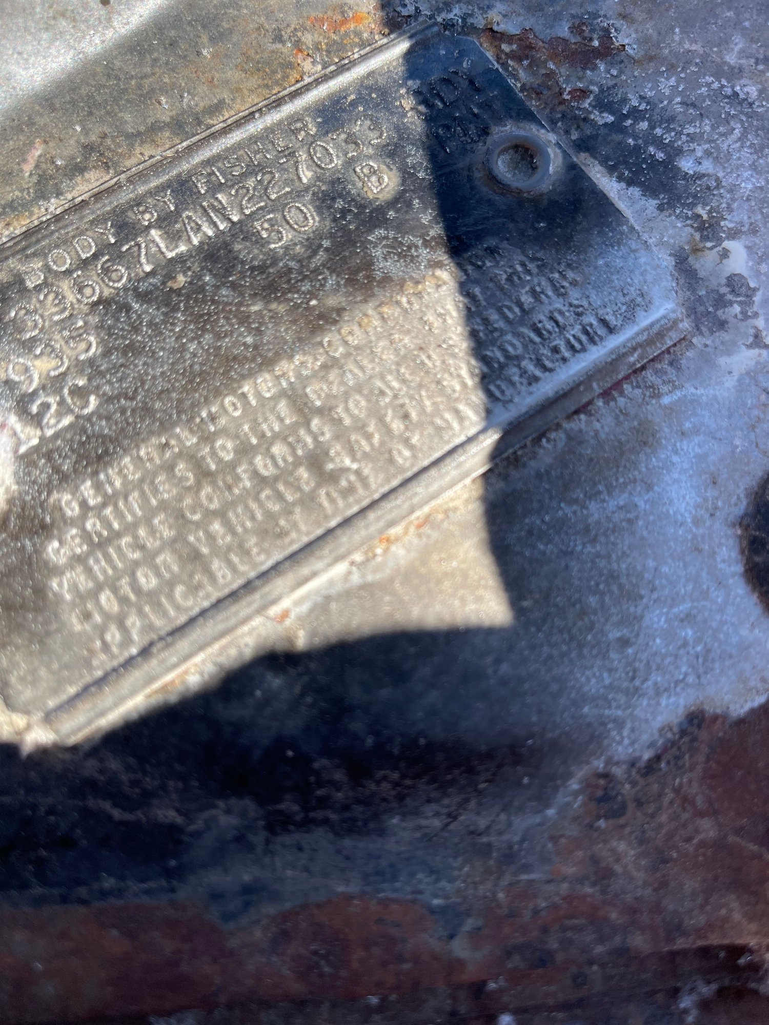

Perhaps your car has a non-original engine. Please post a picture of the vin tag on the dash and the vin derivative on the block, as well as the transmission. This is what matters. Please attempt to act on the help we are giving you.
A 20 on your frame is of lesser importance. It would not be any kind of "sequence number." Again, the ONLY sequence number is a meaningless 000-999 assigned to a car going through the shop. The frame, in that location, has the same vin derivative as other major assemblies, The 20 you are seeing is probably part of a manufacture date for the frame. The VIN derivative should be next to it.
