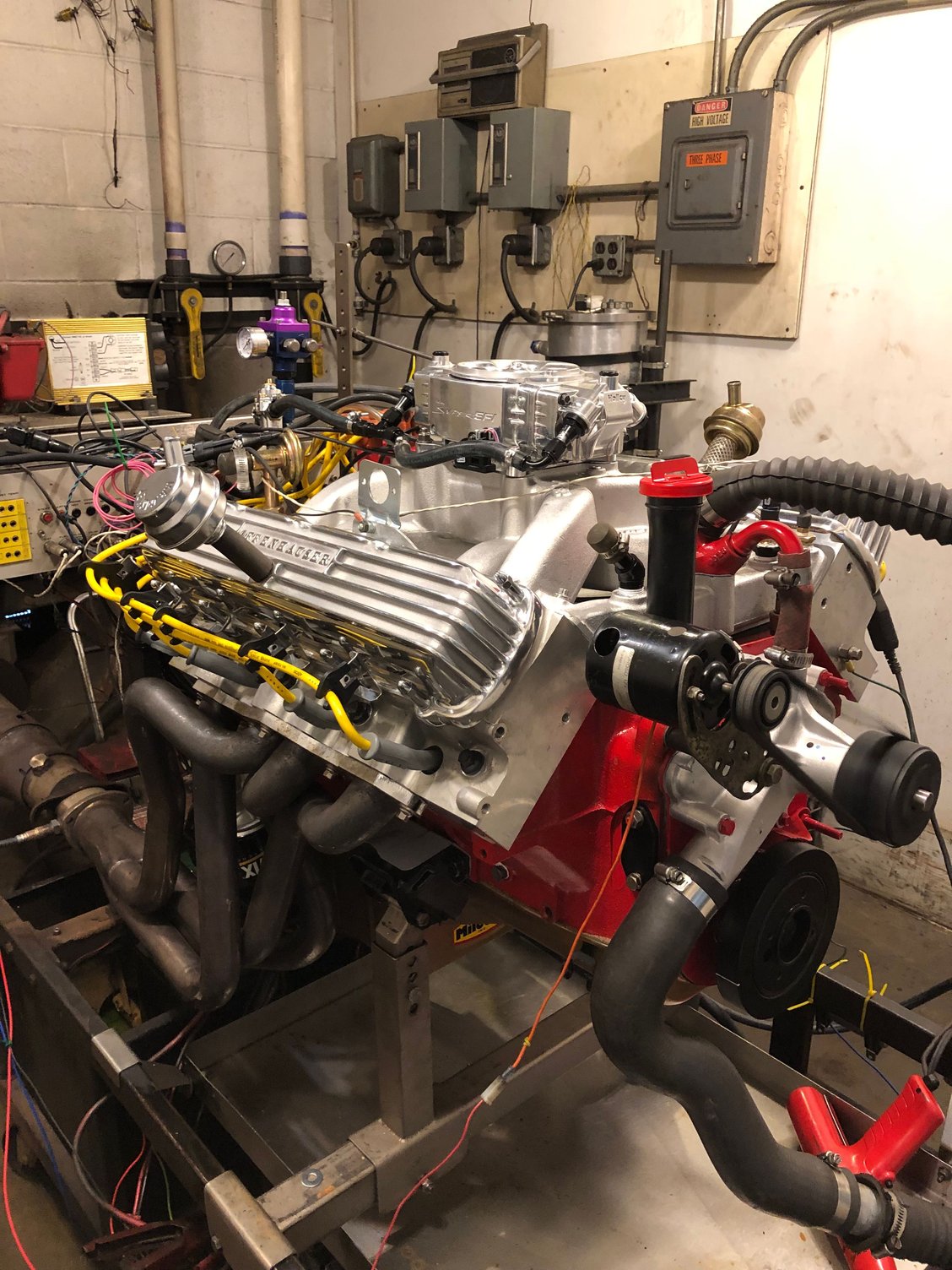

I like the numbers.

engine
r
Ready to go in

What heads are those?

Originally Posted by Chatt
I like the numbers.
I don’t know who your Dyno operator is so I’ll be nice. That MIGHT be your peak tq but most likely it’s not. Any good Dyno operator will tell you that you ALWAYS throw out the first and last numbers.
Moving forward as long as you’re happy with it that’s all that matters. However build specs are always appreciated.
Thank you.

What's in it?
Old Jul 2, 2023 | 03:36 PM
What is it going in?
Numbers are numbers. Hope it runs well for you. Oldsmobile On 👍
Speed Master
69 Cutlass Convertible. Frame off Resto-Mod.

What's in it?
Basically a stock engine.Speedmaster alum. heads,2.075 intake, 1.71 exhaust valves, 9.5 compression, Thumper CompCam. Air gap intake. Sniper fuel injection

200r trans. 12bolt diff. with 4.11 gears. Basic 'Tire Burner'.

Looks like it would skin a cat in a second.

That looks like a great engine!
I think those are very decent #’s for that combo.
Its gonna be a blast to drive.
One comment if I may…The 4.11’s are gonna be a little steep I think.
Whats your converter?

2800 stall. I've had a GTX with a 4.10 and a automatic over 50 years ago. Love that setup for those 'stoplight' drags
