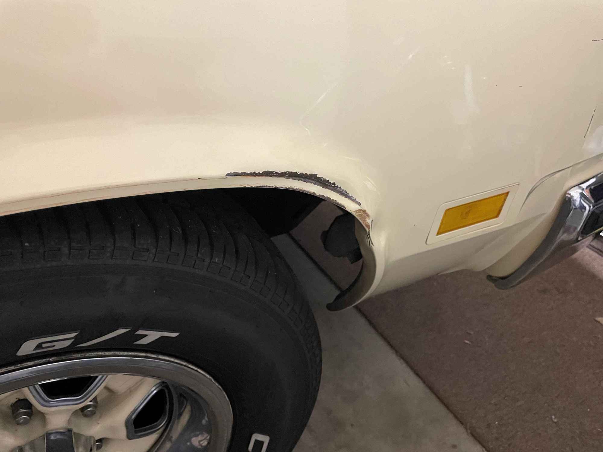

So my 76 Cutlass S needs:
1. A little body work and a paint job, I'm told when the original owner was getting too old to drive he scraped the fender wells up pulling in/out of the garage, etc. Otherwise the body is in good shape.

Left Rear
Right Front
Right Rear
