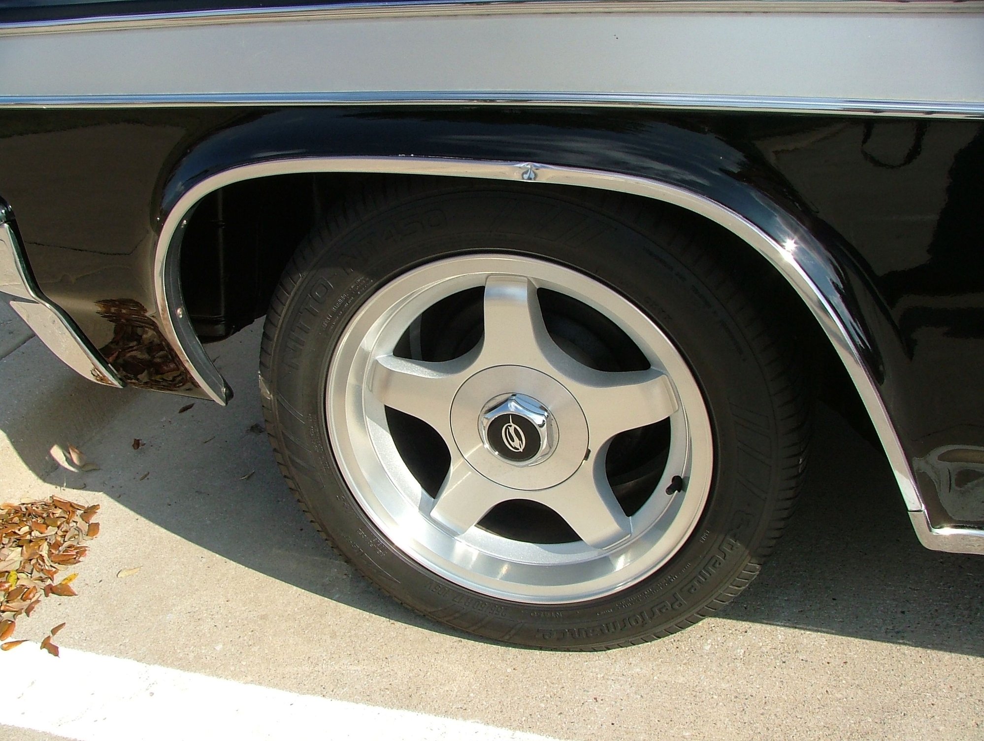

I put 235-70-R15 tires on my 63 Starfire using 94-96 Chevy Caprice 9C1 police wheels, 15 by 7, which bolt on and fit easily. Then later I upgraded to 94-96 Chevy Impala SS alloys, 17 by 9, with 255-50-R17 tires, they also fit perfectly with no clearance issues, but you will need to install longer wheel studs. (Not an easy thing to do)
Looks nice, but those Impala logos really need to go...
