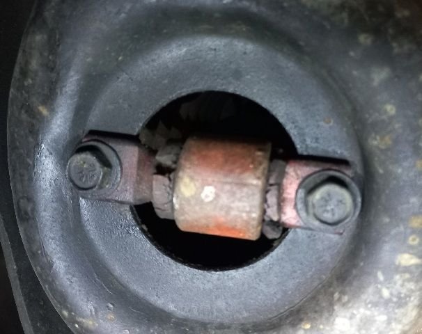

Got KYB shocks for the 67 Delta. Note how well they fit the holes in the lower control arms. The upper hole in the photo is aligned with the control arm hole.
I'm guessing KYB has consolidated part numbers, as these are the same front shocks that are also listed for the 64-67 A-body cars. I ended up slotting the holes in the cross bars all the way to the end to get the bolts in. The Monroes that came out were similarly slotted from the factory. Unfortunately, this doesn't leave a lot of meat for the bolt to capture. I'm using large, thick washers, but I'm still not thrilled.

Originally Posted by BlackGold
Man, I would've returned them. That's just not acceptable.
I would agree... Maybe they were boxed and/or numbered wrong from the factory...
It would seem that the gap is just too large for an oversize washer to retain the correct position of the shock and subsequent failure could possibly occur...
I'm sure Joe knows what his options are, and simply may have no easier options at this point to get the vehicle back up mobile... Good luck Joe, like you said, the current vendor sources just aren't what they use to be...
Old Nov 12, 2016 | 07:42 AM
They're not. If you check the listings, EVERY shock manufacturer lists the same P/N front shock for Cutlass and full size that year. The factory parts book, however, has distinctly different numbers. Sure, that could be due to different shock valving, but it could also be due to different dimensional fitment. In any case, this is 100% due to poorly done part number consolidation in an attempt to service a model that isn't particularly popular.
Keep in mind that the photo has one bolt hole on the shock crossbar aligned with the hole in the LCA. The actual mismatch is half of what you see if you center the shock properly. I'll again point out that the Monroes that I took out had the same problem but used slots in the crossbar from the factory instead of discrete holes like the KYBs. Yes, I am a little worried about the shock sliding side-to-side relative to the LCA. The thick washers I have serve to also keep the shock centered to mitigate that concern.

What did you get when giving the store the factory number to cross reference?
Old Nov 13, 2016 | 05:55 AM
Not sure what your question is, exactly. I got these from RockAuto, and this is the P/N listed for a 1967 Delta 88. It's also the same P/N listed for a Cutlass. Same info on the KYB website. Every other shock manufacturer I checked also lists the same front shock P/N for D88 and Cutlass. This is obviously wrong, since I just measured the bolt spacing on the lower control arms. On the 67 D88 the bolts are 3" center-to-center. On the A-body cars (and on the later full size like my 1980s D88s) the spacing is 2.5". Again, someone incorrectly tried to consolidate part numbers. I suspect the answer is that no one makes a correct front shock for the 65-70 full size cars anymore, just as no one makes correct brake rotors, drums, center links, or upper ball joints for them.

Why not just make a new cross shaft, very simple to do.
Because 1) I shouldn't have to, and 2) I might eventually but right now I have enough to do on this car to get it driveable.
Hello @joe_padavano
I have a question, I am planning to replace all the shocks on my 1966 Oldsmobile Delta 88, I bought KYB KG4515 front and KG5508 rear. I have the same problem with the front ones as you did years ago 2.5" vs. 3.0" You don't have a photo of the mount, did you solve it by changing the hole to a groove, see photo?
thank you

..... Yes, I am a little worried about the shock sliding side-to-side relative to the LCA. The thick washers I have serve to also keep the shock centered to mitigate that concern.
Tack weld the washer to the shock flange,

Originally Posted by LuckyLuke
Hello @joe_padavano
thank you
I did, but since then I've bought longer crossbars since the slot is kind of sketchy. Of course, I haven't changed out the crossbars yet either, but the car is a long way from being reassembled, unfortunately.
I'll try to convert the lower mounts of the KYB KG4515 shock absorbers into a groove and add thick washers that I'll attach with spot welding.. hopefully it will work
Actual original mounting
