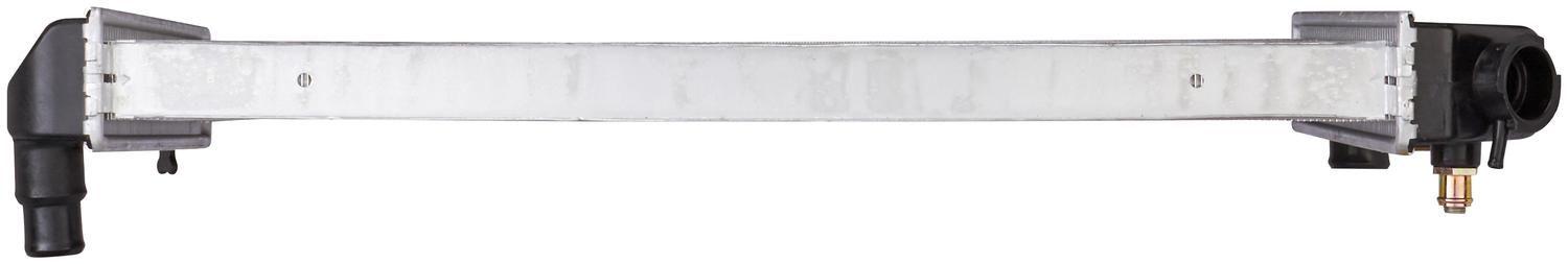

Side by side comparison from Spectra Premium
Will the difference in the inlet and outlet headers be an issue?

Remember that the mounting points are the seams where the end tanks attach to the core, and these fit into the upper and lower saddles, which have rubber inserts.
I have easily fit a number of non-application specific radiators into my car over the years. These radiators fit in the lower saddles, then the top plate was tightened and held the radiator securely in place.

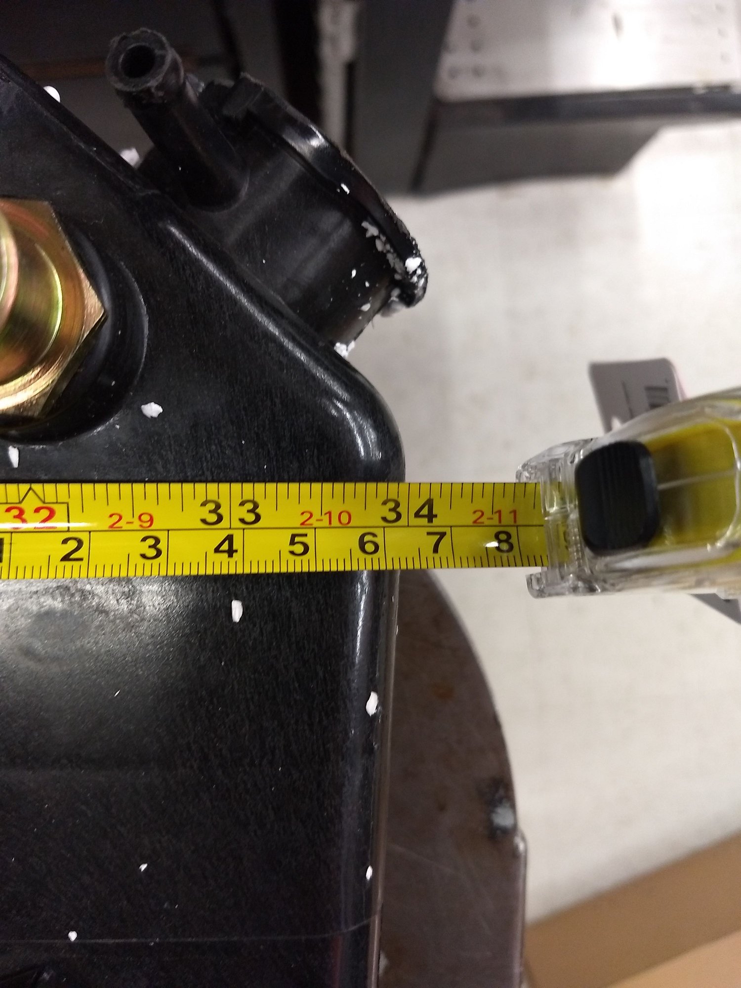

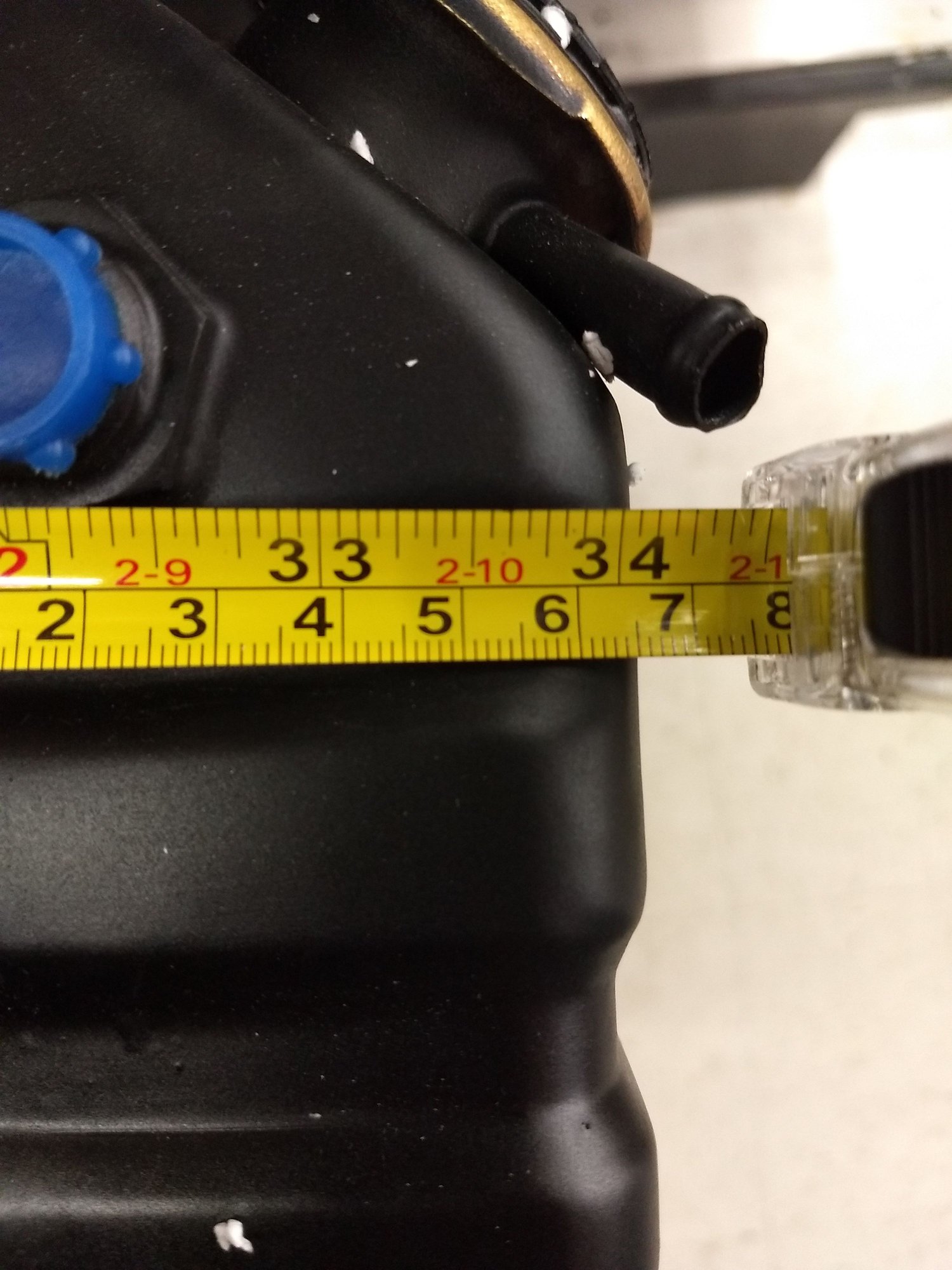

Norm, here is a series of measurements...this is the 165...core width
Overall width...
And overall length...
And this is the 351..
core width
overall width
.and overall length
What do you think?

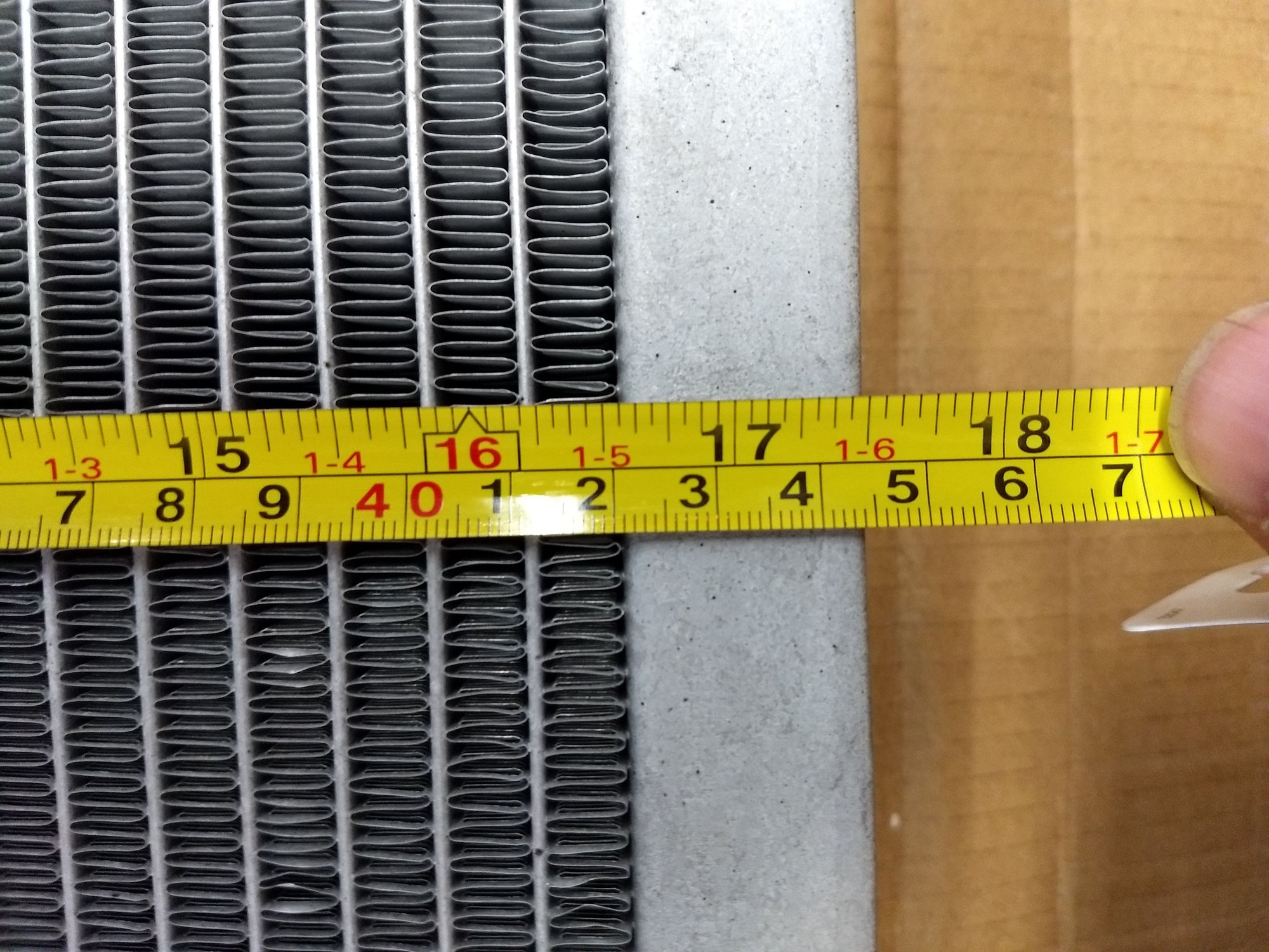

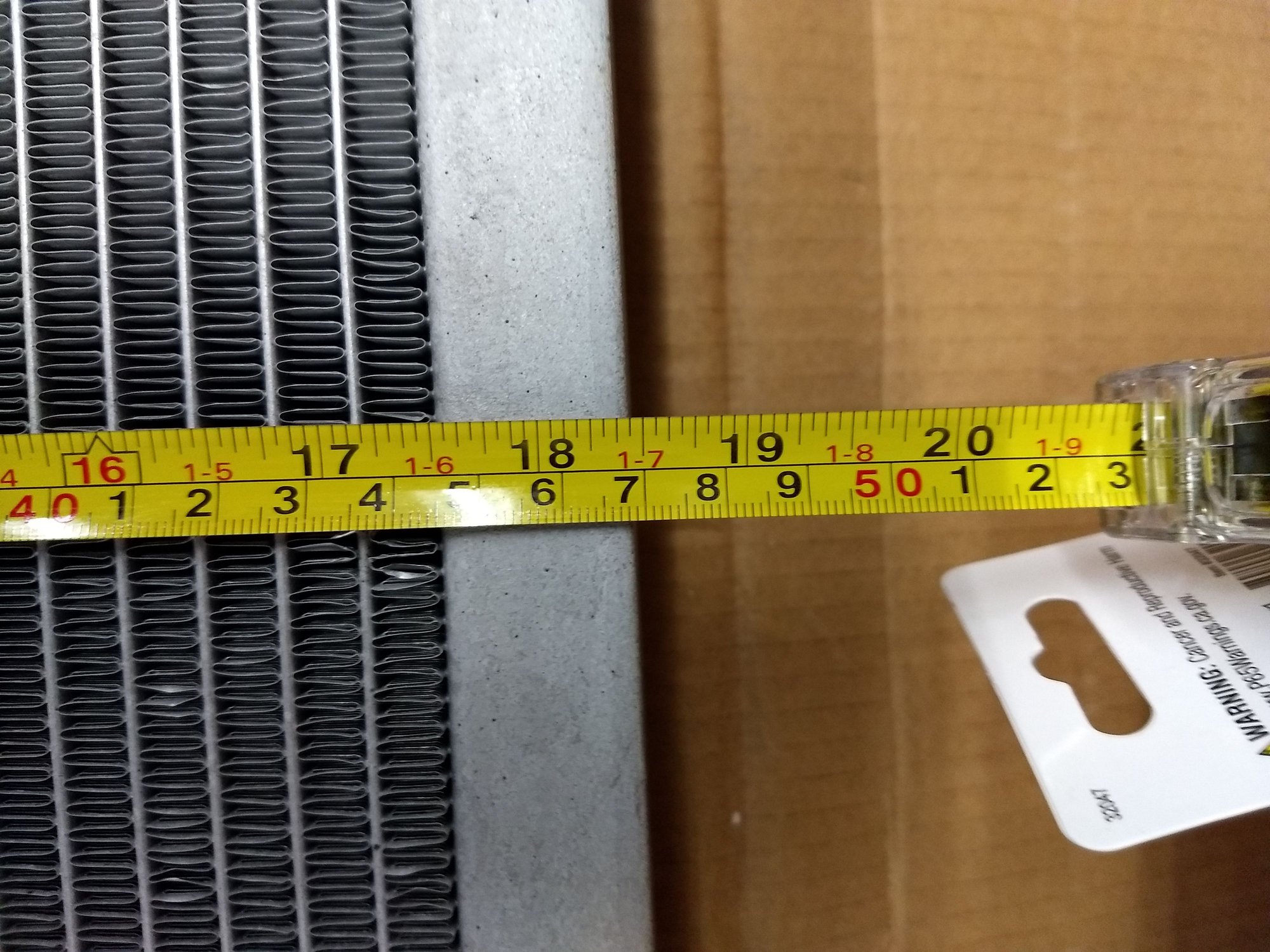

As Kenneth correctly pointed out and I attempted to suggest, it isn't necessarily the overall width at select points. It's the mounting points where the radiator must fit into the top plate and bottom plate saddles. If the radiator mounting points fit correctly into the upper plate saddles and the lower plate saddles you "should" be golden. I'd measure and examine the distance between each mounting point and the ability of the radiator to fit into the lower plate bracket correctly (in particular), because if it does not, the radiator could be much higher as a result of not fitting into the lower plate saddles.
Gotcha... here's the distance between tanks on the 165.
now the 351...
... will 1/8" make that much of a difference?

Here are your top mount points for each radiator. The mount points should be of similar depth & width to fit in each mount point top plate saddle and bottom plate saddle. Additionally, the distance between the mount points must be very similar to the top plate saddles and the bottom plate saddles. If they are, the radiator should slide in.
Ok Norm here's are a couple"apples to apples" pics...the 351 on top and the 165 is on the bottom..

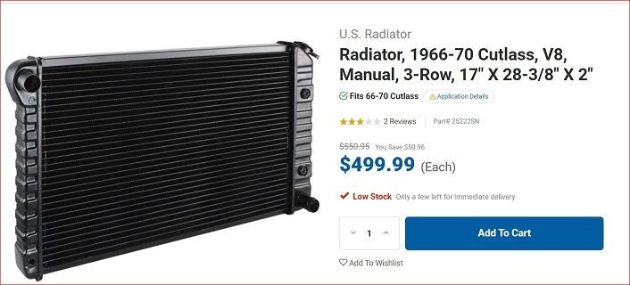

You're asking a valid question and honestly, it depends on the design of the radiator.
This radiator has one "core". It's not a two core or a four core radiator. The core is the assembly which comprises the fins and the tubes located between the headers. Automotive parts supply houses don't even get this term correct - instead, advertising a two core versus a four core, etc. There are two core, three core, four core radiators on the market, but I've never seen anything other than a single (one) core radiator in a street automobile. You'll find some very fine two core, three core and four core radiators in a locomotive, a Caterpillar tractor, a power plant generator, etc. The term "core" apparently and incorrectly has replaced the term "tube". If any term is closer to replacing the term core, it would be the term "row". Yet, even the term row could be incorrect since you could and can in fact, have a radiator made of many rows which have more or fewer tubes than rows - depending on the "design" of the radiator. So, much like a drive shaft has replaced the name propeller shaft & the term proportioning valve has replaced the term combination valve, this radiator has one "core". The design of its core could contain many rows, which may or may not be the same as the number of tubes contained w/in the radiator depending on its core "design".
The efficiency of a radiator to dissipate (transfer) heat is the number of fins:tubes (fin-to-tube) contact points contained w/in the core. Copper is actually a better "metal" to transfer heat than aluminum ever will be based upon specific heat capacity of each substance. One only needs to examine the delta in specific heat capacity of Cu versus Al to know Cu is a better material to transfer heat than Al. In simple terms - it requires more heat to change the temperature of Al than Cu; or, more simply Cu loses heat faster than Al & Al retains its heat longer than Cu. Therefore, it takes less heat to either raise or lower the temperature of Cu than Al. When anyone refers to an Aluminum core versus a Copper core, it depends on the core design because if two radiators were built and deigned identically (one Cu the other Al), Cu will always be a better performer for transferring heat.
Place an empty iron (Fe) pan, an aluminum (Al) pan & a copper (Cu) pan (all of the exact same size and mass) onto a stove until each metal pan reaches the exact same temperature. Fe will hold its heat the longest (takes longer to lose heat), Al will hold its heat longer than Cu and Cu will lose its heat more rapidly than either Fe or Al. Copper (Cu) is a better metal to transfer heat than aluminum (Al) - end of story.
Look at it this way. Water (pure H20) has the highest specific heat capacity of any common substance on this planet. It takes more heat (energy) to heat water than any other common substance on this planet. The specific heat of water = 1.00
Water will take longer to lose its heat than any other common substance on this planet. From my table below, which will take longer to lose its heat - Cu or Al? Cu, will always win.
In terms of a radiator....hopefully you get the point.

I measured the core thickness of the radiator in the car, and it's 2 inches thick. Just a reminder, it's a 3 row copper/brass. I also measured the thickness of the CU351...1 7/8". Also, I was wrong about the 351 being a 2 row...it's actually a 3 row...also copper/brass. So, knowing that it's pretty much the same thickness and that it's a 3 row, it should work, right?
It depends. Count the number or tubes in each row, and measure the number of cooling fins-per-inch. Some aftermarket radiators have fewer number of tubes per row and fewer fin-per-inch count, which means lower cooling capacity. Folks here have had worse overheating issues with an aftermarket 3 row radiator than they did with the factory 2 row radiator due to those differences.
Old Jan 11, 2021 | 12:41 PM
What will be more of an issue for you is the size of the inlet and outlet ports. This is why I just re-cored my old radiator. But yeah, time to make a decision and try it out. For the amount of driving you'll do I'd go with the 3 row copper/brass and be done. That's what your car should have come with from the factory since it had AC.
Hoses fit good...I just happened to have a spare upper and lower in my garage so I "test fitted" them before I closed the sale,😀
