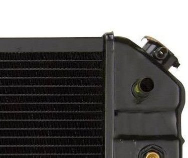

The time has come to finally replace the radiator in my '72 Supreme. I'm going with an aftermarket sourced from a local parts store. It's the Spectra Premium, and it has an extra nipple on the upper right of the passenger side tank.
Spectra Premium provides a cap and a clamp to cover this, but that seems sketchy to me. I'm thinking I could route the drain hose from the reservoir to this port and that would send the coolant back into the radiator instead of just dumping it on the ground.
Will that work?
Old Jan 3, 2021 | 08:33 AM
Posts: 15,409
No, that port will be pressurized and push coolant out of the radiator and into the reservoir.
The reservoir tank must be connected to the port at the filler neck so that the valve within the cap controls the flow of coolant to and from the reservoir.
You can have a local radiator shop remove that hose nipple and install a permanent plug in its place.
Duh... didn't think about that. Guess I'll just cap it and call it good.

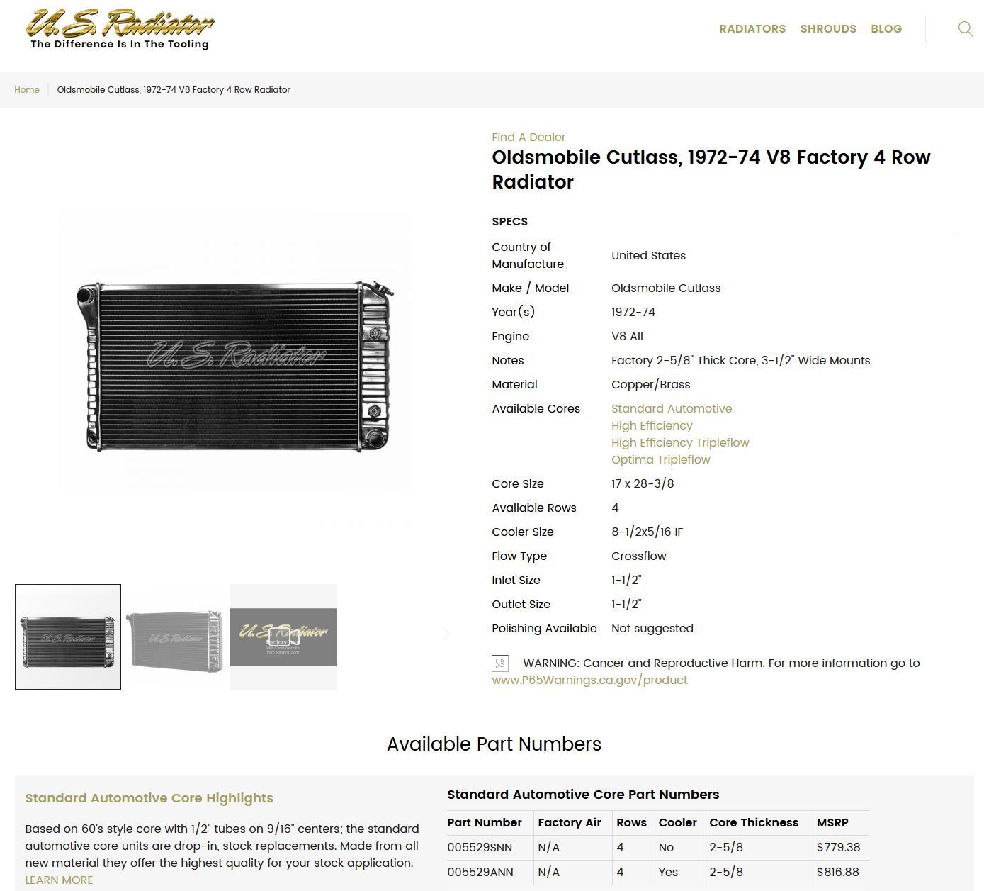

I looked up a radiator at U.S. Radiator for a '72 Cutlass, and they have them, but the prices are heart-stopping. Pushing $1000.
At the other end of the spectrum, Autozone has a Duralast brand radiator for just over $100. I don't know if Duralast makes their radiators (I doubt it) or just re-labels another manufacturer's product.
I'm sure the U.S Radiator product is a closer match to original, but I'd have to think long and hard before spending $780 versus $120.

Cold-Case has radiators for a price in the middle, about $400.
Spectra Premium is a good brand. I would have no qualms about installing one of their radiators. They're one of the largest aftermarket radiator/gas tank/etc. manufacturers in existence. But they don't sell direct. You can see their products at their website, but you can buy them only through a retailer (local store, Amazon, Rockauto, etc.).

It'll involve more parts changing, but here's the simple and elegant solution.
Get a 74-77 water pump which does not have the heater hose nipple and route the heater return hose back to the new radiator's nipple as the factory did those years. Alternately remove the w/p nipple from yours and replace it with a freeze plug or threaded plug, whichever your water pump has.
The radiator nipple resulted from customer complaints about heater gurgle and moan on the 71-73 B&C cars. There was a factory fix that is almost Goldberg-ish in design but the permanent fix starting 1974 was to route heater return hose back to the radiator cold side tank instead of the water pump.
That is why new one-size-fits-all radiators have the nipple.
Or you could get a tee and plumb it in to the existing heater return hose. One port to water pump, the other to the radiator. Accomplishes the same thing, just looks a little mickey-mouse. I ran a 76 Custom Cruiser like that for years.

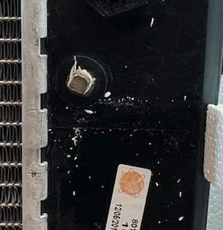

So it looks like there's another plug on the tank...any ideas on what it's for?
Old Jan 4, 2021 | 11:51 AM
  #34
Posts: 6,105
Way back when I was more “macho” and felt my car didn’t need heat or A/C, I removed the heater hose fitting from the water pump and installed a freeze plug, and then covered the freeze plug with JB Weld. If it can be fixed with JB Weld, it ain’t broke!!
Can you reach the heater hose fitting inside the tank? If so, remove the radiator. Throughly clean and dry the tank, cover the hole (inside the tank) with duct tape. Mix up enough JB Weld to fill the heater hose fitting. Once dry, remove the tape. Install the cap over the heater hose Nile, reinstall the radiator, consider it fixed.

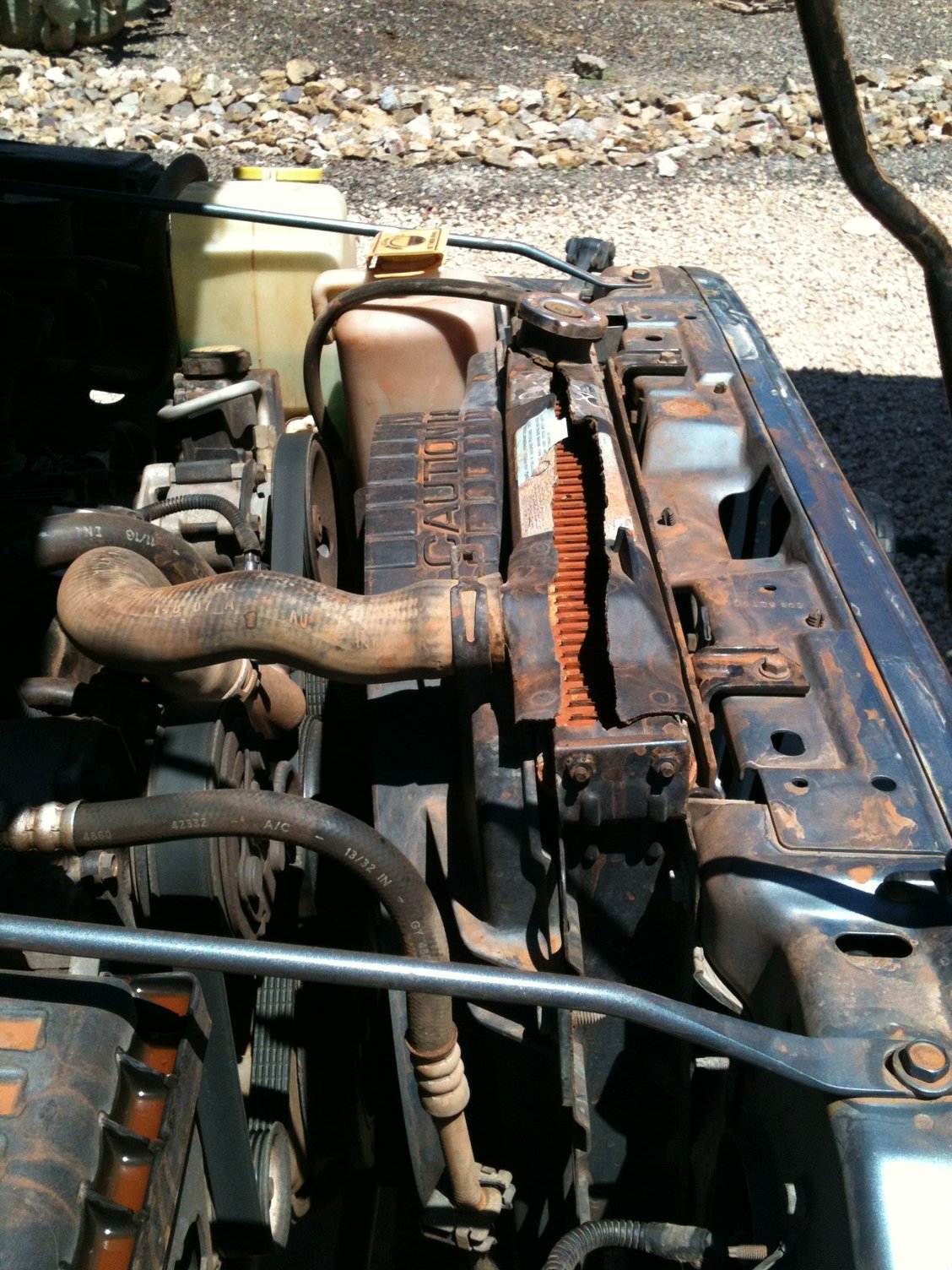

Be aware that plastic end tanks are, well plastic, and can rupture after they get old or if they have a defect.
This was the original 14 year old radiator on my Jeep Wrangler - blew apart while the wife was coming home on I-10.

Old Jan 4, 2021 | 01:06 PM
  #38
