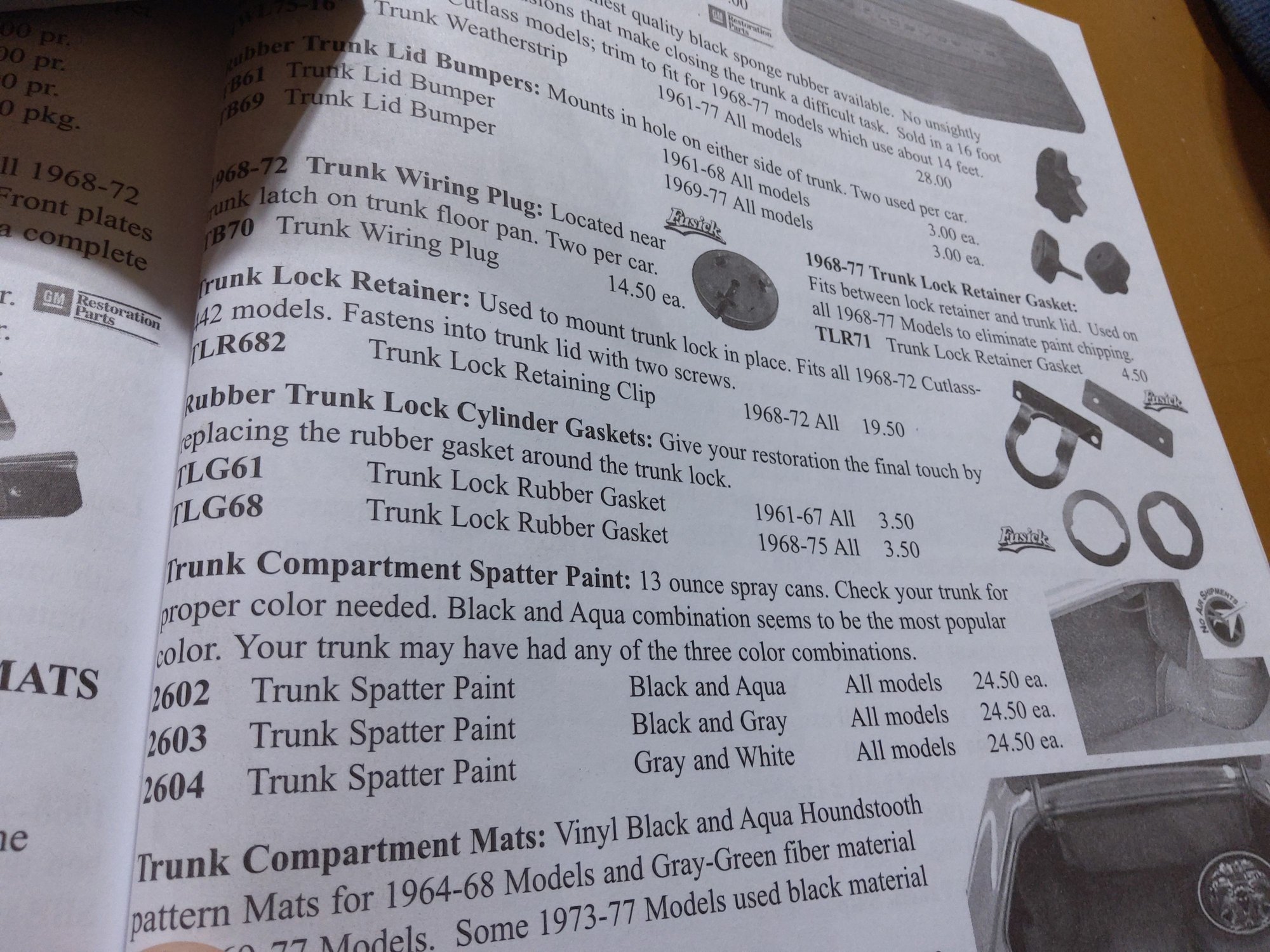

When you order parts from a supplier make sure that you are communicating with someone that know what they are talking about. After going back and forth with Fusick, I was still sent the wrong part.
Here you can see the 2 gaskets. The correct 1 should have been the top TLG61 for the 442. TLG68 is for use with SE69T.
Here you see the SE69T that would use the TLG68.
Here you can see the gasket that was sent because the Fusick employee felt that he knew better. The actual part SE69T. I just figured that while the cost wasn't much at $3.50 and the rest of my order was correct, I will source the correct gasket somewhere else.
Great catalog, just make sure that you are dealing with a knowledgeable person.
