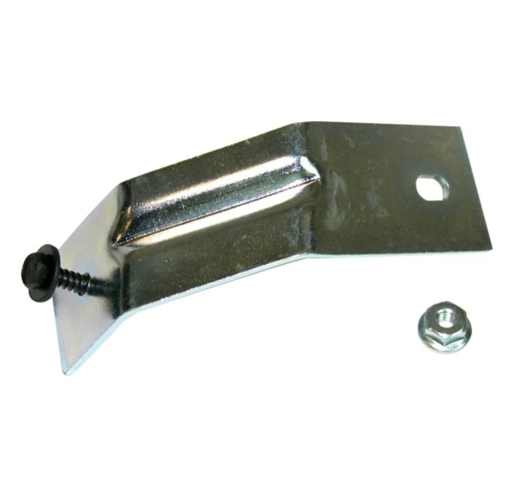

Originally Posted by scrappie
If that plastic strap isn’t there out will be a big PIA attaching the one end to the center dash vent up top.
is this the strap?

You can probably get away without it if you have the other support/ground strap.
I have this
Is this the long skinny thing I circled in my original pic?
And do I need this to make the light work (radio won’t be used) and does this add any support to the radio?
Old Sep 1, 2022 | 10:53 AM
scrappie's Avatar
Posts: 3,446
From: eastern MA
There you go
Old Sep 1, 2022 | 10:54 AM
72442455's Avatar
Joe Ralph
Joined: May 2017
Posts: 685
From: Lansing, Michigan
There you go
ok - ordering the plastic strap and the ground strap then - thanks

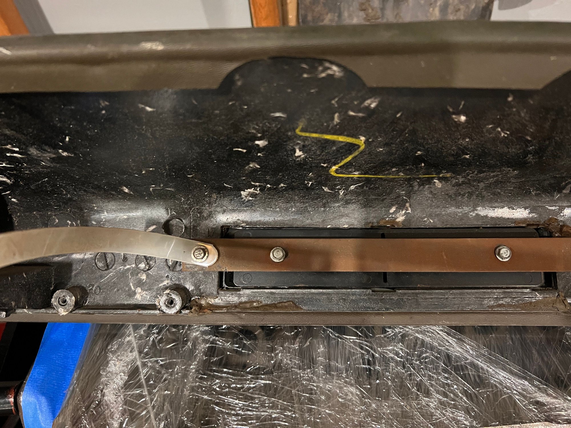

Old Sep 3, 2022 | 07:54 PM
BSiegPaint's Avatar
Joined: Nov 2017
Posts: 1,527
From: North Royalton, OH
Originally Posted by 72442455
thanks - attach it from the same bolt the lower bracket goes to and up to the center of the a/c vents? (Read that in another post here)
From the back view of the dash, here’s where that strap attaches
Old Sep 6, 2022 | 05:05 PM
72442455's Avatar
Joe Ralph
Joined: May 2017
Posts: 685
weird - it looks like a solid metal bar in the picture - which is what I thought it was in the line drawing of csm …
Old Sep 6, 2022 | 05:07 PM
72442455's Avatar
Joe Ralph
Joined: May 2017
Posts: 685
thanks tons for the picture - I get it now! Took me a bit looking at it to see what I was looking at - that helps tons!
