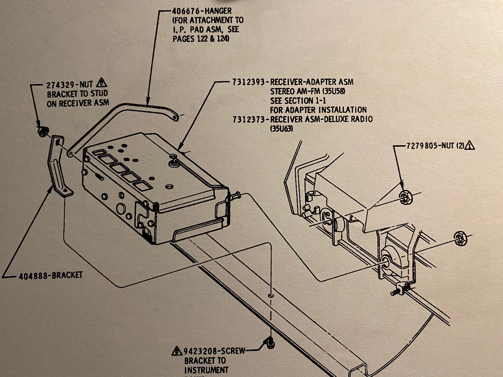

Guys -
Just bought a AM radio for a 72 Cutlass on Ebay. The assembly manual is a bit difficult to follow. Does anyone have a picture of the radio installed with the radio support bracket and hanging strap? Or has anyone installed a different way?

This is pretty clear for the metal bracket under the radio. The plastic strap attaches to the stud on the side of the center AC vent (or the vent filler plate if no AC). For sure that isn’t very clear in the manual.
Old May 20, 2021 | 08:02 PM
The rear support lines up with the "channel" on the underside of the dash. There are holes already.
